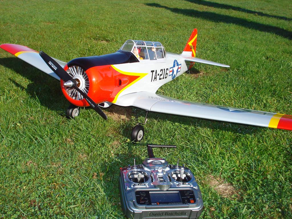

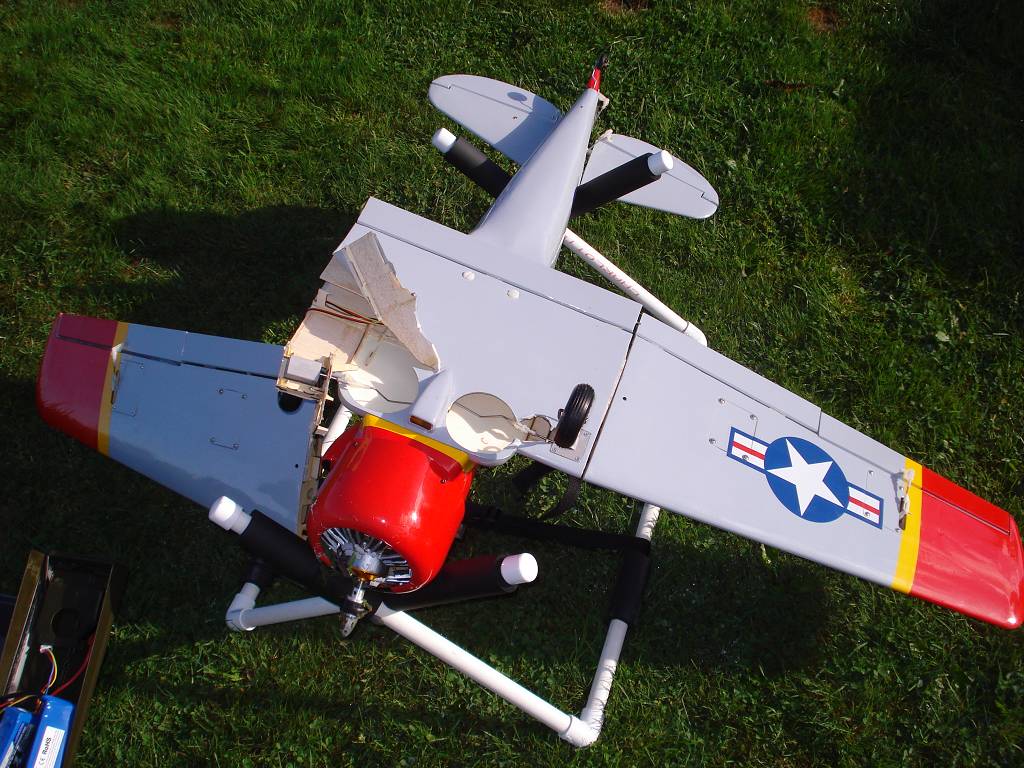

I have two flights on my Texan, well actually one, the first could not be considered a flight. The CG in the plane is critical and is measured from the front of the wheel wells and NOT the front of the wing leading edge. Even with two 2200 mah batteries against the firewall, I still needed to add weight to the nose. She flies like a warbird - sensitive to elevator and aileron even with low throws. My only complaint is that the center section of the wing assy is made with paper thin balsa. hard landings that would not bother most planes will tear up the gear and surrounding balsa. It is a great looking plane and once you get the CG right, flies well.
The first photo was before the first flight(?). The second, a few seconds later. She did clean up well and went back to the field looking almost new.

i can tell you i had no luck at all with mine even the wing didnt line up with the saddle in went in and from there it was terrible i took my time about 4 months december to april.there is one thing i want you to know i see grass in the picture when ever you get a plane and you fly off grass put some extra balsa and epoxy in there to make it strionger you will save a lot of rePAIR on anything from foam to wood trust me so much trust me we get planes now and before we go out we put in all the repairs needed before it falls apart like yours.my texan was double walled for support and all else failed but not that part it came off in chucks.one other thing grass is nothing but a killer on retracts.
