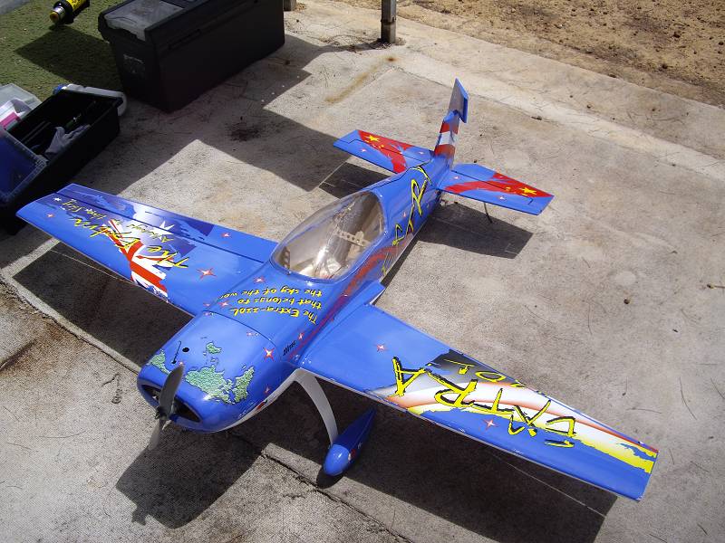

I finally got to Maiden my Extra 330L and it was great with the C of G at 80mm it was spot on!!! But i had a crash as i lost power from the engine!!! It was a 34 Deg (C) day and the motor cooked I made a mod to get more air into the cowl by cutting out the bottom..

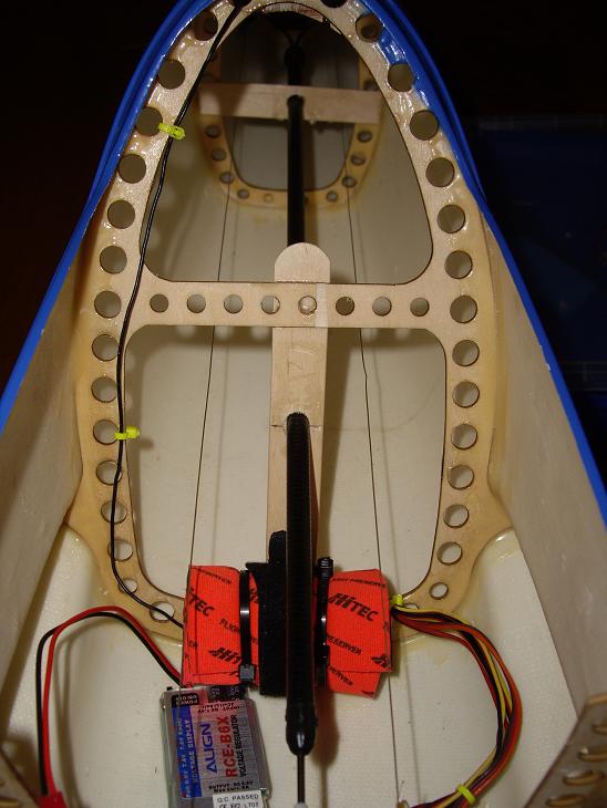

I also added guides for the elevator rod as i was shown how the elevator can act as alirons at high speed..

Pezzer, I think that I know what you are talking about. The elevator push and pull rod, right? So this rod should be light and rigid enough to get the elevator halves to center easilly. The weight of it, if it was really heavy, would cause the elevetor to go down I suppose (like you said). Maybe check to see if you are centering well by ensuring that the rods that go through the fuselage are not touching the fiberglass body at any time. Check for binding in your elevator hinges too... use LOW rates or a considerable amount of exponentials.

No i fixed that with tounge depressors, I was talking about the plastic tip that is glued on the end of the carbon fiber push rod had been pulled out!!!!
I have added a pic to show what i did.
PEZ
