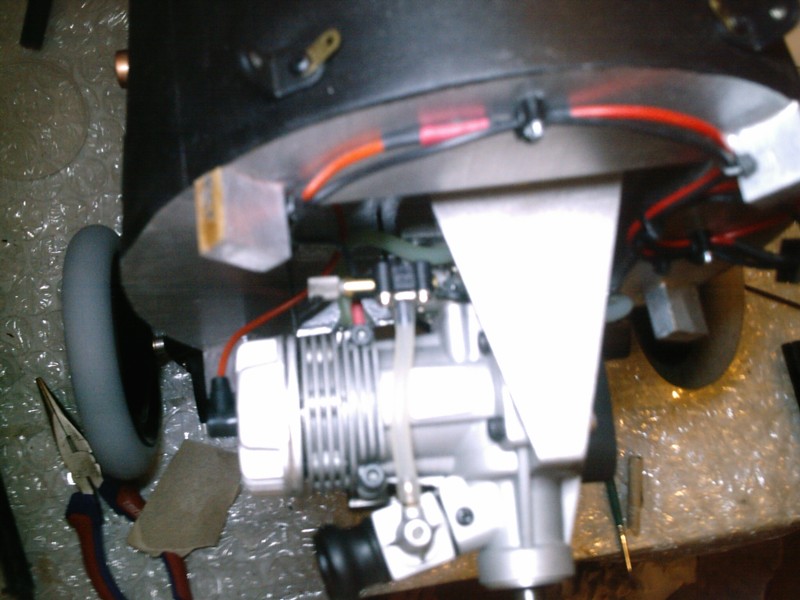

Whats the trick to make this work?
I have 2 of these from Dubro and cannot make them work.
I already did a big hole in my Ryan , adapted it, put the red covered wire to the spark plug and the other bolted to the motor screw and nothing!!!
Is there a special trick to it?
do I need to cut thte lenght of the wire or something?

Oh yea, there's a trick to it.....
Cut a very small piece of fuel tubing...1/8 or 1/16 and put it over your glow plug, then put the wire on.
when you put the igniter it shows green, right?
Everything looks like it should light, but it won't, right?
The hot wire is grounding out against the plug.
Try the tubing idea and then be sure to come back and tell me that it worked, OK?

Thanks alot guys, I put the hose over the plug, tightened the wire to the plug and the other wire to the engine bolt and the motor started first try using the remote!!!

Also try using a small wheel collar instead of the clip that comes with the igniter. Just file a small flat spot on the collar and solder the positive lead to it, the set screw holds it on the plug. The small piece of fuel tubing is a good idea for this setup also.

I use this for all my planes and haven't yet had a problem with them. They are better than Dubro's version IMHO.
http://www.horizonhobby.com/Products...ProdID=HAN3025
You might have to widen the ground soder plug or replace it with a larger one. The stock soder plug seems to be a bit small. I just pull the wire as you slide the boot on the glow plug, and take the ground soder plug and slide the allen exhaust bolt through it and tighten it down. Your using the engine as a ground, so you want it close to the glow plug. Making the amp travel at its minimum.
Pete

No, soder plugs is in the first photo. You use that for your ground. The Allen bolts is used for 2-strokes to attatch the exhaust. If you're using a 4-stroke just find a place close to the glow plug on your engine to bolt it down. It will be the same concept, just a different type of motor. I took these pictures just for you. Study them, it will explain everything.
The boot that pops on your glow plug can be removed or trimmed if need be to fit any engine. I trust a spring loaded clamp system for the glow plug, before I trust something I have to pinch on. JMHO
