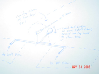

Default Counter balance
If I can do it without damage to elevator halfs already installed - I thought about attaching (mig weld??) piano wire to elevator bar extended forward of hing line into tail cavity with a lead wieght attached. Lead bell fishing sinker epoxed to piano wire.
May have to do it later - need to get this one ready.

Old 06-01-2003 | 03:52 AM
  #53
AndyF's Avatar
Posts: 778
From: Fort Wayne, IN
Default Hanger 9 new Skylane
Oooo! I like that idea! I guess you could do the same thing with the rudder?
I will have to consider it.
Thanks!
Andy
Old 06-01-2003 | 04:02 AM
  #54
Posts: 205
From: OR
Default Re: Counter balance
Or a couple wheel colars might hold the wire in place.
Old 06-01-2003 | 04:17 AM
  #55
AndyF's Avatar
Posts: 778
Soldering the wire would probably be better. Less heat then Mig welding.

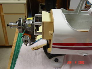

Old 06-05-2003 | 03:20 AM
  #60
My Feedback: (48)
Joined: May 2002
Posts: 718
From: Alma, AR
Default G38 engine mount
Had to shorten engine box. Reinstalled original firewall and added widened 3/8 ply to front. Balance as shown is very close using ignition. Making gussets. Will probally install servos for choke and throttle at firewall since balance does not appear to be a problem.

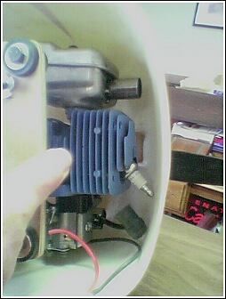

Old 06-05-2003 | 01:44 PM
  #61
Posts: 3,126
From: Belton , MO
Default Exellent work!
What a nice job. the box looks origional. How much clearance is their between the cowl and the flywheel?
what prop will you use?
Pretty sure that the fuji 50 electric start will fit. Ill know more today.
I just checked and the fuji 50 will fit completely inside with the starter and the stock muffler !!! except a small fraction of the plug wire. It will go with the wire unpluged...???????
I wonder if anyone has a shorter plug for this motor. I have it mounted on a vibration isolation mount from great planes. The entire mounting box needs to be removed.
Dennis

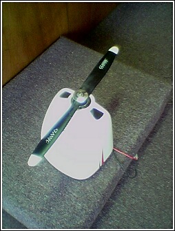

Old 06-05-2003 | 04:10 PM
  #62
Posts: 3,126
From: Belton , MO
Hereis another picture with the juji.
Also it will be interesting to see how some of these different engine installations come in in weight and balance.
Dennis

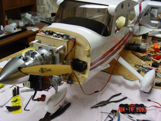

Old 06-14-2003 | 04:03 AM
  #69
My Feedback: (48)
Joined: May 2002
Posts: 718
From: Alma, AR
Default Work Shut Down
Had to leave town and get some bidding done but hope to have plane ready for test flight Sunday . Got to work Sat. This work thing is really starting to interfere with my hobby.
Will try and post some more pic's tomorrow night.
Tested on board starter tonight - really neat
