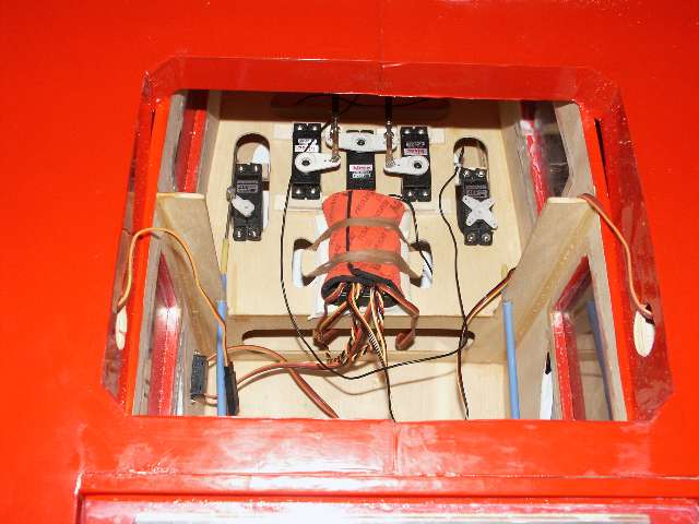

I have mine set up with 2 Hitec digital 625's on the alerions, 2 elevator servos (605's), with CF pushrods, rudder set up with pull pull (605), on throttle and smoke valve JR 537's.
I originally had a ST3250 in the front end, but found it was WAY over powered!
But it had some problems so I took it out and put in an MDS 148, changed the landing gear out in favor of T6 aluminum one and foam tires. That droped the weight down to 13 LBS, includung the smoke system!
here is a pic of the servo set up:
