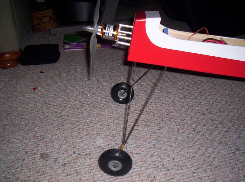

I decided I wanted to go electric instead. I have the plane all ready to fly, hopefully I can maiden it this Friday.
I went with this motor:
http://www.hobbycity.com/hobbycity/s...idProduct=3887
With a 45 amp ESC. I have a 3S 2150mAh LiPo in it, with a 10x5 prop, and it pulls like crazy. I cannot wait to try it out.
My all up weight came out at about 3.24 pounds.
I'll report back once I know how this setup flies.
Here's a couple of shots of the power system. The battery I stuck in for the photo is smaller than the one I plan on flying. I tested it this afternoon, and I got about 6 minutes at half throttle with the 2150 3S pack. I know that if I want to fly aggressively, I will need a larger pack.
I had to mount the motor 1.25" off the firewall to get it to balance. If I go to the larger battery, I just need to remove a spacer.
I also put on bigger tires to help it balance. The stock tires are very lightweight.
I guess I have plenty of prop clearance.
Still planning on a maiden this Friday....

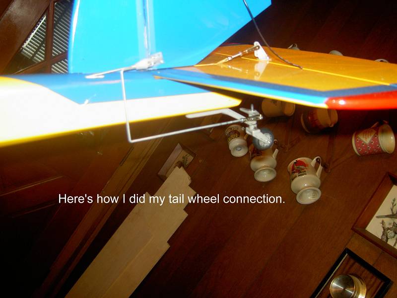

I've been scratching my head trying to figure out a good way to replace that tail skid on a new version 2 arf build, any thoughts on a tail wheel mod? Anyone?
Joined: Aug 2005
Posts: 154
From: Dale,
TX
FlyFanatic,
I put a tail wheel on my Magic (after it was assembled and flown a few times). I put a hole in the fuse at the bottom and ran the wheel
wire straight up at the point where it should normally fit into the rudder in a normal configuration. I then bent the wire 90 deg to the rear to position it like it would go into the rudder. I trimmed out a channel on the rudder the size of the wire (not completely thru the rudder but just enough to fit the wire. I then fit the wire in the rudder, put some expoxy to fill the channel and let it dry. I then got two control horn bases and put one on each side of the rudder (screwed to each other) to hold it firm. Finally, I mounted the plastic wheel mount to the fuse with screws. Be sure to put a little thin CA into each hole to toughen them. Doing this takes a little patients due to the fact the rudder is always in the way but the tail wheel wire will bend enough to let you get it done. I probably have over 50-60 flights on the Magic since I installed the tail wheel and have had no problems.
Sonnytex

Great info from you both, today I will be deciding which to do today... thanks! Any chance of a picture sonnytex?

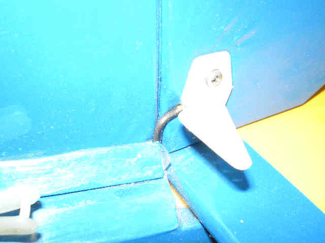

balsabuster2003, did you use only one metal pushrod for the rudder? I'm debating on the the pull-pull for both ele/rud or one metal rod each.
Joined: Aug 2005
Posts: 154
From: Dale,
TX
FlyFanatic,
I would stick with the pull-pull system - by the way the new version, V2, uses a cable pull-pull rather than the original steel pushrods. I am just now getting ready to go to the flying field
. I will send you a picture this evening.
Sonnytex
. I will send you a picture this evening.Sonnytex

It does appear to be off slightly - I made this modification in the field after spending several hours trying to steer the plane in a 20mph wind. You can do a better job I'm sure. It makes a world of difference in how the plane handles on the ground. It has served me well for some time now.
Just so you don't think I wasted your time waiting for the pictures, I maidened my new "Somethin' Extra" today and it is as much, if not more, fun as my Magic
Let me know how the mod goes - send me a pix if you can.
Sonnytex[sm=thumbs_up.gif]
