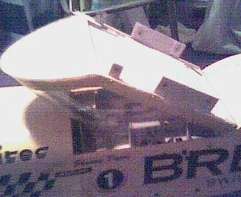

I was flying my Lanier Cap 232 80" and the canopy came off in mid flight. Has anyone else had the same problem? Any suggestions?

What did you use for attachment ?
Did you use R/C - 56 and !/4" trim tape ?

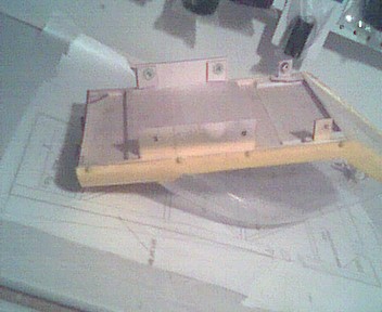

I had the same problem with mine. I had to purchase another one from Lanier and this time I used 3/16 ply and 3 bolts per side to attach the canopy. I also used some sylicone under the canopy plastic and used small screws to attach it to the frame so no air could get under the plastic. If you use a pilot figure, make sure you put some 1/32 or 1/16 inch ply under the pilot area.

aftcg:
Sorry for my reply, I thought the canopy came off; but the way it
sounds it was the entire hatch that came loose.

Here goes the photo try.

Here is a better one.
