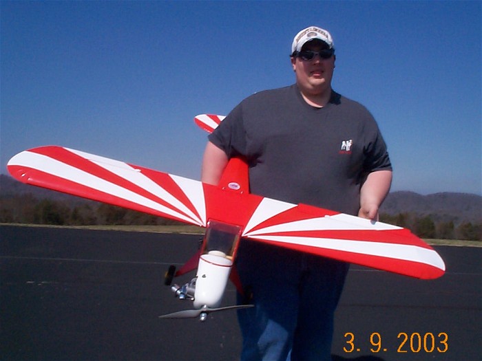

You also have to watch out for the strut attachment. The instructions for the plane are kinda a fuzzy in places. Otherwise, it's a joy to build.
The boy (pictured) has a Saito 72 four stroke in his. Unlimited vertical, very aerobatic!
I've got another on like it that I'm putting together, except it's the blue one. Maybe I'll put the same engine on it!

Yep, the boy's plane flies very well without them. Flat spins..... no problem!
With the 72 in the nose, we had to move the battery pack behind the CG in order to get the plane to balance.
The plane has a 1450 mha JR battery pack, Saito 72 four stroke, 5 Futaba 3003 servos. The rest is what the plane comes with.......
