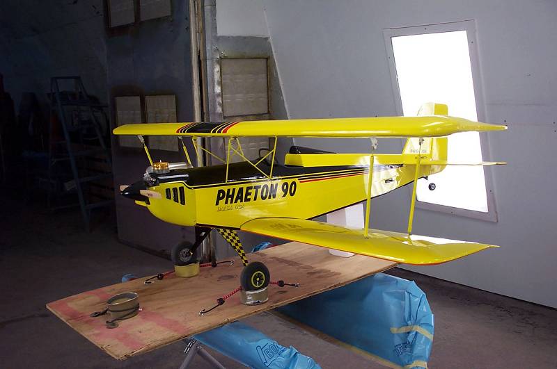

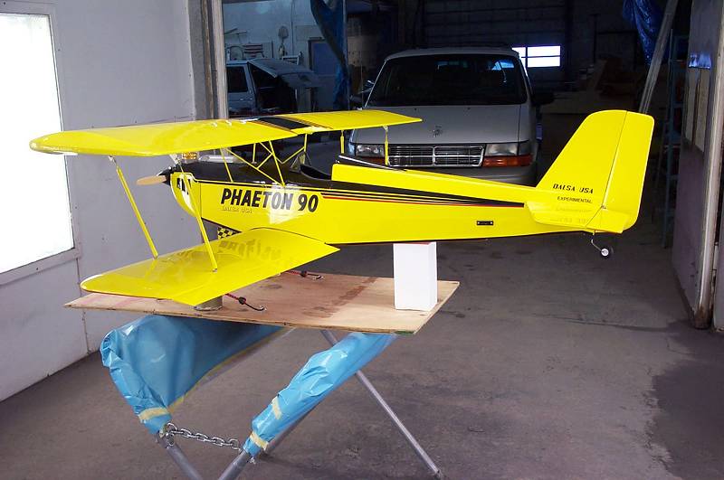

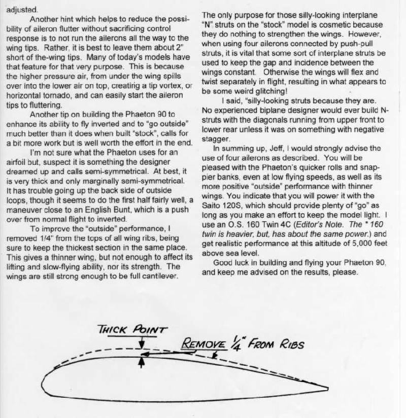

http://www.rcuniverse.com/forum/m_10...tm.htm#1004061
http://www.rcuniverse.com/forum/m_4005379/tm.htm
http://www.rcuniverse.com/forum/m_10...tm.htm#1090783
http://www.rcuniverse.com/forum/m_66...tm.htm#8288409
http://www.rcuniverse.com/forum/m_4685677/tm.htm
http://www.rcuniverse.com/forum/m_46...tm.htm#4685677
