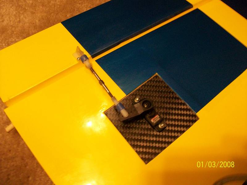

Hey guys wanted to post some photos of my extra. I did a lot of modifications to keep the weight down. Flew it a few times but unfortuanately the wing bolt came out on left wing. and caused crash . but only damage was broken firewall and busted up cowl . just waiting on gp for new cowl. there on back order now.

Here are some pics of the carbon work and the extra effort to lighten the plane. THe carbon gear is from 3dhobby shops 55" extra shp. Perfect match

Sweet! Where did you get the CF sheets from? How thick?
