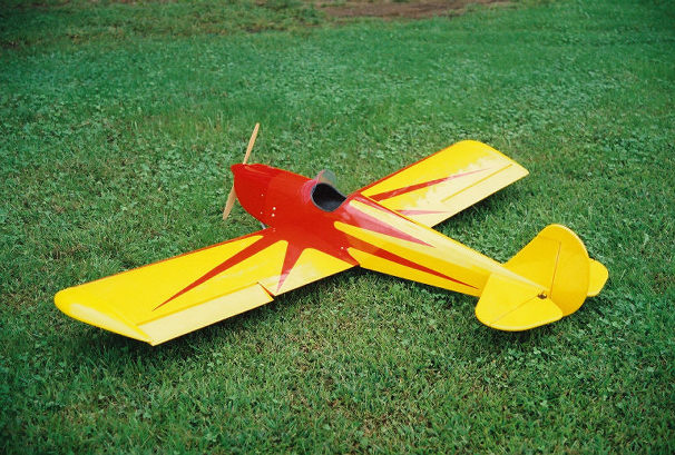

Yup I love mine too, It is a great lazy sunday flyer. Probably my most relaxing plane. Love doing hammerheads, and those big loopy rolls, slowing it down and getting those super tight loops, and slow low passes are great. It is a plane I truely love, but it is not the end all be all for me. Sometimes it is just too boring, and it really is not all that great in windy conditions, not as boring anyway. I hated the amount of lead I had to put in it, I may still put a 120FS in it. All that said here is how mine is set up:
OS91FX w/ Bisson Pitts for 91FX
Futaba ball bearing servos all around
Hanger 9 gold aluminum servo arms
Dual Elevator servos Ran 4-40 rods through the formers
(should have seen me and the wife wrestling the fuse)
Pull-Pull Kevlar on the rudder
Upgraded Aileron Hardware 4-40
Oversized tires no wheel pants (with that fat wing maybe I should put them back on LOL)
Sealed all the control surfaces.
ah and my best mod:
A stuffed Rocky pilot velcroed in, still can't knock him out on outside loops he he
(As in Rocky and Bullwinkle, the flying squirrel... I need pilots that can fly without planes...)
Oh and I like that it is 1/4 scale, flys bigger than it is, but I can fit it in the bed of my pick-up truck fully assembled.
I have flow other peoples Sigs, and they fly great too. Next time around I will probably go with the big 1/3 scale Sig, and gas. If you think the GP is scale like in flight, it only gets better when it is bigger JMHO...

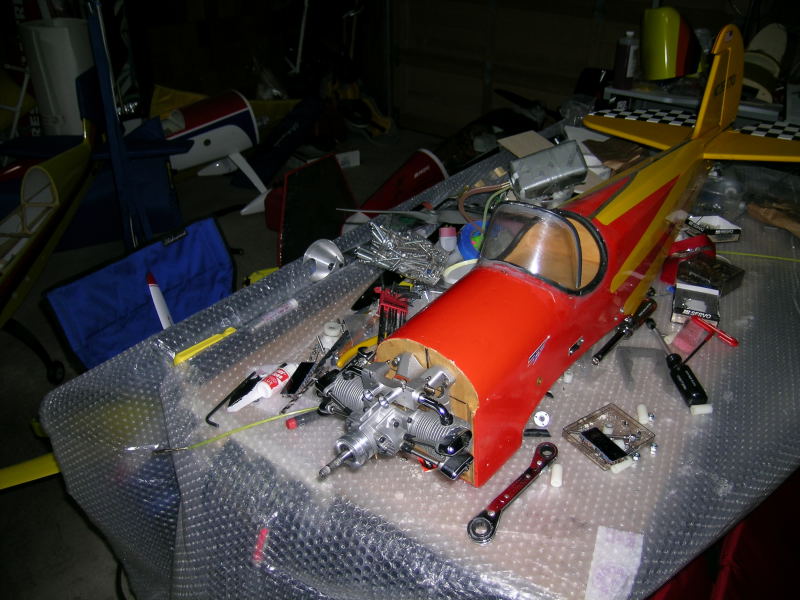

I just upgraded my spacewalker to a saito 182 twin because mee to liked the heads comming out on the side of the cowl. he should be ready to fly by next week.
here are some pic of it with out the cowl....
sorry for the mess... but winter has arrived up here in NW

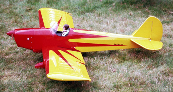

Here is a picture of my beauty.......
I extended the landing gear making it 2" taller and moving it 1" forward. Also, check out my custom cowl. This plane is great!
To compare thrust measurements… I have a ¼ scale Spacewalker that weighs 10pounds 1oz on a commercial scale. With a O.S. 91fx (15% cool power) turning a APC 15 x 6 at (10,600 max) 10,300 it can hold a hover but can only very very slowly pull out vertical. I then switched to an Ultrathrust muffler with 15 x 6 APC and it went to (11,700 max) 11,200 flying (I do a lot of verticals and hovering, so I like to keep things rich) and now the plane pulls out of a hover very nicely.

Great looking twin engine!
Does the cowling fit over it? Any pictures of it?

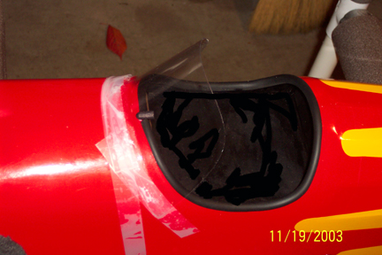

Hey guys!
Well, My new SpaceWalker is almost done!
Here are some finishing pictures .
The one thing thats a little tricky with this plane is the
canopy gluing. There is also a picture of my scaled
out instrument panel! And look at all that room in
the fuse! I love this plane.! I'm adding the lights,
wing caps, ect.
So I still don't have a complete picture.
I should have it done in a couple of days!
