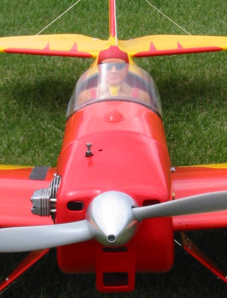

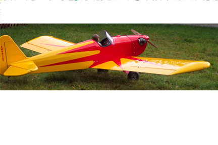

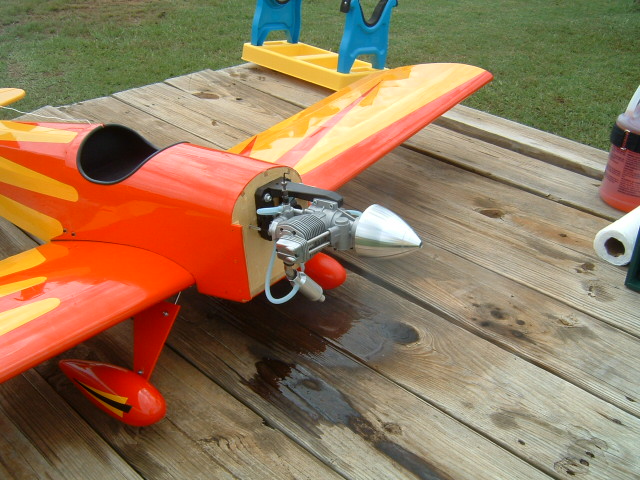

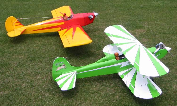

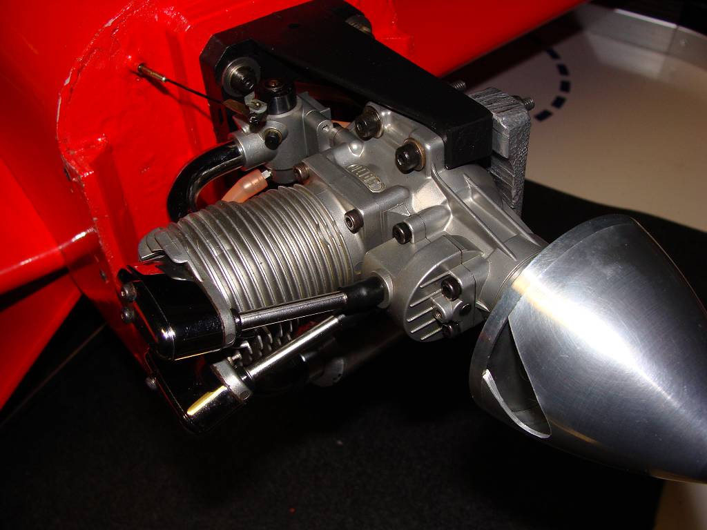

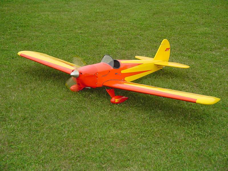

Default OK, for an arf
The GP Space Walker / Surpass .91 combo is my "everyday" airplane. It's been up for 1/2 hour-plus once or twice. Moving the servos forward deleted the need for nose ballast. Wing bolt plastic anchors shattered quickly, new ones are oak. Mine wasn't right stock, too much wing pos. incidence. Lowering the leading edge about 3/16" fixed it. Added Sullivan tailwheel unit, Magnum aluminum spinner with APC 14x8. It's been flying about 3 seasons now, going strong. It's gotten tail bracing wires, and the pilot got a custom painted Space Walker helmet.
We fly at 6300 feet elevation and a big wing like on the SW helps a lot. Keeps landing speed down.
One of these days I'll replace the dumb-looking plastic wingtips with balsa and brace the elevator pushrods.
I've been thinking of building a tapered, symmetrical replacement wing for hotter performance. Also, been kicking around the idea of a Space Walker Biplane...
Was doing inverted figure 8 passes one day and after a few, heard a guy tell another, "He's still inverted." That was fun
Went for an outside loop once on low rates [X(] we cleared the ground inverted by about a foot <WHEW>
It's really great on skis, touch-n-go on snow!
Sometimes the Space Walker feels "just right", other times I want to get rowdy. That's what the Hog-Bipe's for!

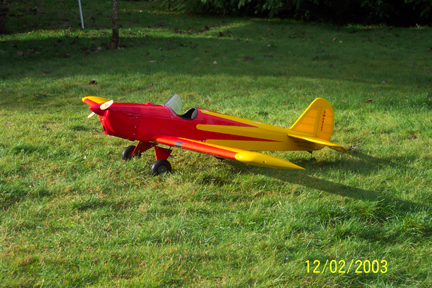

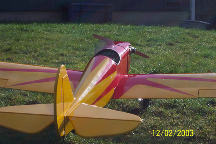

OK EVERYONE,
Here is the post that we have been waiting for, Well,,, at least me.
Here are some pictures of MY Finished 2nd SpaceWalker.
Don't be too disappointed, the lighting isn't that great.
I also flew the bird and flies great this plane especially flies better than my first one because it's lighter and it has flaperons!
I have 6 pics. The first two are what I call buying pictures because
the have everything you would want to see as a buyer, the third is a back view picture and the other two reveal some of it's
scale potential. Hope you guys enjoy. P.S. If your new to this thread go buy
a SpaceWalker ARF, You can't go wrong. and Tower Hobbies is selling the bird
for $219.00 not counting the $15 discount!

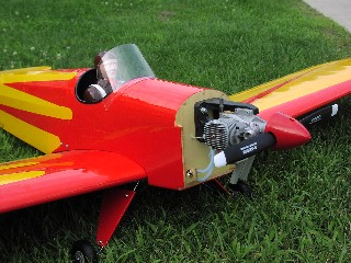

Hi Guys,
I maidened my Spacewalker today, and it flew great!
I've got it powered with and OS 61FX and 12x6 prop. The engine is not broken in yet, but has plenty of power for scale acrobatics with this plane. FWIW, I had to add about 9 oz of lead to the nose!
Here are a couple of pics w/o the cowl.
Carl
