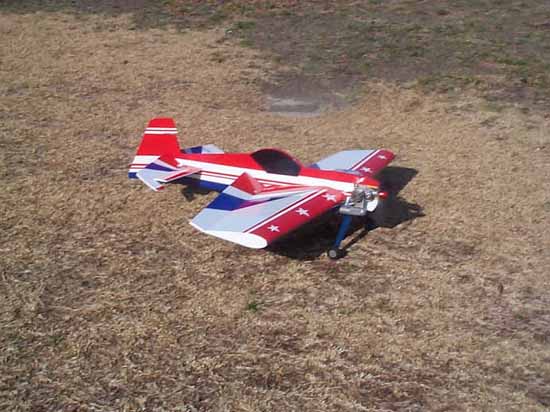

Greetings,
One word: Woooooooow!!!!!!!!! funnyest plane I ever own!!
Vertical with the 50 SX (12X4 prop with tuned pipe) is absolutely unlimited and that thing land almost in hovering. Knife edge is also very easy. Fun! fun! fun!
Serge

Doug,
My top cat has some difficulty to hold knife edge loop. Can it be servo related?? I only have a futaba 3003 for the rudder. Do i kneed more torque to hold knife edge??
Serge

Serge
I have a JR 4721 at 120 oz on the rudder,so no problem here. The 3003 at 44 oz may not be enough to hold the plane. These planes really should have the elevator and rudder surfaces on a good ball bearing servos. This plane with a aft CG is a lot of fun to fly low and slow harrier figure eights just off the deck
Doug

Serge
Doug
Thanks Doug!
I am gonna switch the rudder servo tonight.
