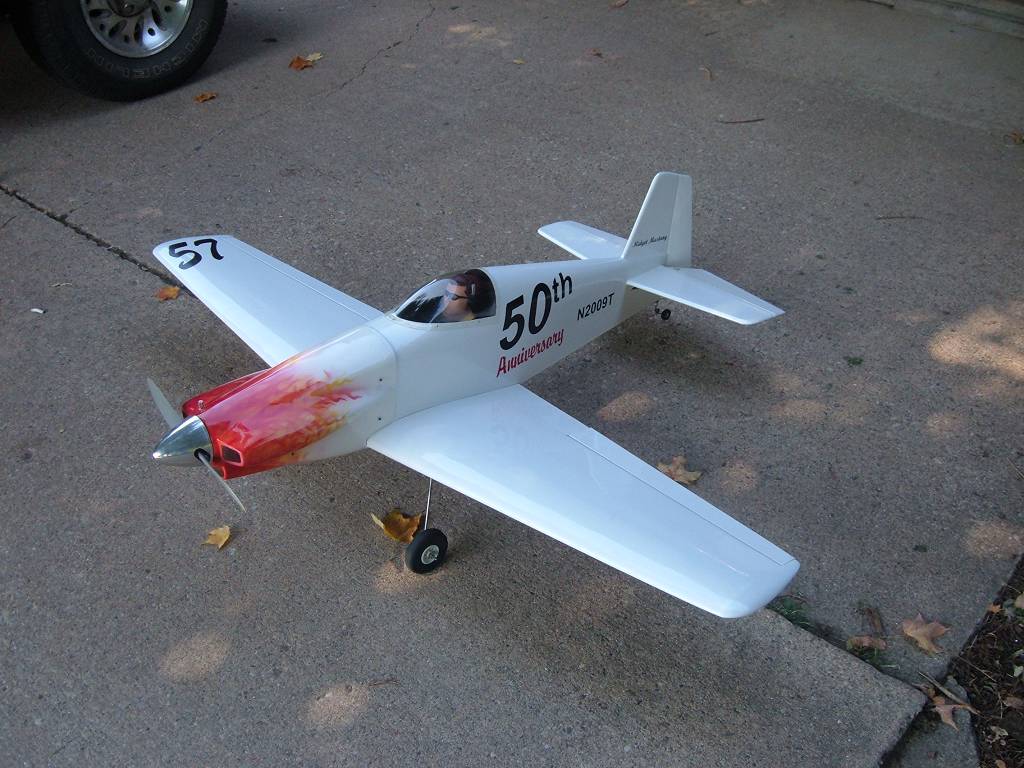

I have a 7 year-old version of this plane by World Models, best plane I have every owned!

Do the wheel pants fit well? I fly off pavement.
Old 02-25-2009 | 03:21 PM
mimoore67's Avatar
My Feedback: (51)
Joined: Apr 2003
Posts: 977
From: Brooklyn, MI
Default RE: Midget Mustang 60 ARF?
You can use wheel pants, especially if you fly of pavement. Our field is to rough for wheel pants with tires the size that come with this ARF!

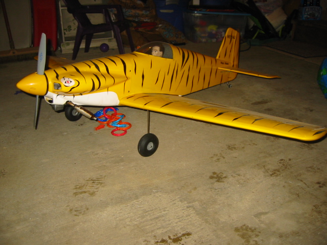

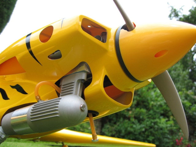

My WM Midget with ASP91 2 stroke.....just required exhaust extension to stand it off (15mm???....can't remember)
Lovely plane.....Bolly 13.5X8 on 5%....goes like a rocket.
Strengthened spats with lots of CF tows.....fly off bumpy strip..nil pbm so far.
Good Luck....if yours is like the WM version, you will be happy.
