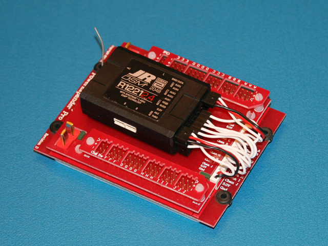

Futaba 6EX 2.4 system with a Smart Fly Power Expander. With 13 servos on board, I'm concerned that there will be a time when too much current will go through that itty bitty receiver. The expander supplies an individual connection for each servo, and the power to the servos does not go through the Rx, it comes directly from the packs. The unit impedance matches the servo wiring, so that ringing circuits don't occur. (Current ringing is why old style ignition points needed condensers, or capacitors.) There's some other nice features, too: the expander accepts two batteries, isolates them from each other and keeps them at the same voltage as they discharge. If one shorts or dies, it is taken off line by the expander. The Rx is supplied with a regulated, filtered 5V. There are two charge connections on the expander circuit board, and a switch connection. Purchasing smart fly's fail safe switch gets you two external charge jacks that connect to the expander, and a switch that uses a pin with a "remove before flight" flag to turn it OFF, so it's impossible to turn it off accidentally. The batteries will be a pair of Hydrimax 2000 NiMh.

Using all the recommended servo extensions and Y cords can cost a lot, especially if one gets the HD ones with the heavier 20g wire.

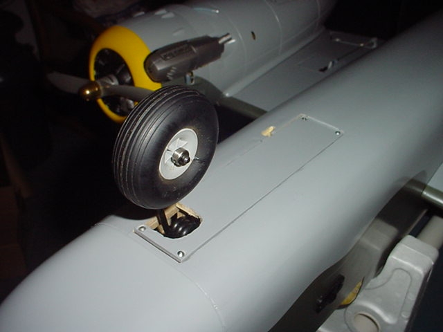

Made another decision today- I won't be using the opening and closing landing gear doors. First reason is, although they look great in the air with the gear up, they look wrong when the airplane is on the ground. It would be like a Mustang having the center doors hanging open when the engine is running, it just wouldn't look right. Second reason is, hanging down like that whenever the gear is down, they're likely to hit things and get all banged up.
I'm going to use the hinges to mount the doors, cut a hole for the wheel and strut during retract/extend, and then use some flat gray covering to tape them closed.
I will be converting my doors to the correct cycle effect this winter. Not all that hard to do. Will need 3 more servos, two minis, one for each set of main doors and one micro for the nose gear door and a little electronic sequencer module.
There is a link to someone that has already done it over in the big thread. He used a Futaba 14Z and the tx programming, though, instead of a module...
Easy to make little tabs that are sprng loaded for the tiny doors that stay open for the gear legs.

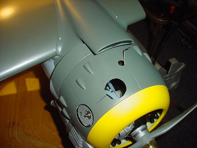

Finished all the hinging today, wing and tail feathers, and took the nacelles off the wing so I can start the engine installation tomorrow. I noticed another "short screw" problem- the forward 1/4-20 nylon bolts that hold the nacelles on are not long enough. There is barely 1/8" thread engagement in the blind nuts. The rear bolts are OK. Basic rule on bolts is thread engagement should equal the diameter of the bolt.
I think Top Flite really should have stated that this airplane is intended for four stroke engines, and that us two stroke fans will have to do some engineering. There's no way in hell the factory throttle servo mounts (either one) can be used to do a two stroke throttle linkage unless one switches to cable assemblies instead of the included pushrods, and that looks doubtful.
Here's how I did it. I traced the outline of the opening on the right side of the nacelle assembly, and cut a ply piece that can be epoxied in there. The servo is only stuck on to it with sticky tape right now- I'll make some nice mounts later. It all fits inside the nacelle nicely, and gives a short, straight pushrod.
Also, the included spinner nuts are for 5/16" prop shafts. I'll have to get a pair of 1/4" ones to fit the OS 55AXs.

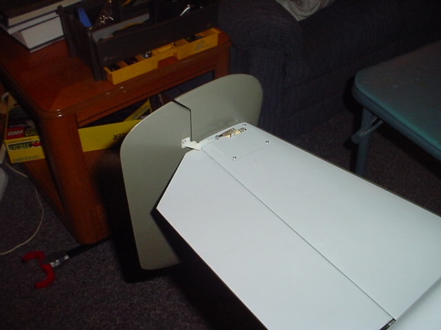

First, something that can bite. The aft fin 4-40 screw can hit the rearmost servo mount screw and break the mount off if it's not shorten to about 1/2" or less.

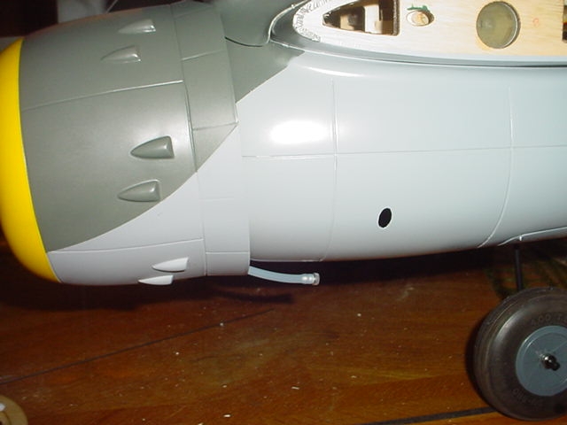

I like all my airplanes to have access to the fuel line behind the needle valve so I can "pinch" test during initial run up. This is especially critical for a twin, I believe, so I cut a hole in the cowl so I can get in there with a pair of needle nose pliers for pinching, and to remove the line for fueling/defueling. My tank is a three hose Great Planes, the hose shown hanging out the bottom of the cowl is the uppermost (vent), and I've used the secondary fitting on the tank for the exhaust pressure hose. During fueling I'll remove the plug from the vent line so I can see the fuel running out when it's full. When I'm defueling, I'll turn the bird upside down so I can use the vent line, as it is a better way to get all the fuel out of the tank.
I used the fixed gear, and used button head screws to secure the factory doors in place. They look real nice and fit real good.

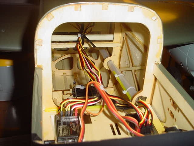

I went with twin receivers, twin switches and twin 2000 mAh batteries. Having two receivers gives lots more places to hook stuff up without using Y cables. I used them only to connect the inboard flap servos together (to channel 5 on Rx #1), outboard flap servos together (to channel 5 on Rx #2), and rudder servos together (channel 4 on one Rx, while the nose steer servo is channel 4 on the other.) I went with separate channels (1 & 6) on the aileron servos so as to be able to have some differential, with a lot more "up" aileron than down. The 2.4 gig receivers require that the antennas be routed at 90 degrees to each other. All the little pieces of yellow plastic tubing accomplish this- they are glued to the cockpit floor and the antennas are slid into them.
The nose gear steering I made pull-pull rod, instead of cable, because I have an awful time with cable.

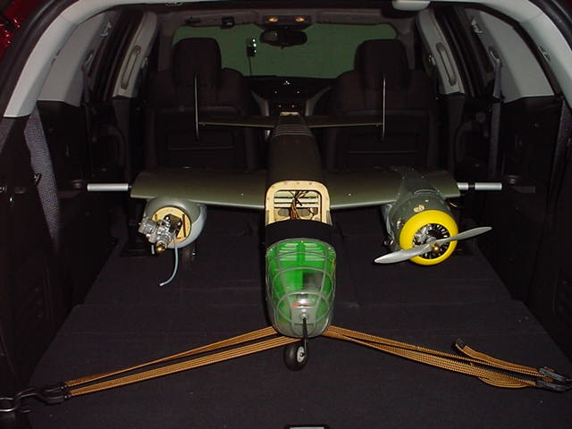

This thing fills up the back of a Chevy Traverse. Got the airplane kit in June. Got the Traverse a month ago. That was close

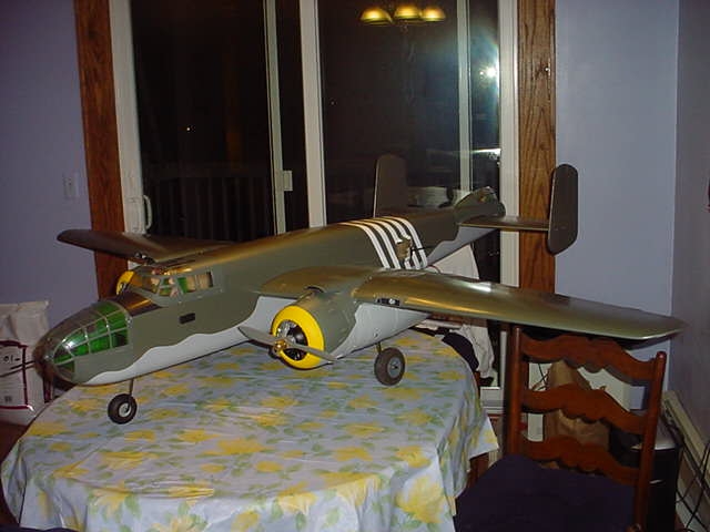

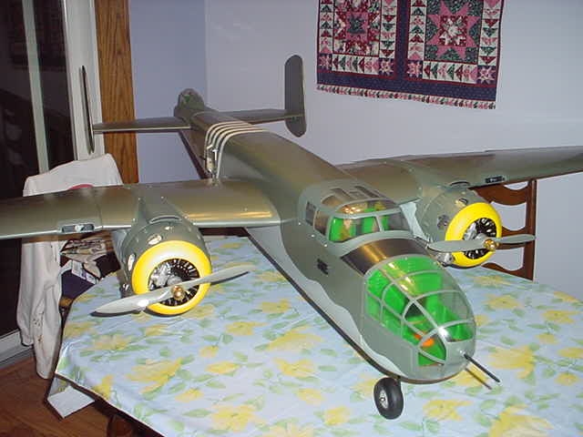

She's been ready to fly for almost three weeks, now, and it looks good for the maiden tomorrow at the Interlochen Field of the TRAMPS club. One day of 63 degrees, little wind and no rain, and then it's back to winter when the storm moves in Friday.
Dry weight as shown is 18.3 pounds. It took 8 oz of lead and two 2000 Hydrimax packs in the nose to get the CG, which is set at about 4-5/8" back from the LE, as close as I could get my CG machine pads to the fuse. Using the accepted methods of calculating CG, this equals 36.8% of mean aerodynamic chord. I don't mind saying that scares the hell out of me. All my other conventional aircraft fall between 25 and 30%. I've seen a half dozen videos of this B-25 flying OK with the CG at 5", and generally they look pretty good, except there is a noticeable tendency for everyone to "over flare" on landing. I think this is due to pitch sensitivity, caused by being tail heavy. MHO. That's why I went with the CG I did. (Top Flite says 4.5 is ok) I also took some hints from various reviews and forum posts, and put in about half the down trim that has typically been used, and some right aileron trim. I also made the flap/elevator coupling give me a total of 1/4" down trim, instead of adding 1/4" to the existing trim, as one reviewer said that the recommended down coupling was way too much.
I'm leaving the turret, gun packs and decals off until she's had some time in the sun to see if the covering wants to bubble up anymore.
If I can get three good flights tomorrow, I'll feel comfortable taking it to Warbirds Over Paradise in January.

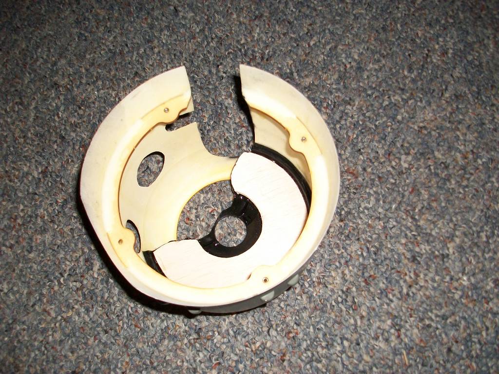

The nose gear didn't do too well at the bumpy grass field- there was a lot of the strut hanging down beneath the plastic mounting block, and it bent in that area. So......I played around with the tiller bar, and ended up putting it in there upside down, with a thin spacer, so as the get the spring coil as close to the mounting block as possible. Should minimize the bending.
The airplane has had a slight nose down angle at rest from the start, and between that and recombobulating the strut, it was way nose down, so I epoxied in some 3/4" thick maple rails on top of the original mounts. She now sits level.
It was a little hard to see, given the overcast skies, especially when on the opposite side of the field. It was almost impossible to tell whether it was banking towards or away from the flight line. Thus the yellow flashing on the wing LE and the fin LE. Ultracote Cub Yellow.
The top turret and the teardrop antenna would be just too vulnerable during transport and setup, so they're staying off for now. Turns out my switches are exactly where the gun packs would go, so those are still in the box as well.[8D]

It seems to me that my engines are running a little on the warm side. (Nose test.) It wasn't a problem during the maiden last fall, as the temp was in the high 40s, but it's a problem now, with temps 70-80F during the day. Not enough air being forced past the mills to cool them.
For starters, the plastic, pretend radial engine is too scale- Top Flite went to the trouble of cutting all the plastic out from between the cylinders so that it would look right. I filled those in with a piece of balsa from the back side, so that air can only enter through the hole I made for the carb, directly in front of the cylinder.
Secondly, any air that does come in can exit any way it wants, instead of going past the engine, as the "cowl flaps" opening is about 360 degrees around the back. Took some more balsa, and blocked off the half of the cowl flaps opening opposite the engine. The pieces are semi circular, and fit behind the cowl mounting ears, with another piece glued to the front between the mounting ears to close up the gap between them and the cowl mounting ring.
Finally, I enlarged the hole on top of the engine so that lots of air can flow around and out.
Wish me luck. I have an infrared therm coming from Tower. I plan to measure my cowled in Magnum 91 that's in my Camel, and has never shown any signs of running hot. If I can get the 55s down to its cylinder head temp, or even near it, I'll be happy.
I had to laugh at the Top Flight "scale" engine when I got my ARF. The full size B25 has a 14 cylinder engine, but not like the one Top Flight modeled. It has two rows of 7 cylinders each, not a single row of 14.
Back to your temperature problem, in my opinion, it looks like the air won't exit at the hole above the cylinder head, but it will try to enter there, with no place to exit. I'm no expert on cooling, so I have the OS FS70's in mine, and the standard cowling setup as designed by Top Flight with only the rocker cover sticking out of the cowling, and there seems to be no temperature problems.
I would try unblocking around the cowl flaps so the air can exit more freely.
Good luck.<br type="_moz" />
Jeez, I never looked that closely at those engines before. That's a hoot. Maybe they were trying to do 14 pushrod tubes and got confused about what they should look like.
The air flowing past the cylinder head hole in the cowl should create a low pressure area, but your theory could also be correct, due to the angle on the cowl at that point. If so, they'll run hotter than before, no question, now that I've close off half of the flaps. If that happens, I think I'll put a reverse scoop over the hole, with just a small hole in the center for the glow driver.
Four strokes seem to have completely different cooling needs. The muffler gets hotter than anything else on them, just the opposite of 2 strokes. I have a friend with an SE-5 that has an OS 91FS, and he has it completely boxed in with NO cooling air, just the muffler hanging out the bottom, if I remember right, and it does just fine. Backfires every now and then, but he likes that. Go figure.
I'll run her up as soon as I get my therm, and post the results.

The rule of thumb for the full scale stuff in the exit is 3X larger than the inlet, thus helping pull the air across the engine. That also holds true for the little stuff!!! Make sure the outlet is larger than the inlet.
Enjoy

The engines are cooling ok. I was just not letting them cool off at idle before shutdown after a WOT run.
As far as cylinder head temp, I don't know what's best. I ran them up this time about 1200 rpm off peak, and they're holding at 275F with 88F ambient temp. They use a lot of gas at that setting, though, and rapidly drop below 200 at idle.
I've read one place that says don't go over 350F head temp, and at least one other that says 225. Anyone have any ideas?

my temp reading is very simply, put a wad of spit on your finger and rub the drops over the cylinder head, if they sizzle off imediately your to hot. if they sizzle off after 5+ seconds your fine.
if it does sizzle off instantly your prop is to big or your cowling is messed up.
