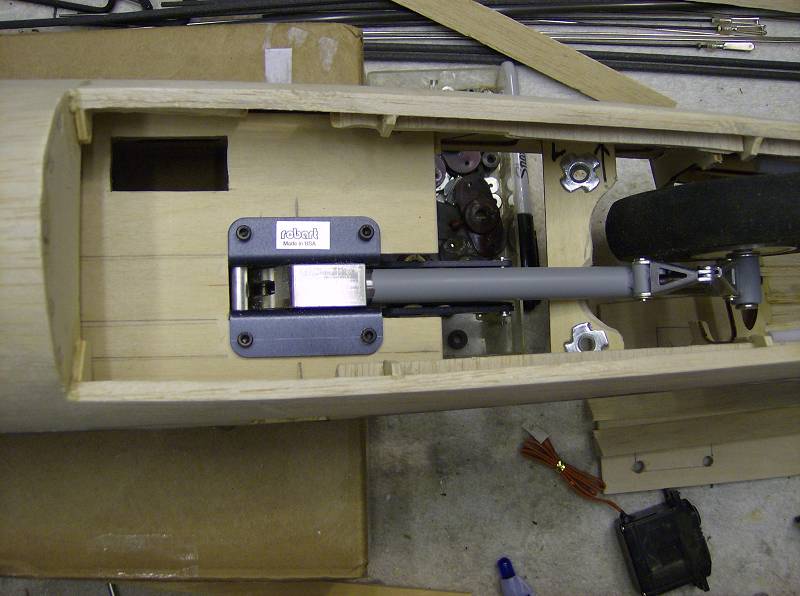

I don't have the H9 F-22, but I have seen them fly. I have added retracts to many planes over the years. Mostly war birds, but some others like the Balsa USA Enforcer (not an ARF). Some things to consider before starting.
- space available for equipment (air type requires more space for the tank and control valve)
- location of the main spar in relation to the CG (the main gear must be slightly behind)
- thickness of the wing for the strut and wheel
- nose gear will need to retract back. Will it clear the tank with enough space for the tire and steering cables to be clear?
- this will add weight to your wing load and landing will be more challenging
- you will probably want to go with a larger engine to maintain performance
- this mod will require major structural work and engineering
- do your homework and research retract installs in general. They must be able to handle the occasional bad landing, or what is the point.

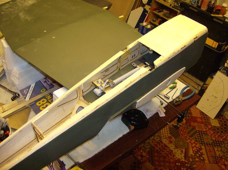

Here are some pictures of my latest install retrofitted to an ARF, like yours, that was not designed for retracts, a P-38. The addition of gear doors makes this an even more complex project, but they are optional of course. Your wing-mounted gear would be fairly streamlined anyway. The hole for the nose gear would cause some drag though.
Here is a video of this plane and one of those bad landings that any gear will have to take from time to time. This install has been mostly up to the task so far. I have had to repair the nose gear mount twice, both times adding more support structure. It is rock solid now.
www.youtube.com/watch?v=VK4tcf7vBvU

thanks for the info, and the pictures do alot for me, they give me some type of how to. and ideas on how to go about doing this.
however the mains wont be retracting into the wings they will be going into the fuselage, just about where the factory wire gear is installed.
thanks for the tip and knowledge

I see what you mean about retracting into the fuselage. I also looked at the thread found by wildnloose, nice find. A full blown ARF bash for sure, gear doors and all. IMO, not a project for a nubee to retract installs, but with enough good info (not enough in the thread as noted), I guess it could be done by a good builder with mechanical skills. It sure would look good in the air though.
