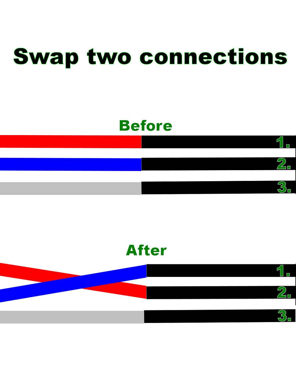

Default RE: Brushless Motor Upgrade Problems
Unplug two wires.
Take one of those and plug it where the other was plugged.
Now plug the one that's left where the first was plugged.
Time to draw a picture............. brb
