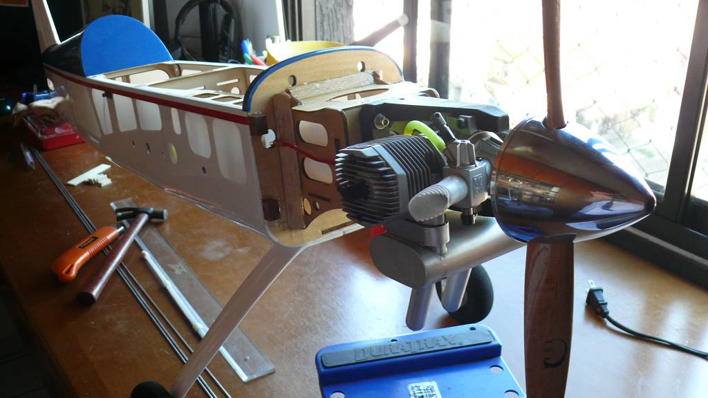

Here is some pics...
I was thinking to make an "in cowl muffler" , just not to make an oversized muffler window .... but I gave up ! To much work and could make engine run wrong , without compression or with to much compression , so ...
Today I install Bison Pitts muffler and cowl ...
And install glow plud driver

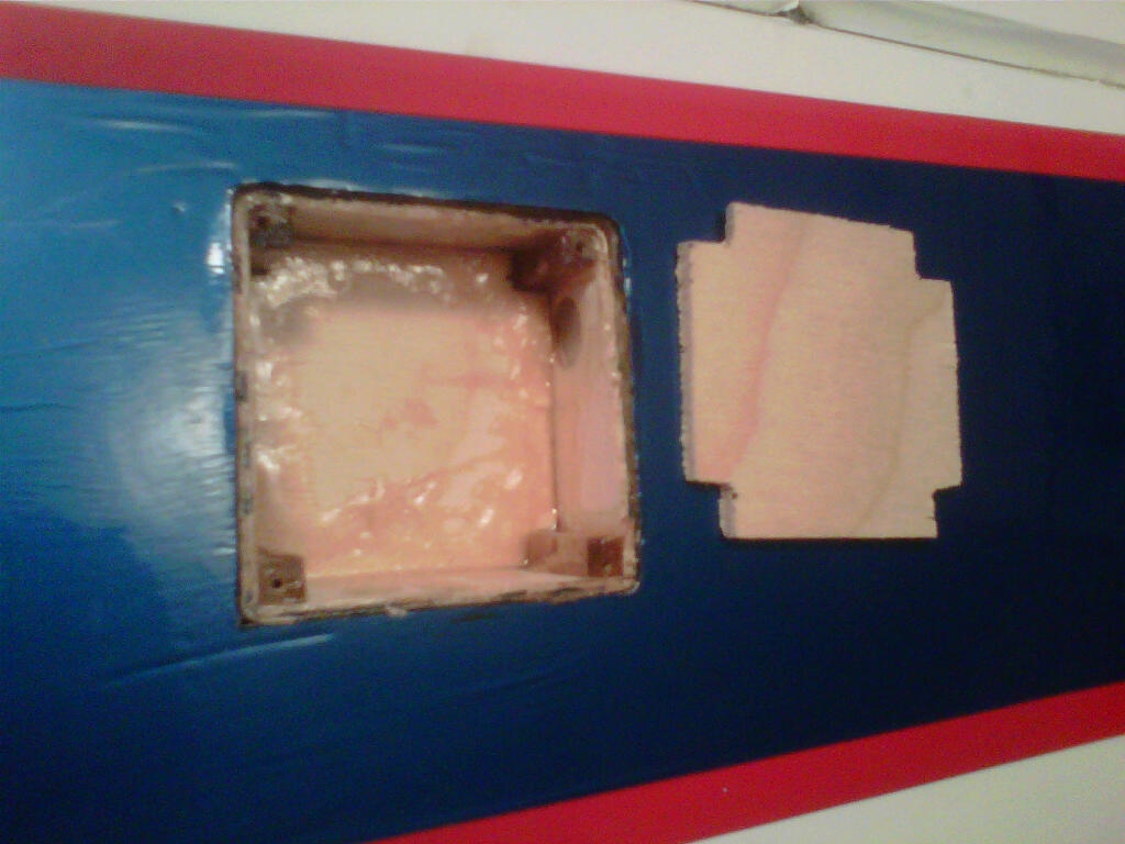

ICEMAN - To anchor those wing servo boxes what I (and others) have done is to add a "floor" (actually a ceiling) to to the box and epoxy that floor onto the wing foam and then to the box sidewalls. Just be sure to use thin wood, else you'll use up space needed for the servo. Some pics attached (my epoxy job could have been neater).
#3984
Joined: Dec 2008
Posts: 854
From: League City, TX
The general idea is to make the attachment of the plywood servo box more secure to the wing's structural foam.
Most of us put epoxy into all the interior joints of the servo box, and work some down the outside of the box between the plywood and the foam.
These boxes have come loose on a number of R70s, particularly those that are flown hard. Losing an aileron is not quite as bad as losing an elevator, but can certainly cause a crash.
I just missed Mike's post above, which is more informative with pictures.

Microdon , I have just finished the wing servo floor , " piece if cake " ...
