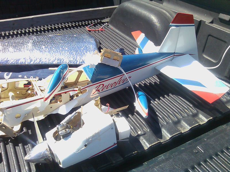

Piled my Revovler in today. I was in a tight climbing circle at WOT (do this a lot) about 40 feet off the ground and then the plane looked like it snapped out and into fast death spiral. As I watched it spiral to the ground in slow motion, I could see one of the elevator halves flapping behind the plane. The CA hinges had pulled out. OK, I'm no longer a CA hinge fan. I had fixed the ailerons with pin hinges due to one of them failing last weekend. Guess I needed to do the elevator halves as well.
I'd like to have another one but I've had this one for a while and would like something a bit more aerobatic. Maybe an Edge, Extra or Yak with a DLE 20 on it.
So you guys continue to carry the Revolver torch!

Spinner
Sorry to hear of your loss.
At least you identified the reason, which helps prevent a 'next time'

"I was in a tight climbing circle at WOT (do this a lot)"
Dreaded FLUTTER....maybe? I saw this happen to a very nice pattern plane a few days ago...traced it back to a loose (worn) servo connection on an aileron.
Sorry about you losing your plane.

I don't think so. Otherwise it would have fluttered on the W.O.T. down lines! I had a Hitec HS-5625 on the Elevator(s) and upgraded to 4-40 push rods when I built it. A 15x6 ripping on a low pass is intoxicating!
I haven't been very nice to this plane since I got it in March or so. The throws are maxed everywhere and I routinely get comments like "Your wing tube is offically G-load tested", "That Saito 100 is pulling that thing right along", "Something is going to come off of that plane one day." How prophetic.
I would buy another one in a heartbeat but I think I'm going to go with a lighter weight purpose built aerobat like a .60 Aeroworks Extra 300 at about a pound and a half lighter than the Revolver. BUT.. The Aeroworks is a more expensive plane than the Revolver so by my rule of R/C, it will have a shorter life span. []

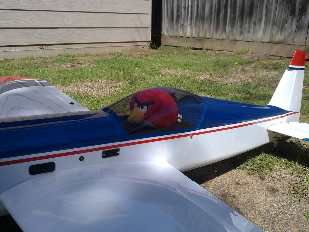

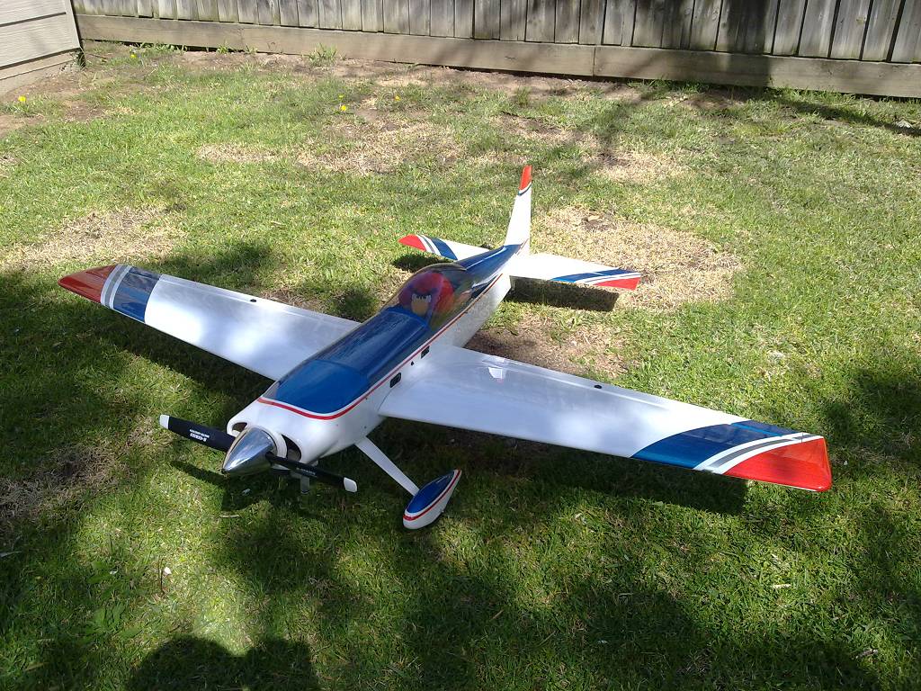

Hi All
My build is finished , now I need some decent weather for a maiden. Given the low pressure systems at the moment it could be a while.
Engine is DLE20 , standard muffler with the extra noise baffle that plugs in the end. You can just see it in the last photo at the end of the muffler. The blue anodised bit.
Two batteries and two switches. Sullivan tail wheel.
Pilot figure by my daughter.

Very nice BC and good luck on the maiden, looks like that pilot is redy to go flying
Give us your report on the maiden Pls.

HA! That pilot looks like he's in a power-dive and he's not sure if he wants to pull out...
