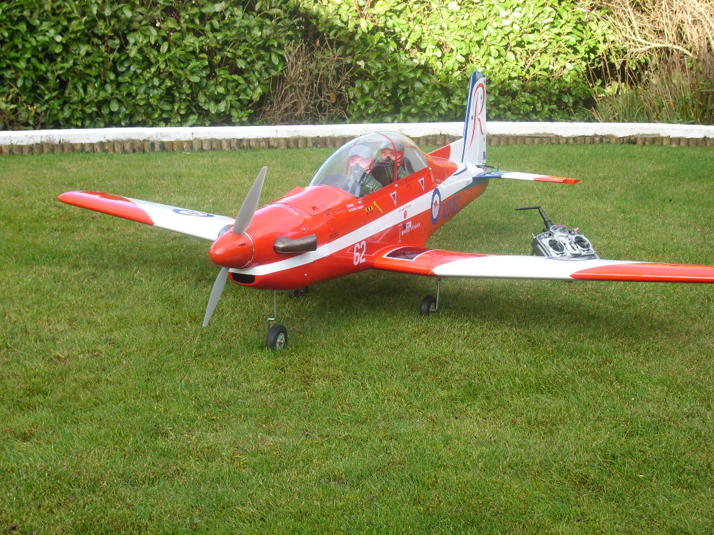

Hi guys, sorry to report my PC-9 went "off air" the other day and she's totalled - engine too! I've bought another one (just can't stay away I guess) and this time I am going to go electric with her to see how she goes. I've just converted my Austars 96" Cessna 152 to electric, a CMPro Mosquito and a VQ P38 so the Pc-9 should go really well. I'll let you know. Dave

Hey Mark,
Thanks for the kind words. There was no deadstick, just a sudden change from level flight to vertical down from 200'. My best guess is the receiver was noty positioned properly - other than that I don't know. I had had many flights with her (too many to count), so I was very depressed about it. The 28MLD gasser fitted fine. All I needed was the correct stand-offs to clear the cowl and she was right to go. It did need weight in the tail to balance so I put the receiver and ignition packs back in the rear compartment (that needs strengthening by the way - the tray comes apart very easily). In order to get the nose gear to fully retract you will have to cut away some of the mounting so you can get the retract unit down low enough - might consider that when I put doors on her...
By the way, the new one has a 200Kv Turnigy motor on 10S Lipo...swwweeeettt!

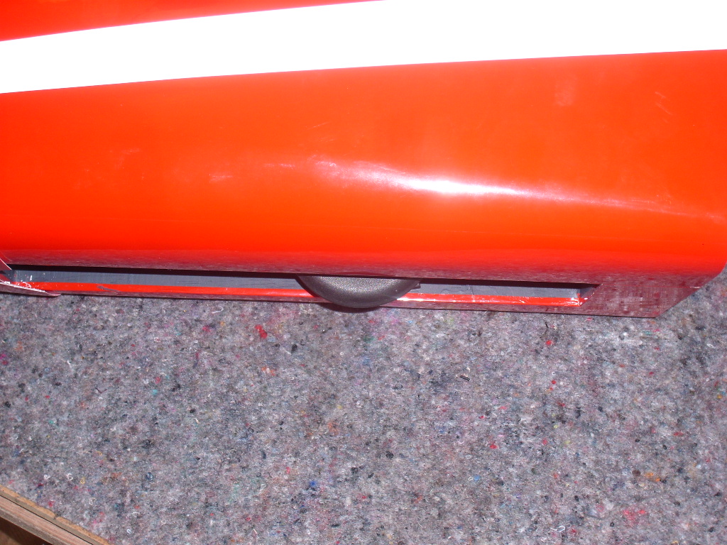

I am nearing completion of mine but have a few issues. The supplied retracts are not great ( bit sloppy ) but the real issue is the nose-wheel - it has no centering, so as the pull pull lines go slack as its retracting - the wheel flops about and fouls the aperture. Seagull just fob me off back to the distributors, but this is a design fault.
How have you guys ( who have not changed them out for alternatives ) got around this problem?

HI GSC yes the nose wheel is problematic, I solved the slack cable problem by rubberbands attached to the sterering servo pulling appart some metal link arms to take up the slack when retracted. The bands were attached to each fus side.

Thanks Robert...I was considering some sort of spring arrangement as you mention - not on really, as this purely down to a design fault and we as end users should not have to figure and fix these sort of things. I know as modellers we tend to do so, but why oh why should we!

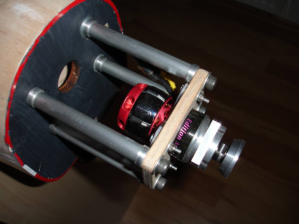

Mi very simple solution to any stall problem: Keep weight as low as possible!
Therefore is deceided to install a geared motor solution with just an 6S battery driving a 17X14" prop.
The complete propulsion system including motor, gear, battery, ESC and prop weights only 2.65lb
Not trusting in the mechanical solution iinstalled a robart 510 series retract.

Sorted the nosewheel steering by using expansion springs on the tiller - they stretch as the leg drops, and keep the whoile lot straight - seemed to work fine on the first model.

The 5A UBEC was wired to the ESC input also, so lost power AND radio at the top of a big loop.
Loved it so much, have got another and halfway through doing her.
Only thing different with the replacement is that I am using 6MM non-caged gold connectors, triple checking my soldering, and will be fitting a power back up unit which switches in an aux 4 cell niMh pack in the event of the UBEC failing.

I also modded the nosewheel mounting blocks to put the frame at an angle in order to get the wheel to tuck up closer into the wheel well, as if left stock, a LOT of wheel hangs down when retracted, which looks IMO naff.
First pic shows it stock, second is after mod.
Its not helped by the rather poor and sloppy retract unit itself, and I havent ruled out spending a few more pounds on replacement units maybe the large E-flite servoless electric units, or perhaps some good 'ol springairs.
I also made removable tail section to enable it to fit in my car - fitted rudder and el servos in the aft section, and used threaded inserts and nylon bolts to lock the tail section down. 2 minute job to fit /release.

Hi,
Some photos of my PC9. I decided to replace the kit provided pilots as they are too large. I got some Aces Of Iron pilots that are 1/5 scale.
The model is a mixture of 1/6( wing ) and 1/5 ( fuse ) roughly . The photo of the full size shows the correct pilot size.
P.S. One of the Roulettes PC9 had an engine failure just after take off recently. Both Instructor and trainee instructor ejected at low level and are ok.
The planes have been all grounded while investigations are conducted.
Cheers,
Merlin Man.
