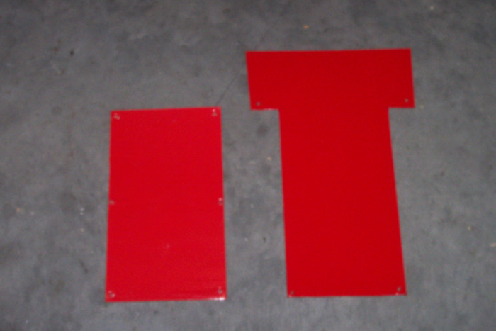

I just got back from flying my Katana. Man, I like that plane better every time it fly it. The RCS 180 was experiencing technical difficulties so I put the Saito 180 back in until the gasser gets back from RC Showcase. I am going to try and post some motivational pics for you guys still building. I have some pics of my larger bottom hatch and a comparison next to the stock hatch. If I can't get the pics to post here check my gallery for them.

bike, who's covering did you use, the match looks pretty good.

The red is Ultracote and the white is Monokote. Another view

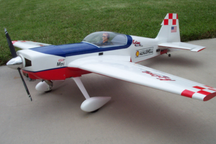

This plane flys soo good. Low speed is great, knife edge all day very aerobatic. Can't say about 3D yet, I just learned to fly 6 months ago.

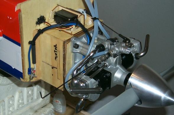

Bike, I see you mounted the throttle servo in the fuse, I've been having a bugger of a time trying to figure out how to make it work on the engine box.

I mounted mine in the fuse last night, I origionally had it mounted under the engine box on the firewall using the two piece wood frame they give you. It worked fine but it did get covered with exhaust oil. In that location I don't know how long it would have lasted. It was very easy to mount in the fuse, I probably should have done that to start with.

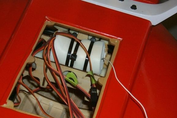

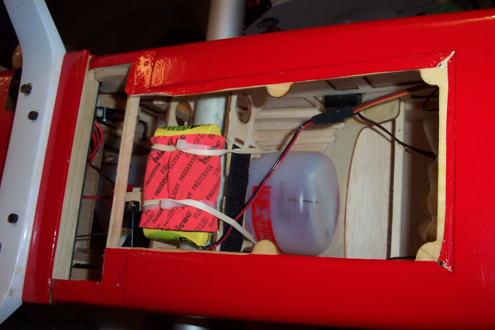

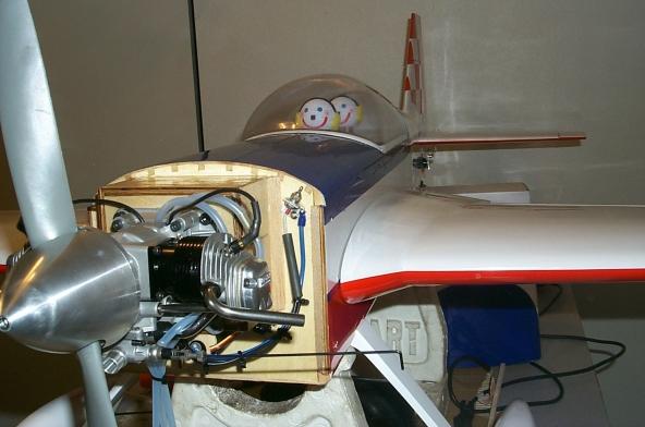

wow i like your fuel tank locale..... i should of done that prolly.. mines in the nose.. i may move it eventually... hatch is good too... i put my battery pack on that part of hat you made removable(tucked it in there and made a little brace to hold it..
also i put servo in front(for nose weight) no bigge if it get thrashed . ,.nothing special.. we will see how soaked it gets... heh may end up moving it too!.. ill toss up a few pics....
i have cowl to carve up still.. and some breaking in to do.. but i am close i think..

hey bike what did you do with the 3 leads running down the fuse for servos>? did you attach or support them anywhere>? how about leads in the wings>? (for servo`s)
and what did you do with antenna>?
oh nice dash heh
Old 07-16-2003 | 12:57 AM
  #46
Swat Cop's Avatar
My Feedback: (11)
Joined: Feb 2003
Posts: 910
From: Kissimmee, FL
Default Servo leads
I ran all the leads loose inside the fuse and wings. I connected the extensions to the servo leads with heat shrink tubing so they won't pull apart. I ran the antennea right down the center of the fuse and out the tail hatch cover.
Fud, looks like you will be ready for the maiden flight soon. That twin looks sweet, I'll bet it sounds even better.

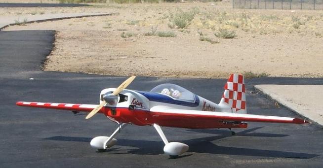

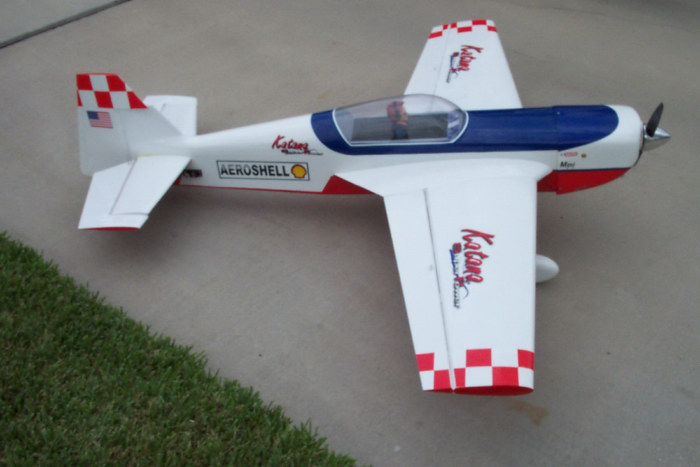

well today it flew!... i had a few motor/prop issue`s.. you can read about them on this thread
http://www.rcuniverse.com/showthread...79&forumid=145
but got them worked out so far... flew awesome!... i had a small taxi issue on the ground when the wind picked up.... sort of garfed up the wheel pants so i have them off for repair.(looks dorky but oh well) ran 3 tanks through it....going out tommorow again nice snaps(slow) inverted....inside and outside loops.,, ok verical ./////will be better tomorrow.. see other thread on my motor prop issues....
tracks good down the runway. all in all i am happy....
the miss`s are crappy covering..started to peel in spots . i had to fix...then it looses color...
and wheel pants jut plain are cheesyy
