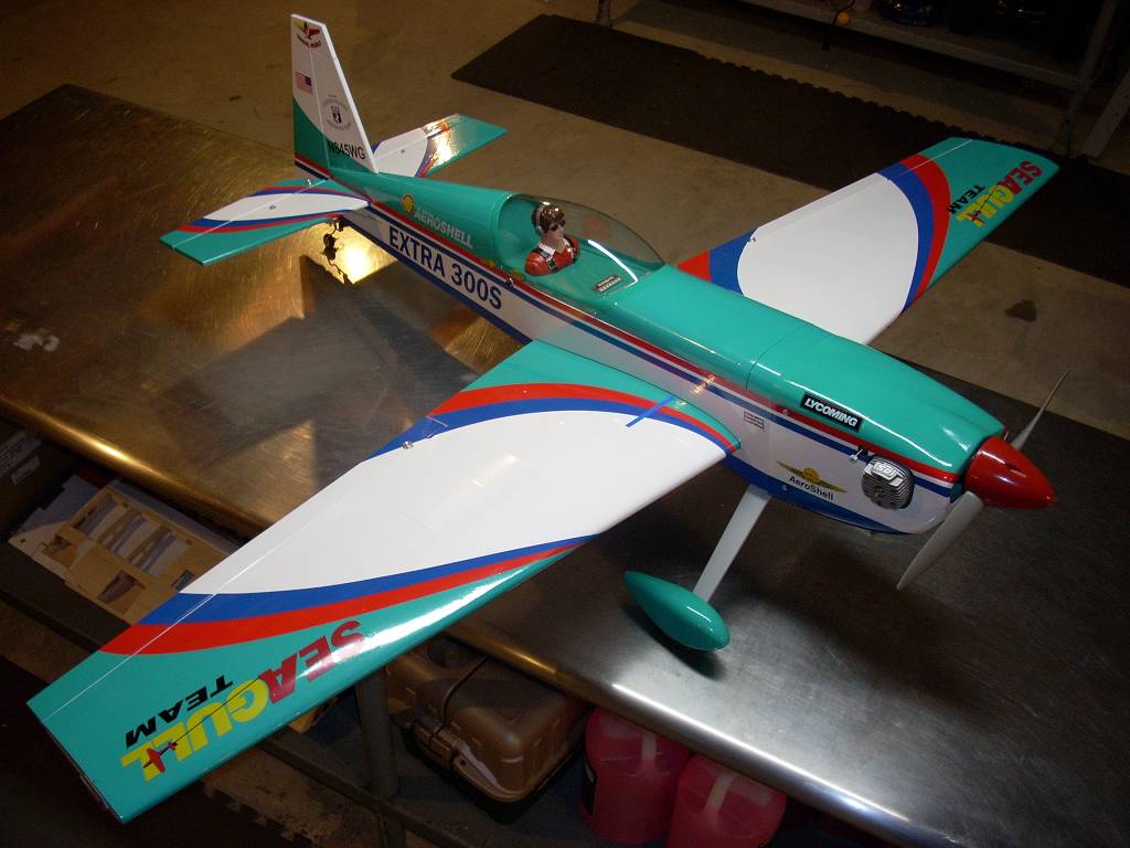

I truely enjoy flying this plane, It's a little hard to get good 3D out of it because of it's strip aeilerons but it will hover very well. I run an OS91FX and it doesn't lack for power.
