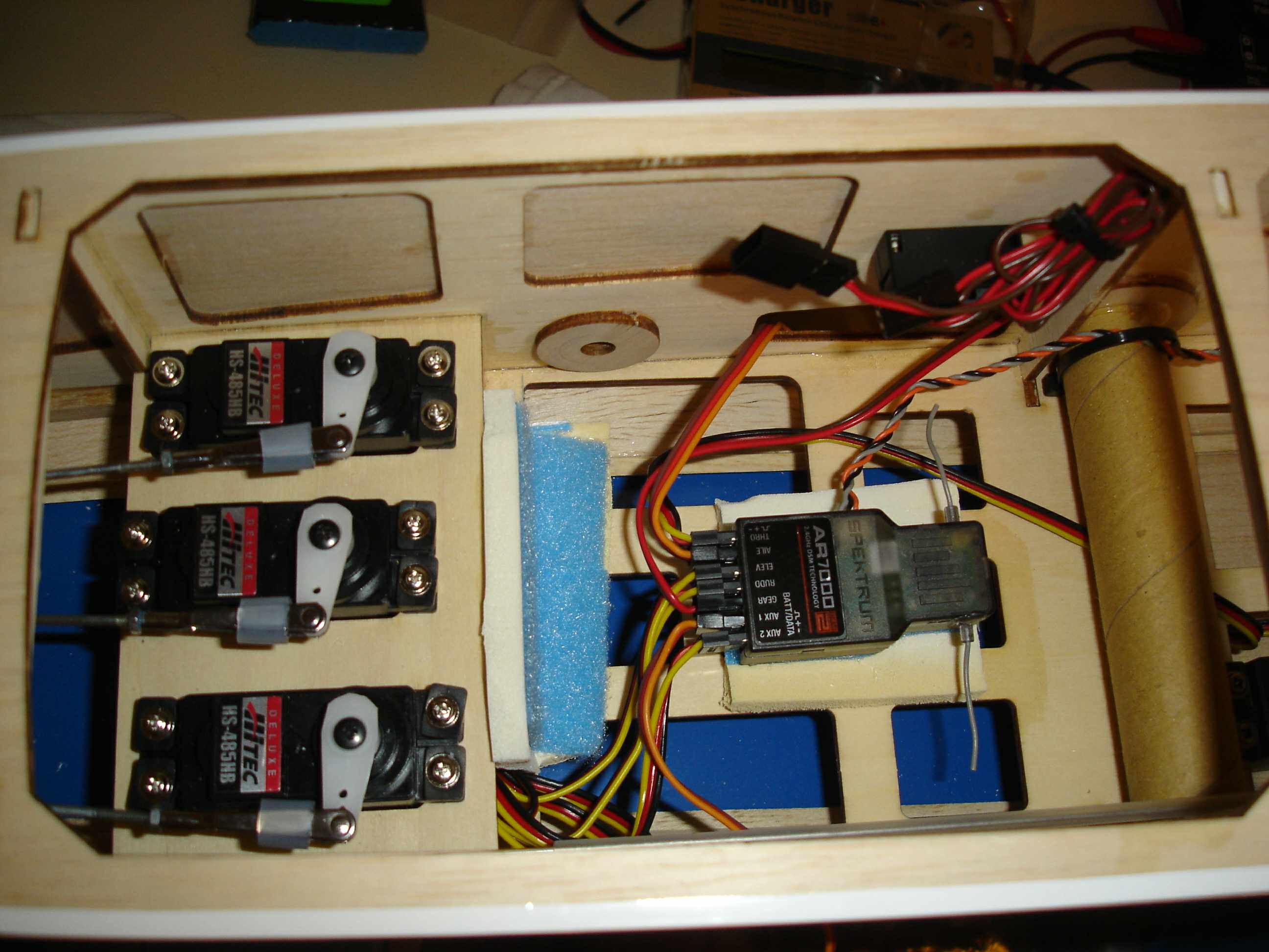

ghoffman,
though this comment may be a bit late but I had to say it. Terrific wiring job there...best one I have seen till date inside a model airplane
Ameyam
Ameyam

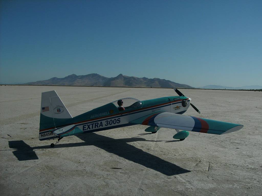

From: Grants, NM
Just helped Psyched get his Seagull Extra 300S up and running. He powered his with an OS Max .75 and it's waay overpowered with that engine. We flew it with a 14x8 and that's definitely too much prop. Still, I like the plane. Be ready with the rudder and throttle up gently as previous posters have mentioned, and this thing will jump off the ground quickly and easily. We used the factory CG setting and it works just fine. No need for lead; Psyched used a 5 cell battery behind the servo tray to balance it. The plane is a keeper; it pretty much stays where you put it and flies nicely. The landing was smooth and easy; didn't realize I was landing crosswind until I touched down. Throws were all set to factory settings except the elevator; I added just a bit more on low.

Steam,
I checked your photos; we put the 5 cell NiMH battery in the bay behind the servos, up on the side of the fuse opposite the cylinder head. It came out spot on the factory CG that way, with no added lead. Our final weight was a bit over 7 lbs - what did you get for a finished weight? You're right; with the 14x8 K series, this thing is a rocket! Still, I'm impressed with the airplane: good manners, more than enough control authority, and it flies very light and easy on the sticks. Psyched is interested in being able to use more throttle and keeping the speed moderate rather than just blazing around; we'll try a 14x6 next. What tach readings are you getting on your OS Max .75 with that 14x8?

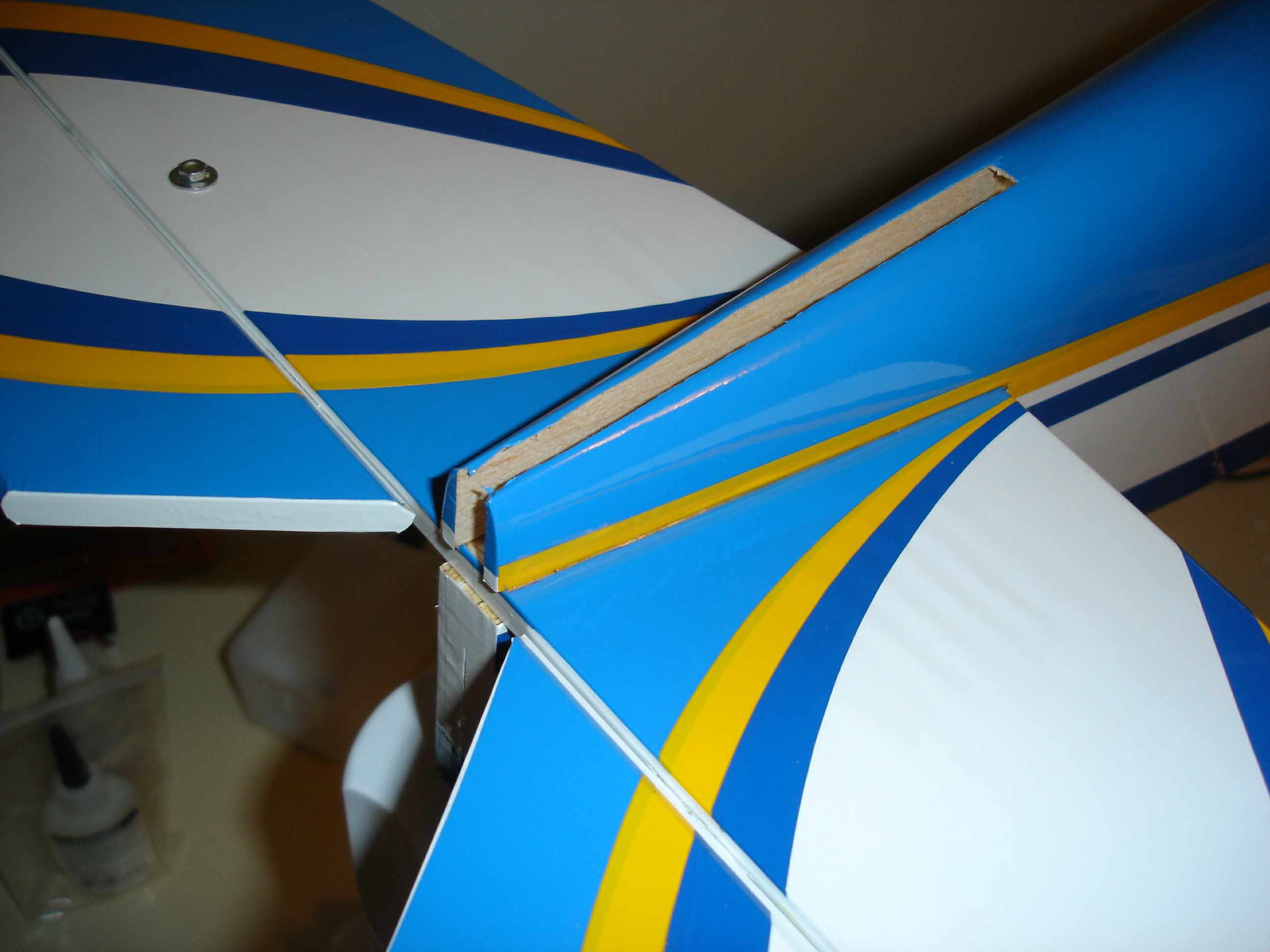

In case anyone was interested, there is an actual plant in Vietnam.
<div><span class="yiv2014148267Apple-style-span" style="FONT-STYLE: normal"><u></u></span>Seagul Models Manufacturing and Trading Company ltd.,</div><div>Office address: 62/8 Ngo Tat To, Ward 19, Binh Thanh District - HCM City.</div><div id="yui_3_2_0_1_13451281208082068">Factory address: 12/101 A, Hamlet 4, Dong Thanh Hamlet, Le Van Khuong Street, Hoc Mon District , HCM City, Vietnam.
I just got my Extra 300 - 75 yesterday. I must say, when it comes to ARF's, I'm a real nit-picker, I'm always looking for the bad. And I always find it, either bad covering, bad glue joints, poor alignment, something is always wrong with every ARF I inspect.
Not this one. At least not yet, I've only done a short inspection as I un-packed the box. I mean there is always something wrong that is very visable right away. I am very immpressed with this one.
I have noticed that there are no assembly threads on this plane. I will not call it a "build" thread because I didn't build it. So if there are no objections I will just add my two cents to this thread. I will post photos as I go. I plan to start tonite. If anyone knows of any issues with this plane, please post so I can correct as I assemble.</div>
