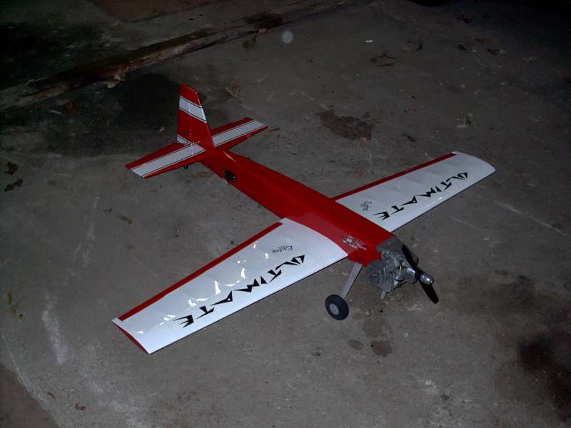

Old 03-25-2004 | 01:38 AM
reaper329's Avatar
Joined: Jul 2003
Posts: 33
From: Marengo, IL
Default RE: Modeltech Extra 300 what engine to hover
I just highly modified mine someone let me know how to put photos up and I will

Old 03-25-2004 | 04:06 PM
reaper329's Avatar
Joined: Jul 2003
Posts: 33
From: Marengo, IL
Thanks For the info I just was looking to hard I guess well here is is I made my own fuse to take the super tigre .61 12x4 prop. very good flyer I am going to whitch the .61 with a mvvs .49 when I can find one almost the same power but a lot lighter that ought to be the perfect match. let me know what you think
