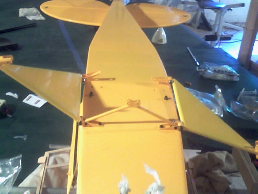

Well if you like cubs but aren't a big fan of yellow, like me, KMP's L-4 Grasshopper is for you. It's May 8th and late in the building season in Wisconsin. But there is time to knock this one out. Everything was well packaged and damage free. The L-4 is covered in fabric, painted a very subtle camo green with invasion stripes. The interior is black and needs a little touch up. I started building mine this morning, and after 6 hours it is 80% complete. If this plane flies as good as it looks, it will be a favorite. KMP did very nice job. The build, quality, part fit and overall looks are great. I should note, the landing gear is not the typical bent piano wire. It is a Cub style working landing gear. It does need a coat of paint though. It's well worth the price. If you use a gas engine, get one with a side carb, not a rear carb, Too long. Now the things I don't care for. This stuff may seam petty but, I got to tell the truth. #1 The tailwheel assembly is less than stellar. It is a bent piece of wire. You know the type. I will get something a little more scale. #2 The fairing for the LG bolts to the landing gear. Problem is that the supplied bolts are too small. 4-40 hardware took care of this. #3 is the attachment of the struts. The struts bolt onto a brass knurled insert which is glued into a wood block. Some blind nus took care of this. #4 I dislike nylon hardware. I replaced mine with Sullivan hardware. Now all of the things I mentioned are personal preferences, except for the fairing bolts. KMP's L-4 is one nice plane. If you want a Cub ARF unlike the other ones at you local flying field, order one of these, you won't be sorry. AA++ You will need some OD green (spray and bottle) and flat black (spray). I'll keep posting as the build goes on and post a few photos. Feel free to contact me with any questions.

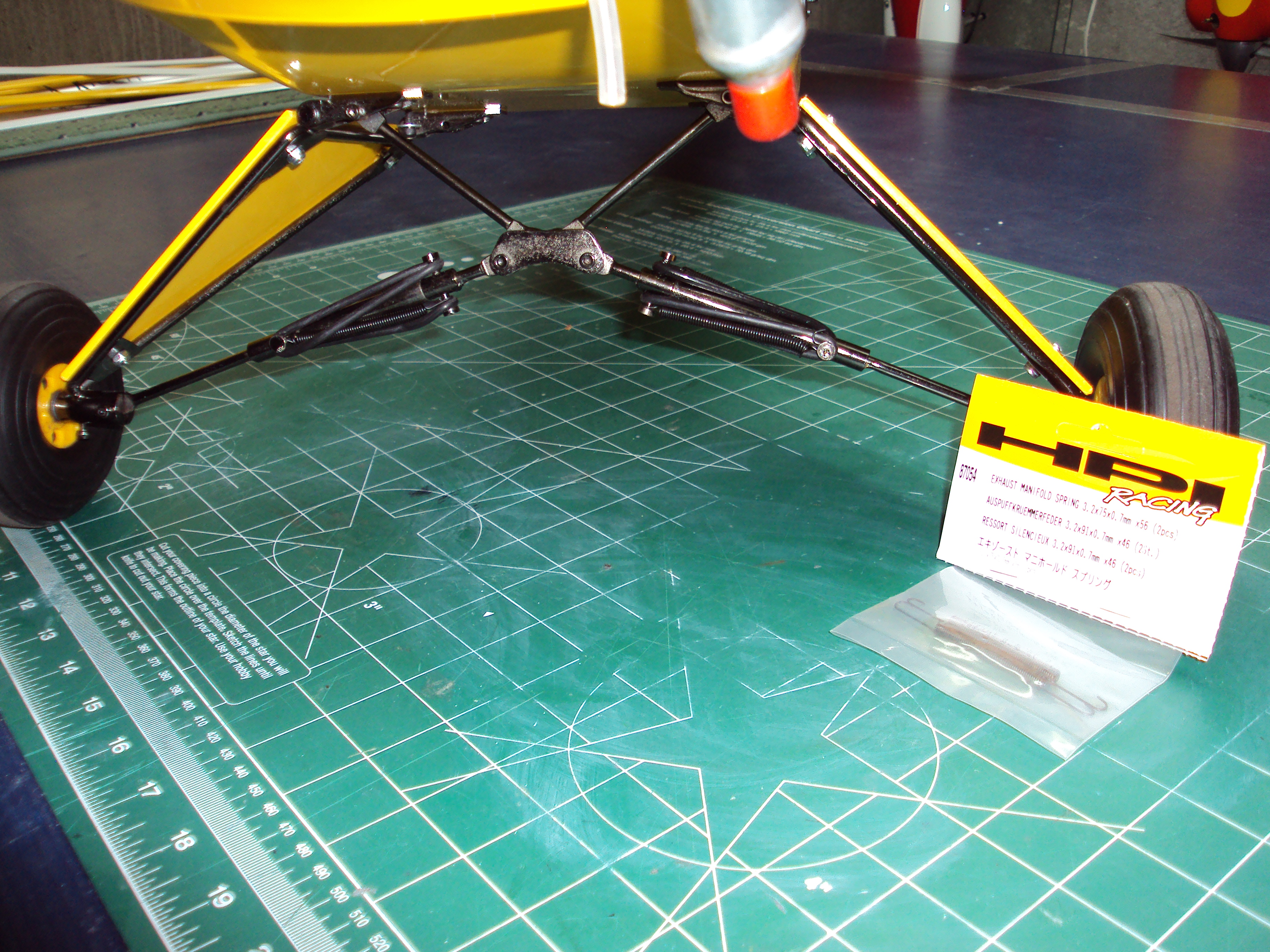

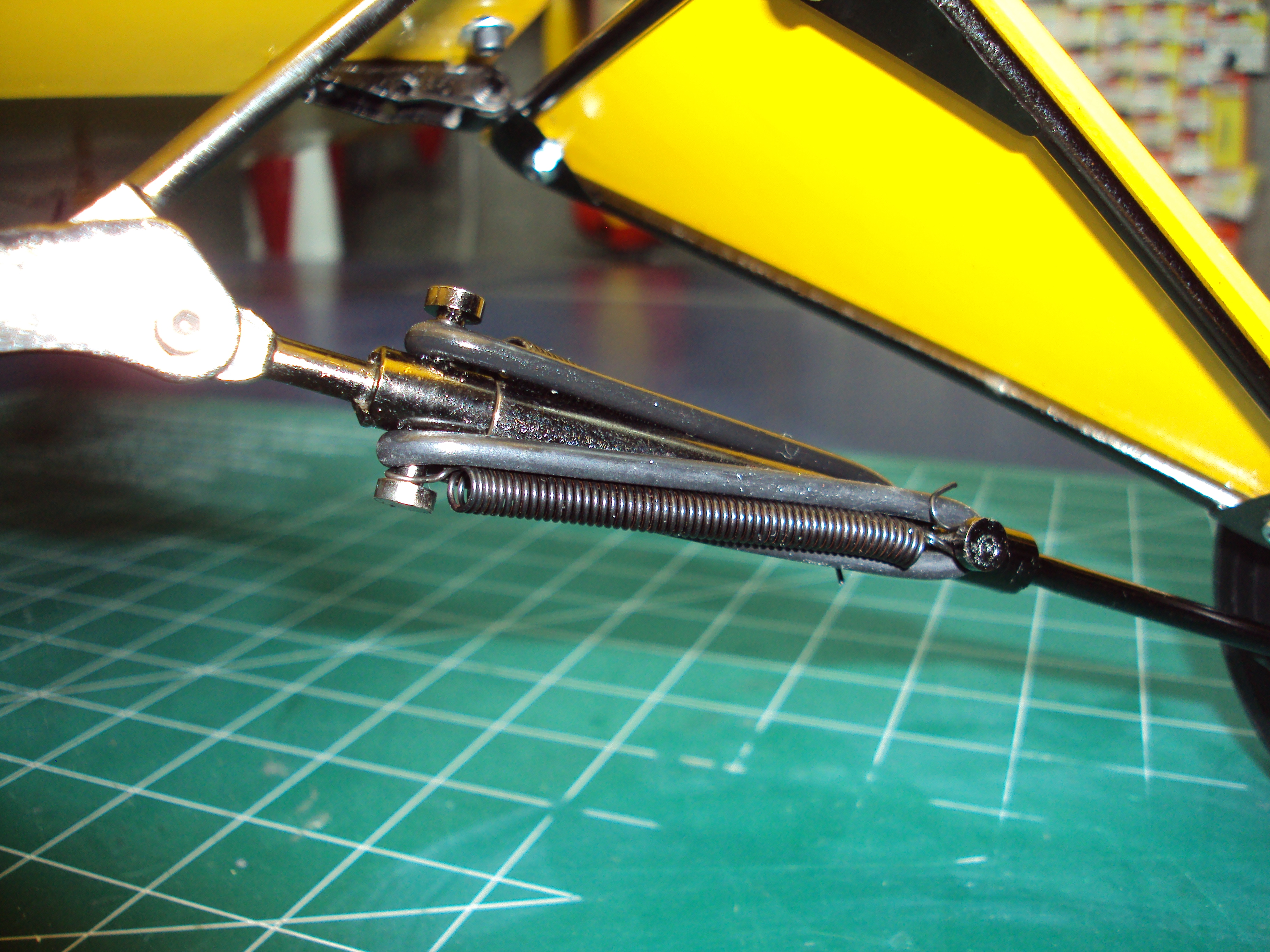

Bob, I've got the "go-ahead" from the wife to get a Hangar-9 Cub gear. But before I do, Look at these pics and tell me what you think. The springs have quite a bit of tension restraint and along with a couple of the O-rings, there seems to be enough "stiff" to hold quite snug in place. I can't figure out how come yours have broken at the welds so much. Could it be maybe, less than smooth landings with a lot of bouncing ? [ tactful courtesy intended ] Mine will not flex out unless there is real pressure to do so. My point, am I wasting money or would it be advantagous to buy the H-9 before they are out of stock ? MM

Hello mormon Mike. I've got a Kmp L-4. Looks like your J-3. While assembling mine, both the 0-rings on the LG broke. I should mention it was over night. Just the fuse, and two servos. No engine no windows no wings no struts. Are broken o-rings an issue, or did I get some defective ones? Please advise. 1builder

Ahh!! The learning curve has begun. MM and 1 builder. If you read the beginning of the CMP Cub thread, you will notice mention of the bungees breaking while still on the bench being built. Very cheap. Mine broke before the first flight!!. Lowes has the perfect O-rings in their plumbing section. I used the 2in ones and put three on each side and they never broke or gave out. I believe they are made by Delta. Now for you MM. I take pride in my soft landings!! All one of them for every Ten trys Ha Ha!!. I personally dont think you need to get the H-9 gear yet as I flew mine extensively for a year before it started to fatigue. Then one side broke. Got it welded and the other side broke next time out at the field taxiing in!!. Got it welded. Then that same side on the lower part of the bungee assy broke. Got it welded. Then the top one went again and I gave up. The welding could have also changed the mallability of the metal. but I will gaurantee yours will go eventually and yours too 1 builder, no matter how soft the landings are. Its just very cheap metal.

MM. On your first pic do you see where the bungees wrap around the posts at the top? And, do you see where the arm that goes from the center bridge to the bungee assy? Those posts actually go thru the bungee assy. and thru that arm, leaving , I believe, about 1&1/2mm of rod on each side that is actually holding that darn gear together. Any duration of vibration combined with cheap metal is doomed to fail.

O-rings are faulty. Mine broke as I looked at them moments after I installed them !. HPI springs and thicker, better quality O-rings combination will work but reports are that the metal gear is weak at the welds and are braking. H-9 Cub gear appears to be a better solution. $78 bucks though, But I believe I'll order one. 87054 Exhaust Manifold springs are the HPI product number from Tower Hobbies if ypu want to try that combo. It certainly is much stronger. Great flying Cub, straight take-offs and landings [strange ] Seeya, MM
