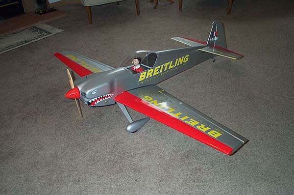

You always balance a low-wing plane inverted and a high wing plane upright. You'll love your Cap. Mine has a OS .46 FX. Could use a little more power, but its gonna have to do.

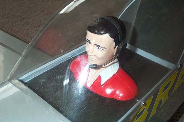

And the pilot who flies it. Just a Williams pilot and I added the headset and mic. Thought it turned out pretty good.
