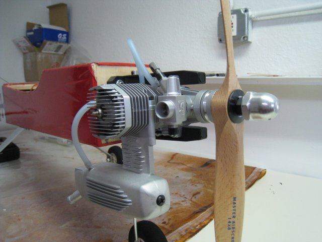

if you can, I'd highly recommend over powering your stik. Then you can experiment with hovering, etc. I'm using a OS 95ax in my Great Planes 60 sized stik and it's the most fun one can have this side of the law. I recently stalled and crashed it by flying too low and slow. Thought about buying a different model but I just couldn't stand not having a stik, so I ordered a new fuse and it's all back together.
Here's a pic of the 95AX.
EDIT: there's also a known weak spot on both sides of the fuse just in front of the horizontal stab. You'll know it's fractured if there's any flex in the fuse just in front of the tail area. If you can, before gluing the vertical stab, take a couple popsicle sticks and reinforce the area inside the fuse.
Read more: http://www.rcuniverse.com/forum/m_98...#ixzz0toQu1VTM
DenverJayHawk,
I am with you I have put a ST 91 with a pitts style muffler on mine. I have yet to finish it though as I had to go back overseas to work. My question is how nose heavy did your end up with the OS on it??
Derrick

it ended up pretty nose heavy. I moved the elevator servo to the back of the fuse and placed the receiver battery as far back as possible. I also added tail wires to strengthen the vertical stab. Even with all these changes, I still needed 2 ounces of lead inside the fuse before gluing the vertical stab in place. On my rebuilt Stik, i placed the elevator servo even further back and only needed 1 ounce of lead. I like my models slightly tail heavy though, so I could have likely gotten away with less weight.
