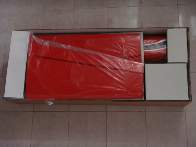

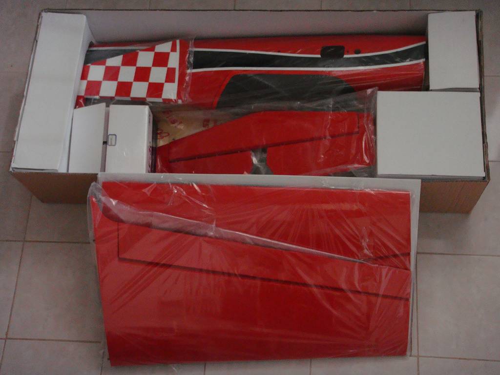

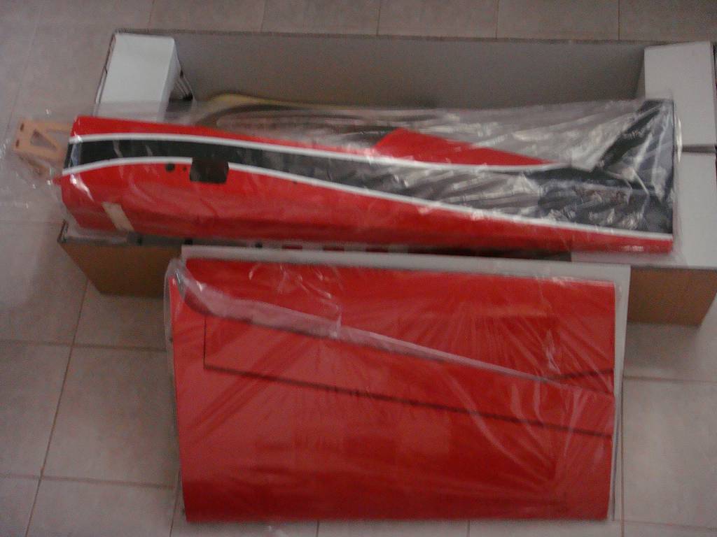

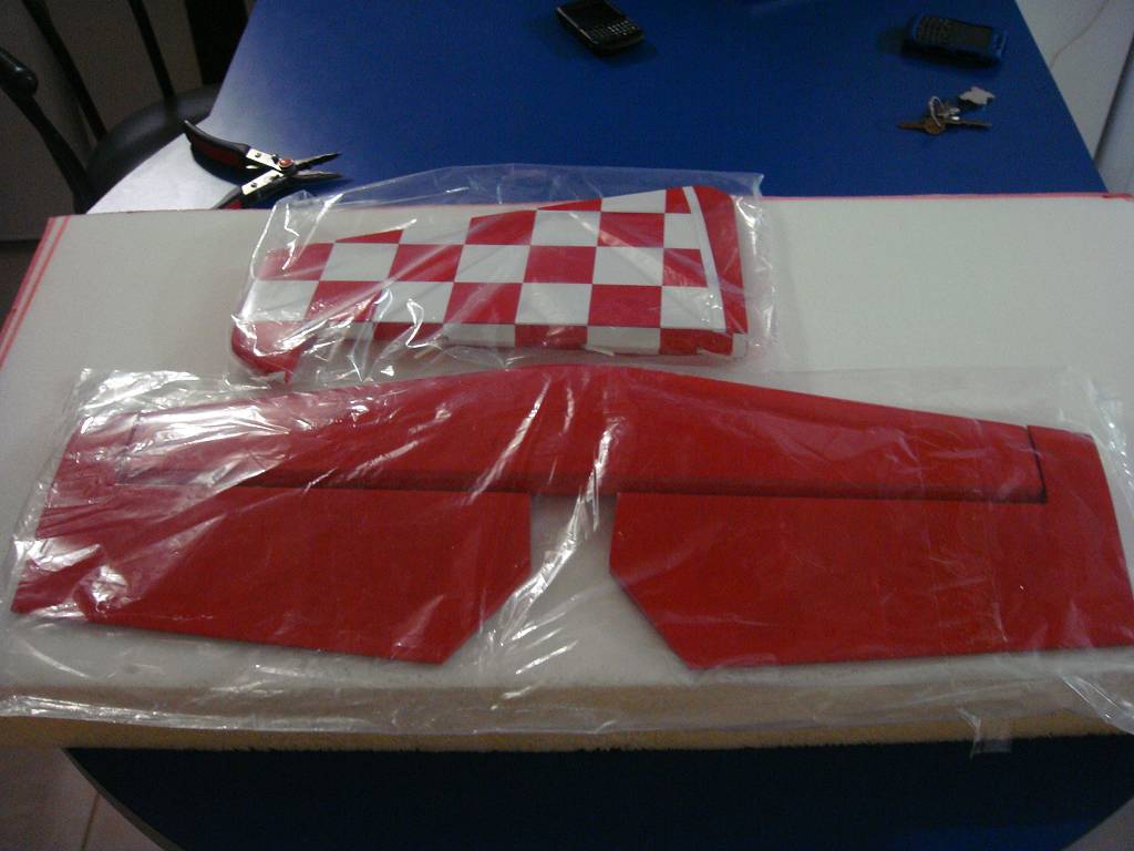

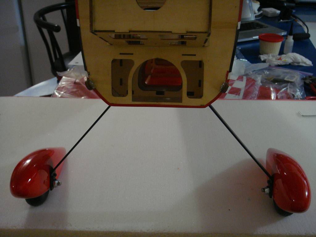

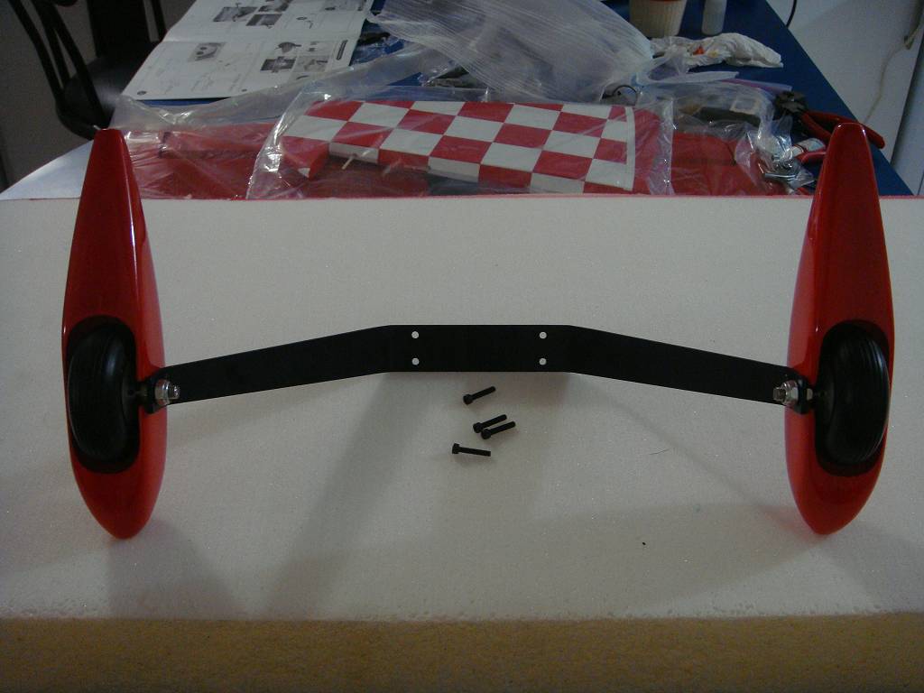

Hi,
I am relatively new to the hobby but I think I have been involved with enough passion, having built and wrecked a few models, to give me some confidence to build and share my experience of the Red Wing MX2. I recently received my plane from Tim who has been one GREAT service provider in terms of ensure his customers are treated like customers should. Tim, I am happy to report that the model arrived in Montego Bay, Jamaica all in tact so, thanks again for your great service and attention to detail. I have attached a few pictures of the packaging which I must say was well done to allow the model to survive the journey through Miami International Airport on American Airlines to Montego Bay. As you can see everything is included in the package as advertised n the Red Wing RC website. The parts are well manufactured andfeel very lightwith joints neatly glued. I am pretty sure she will by within the published all up weight range based on what I am seeing here. Hardware looks as good as any you can find from any other supplier.<br type="_moz" />

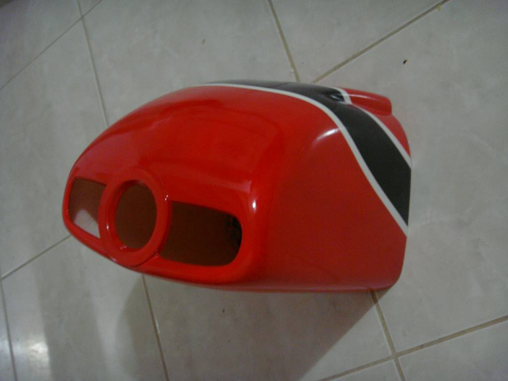

more pictures.....
You will see that I got the combo package with the DLE 30. I Intend to use Red WIng supplied Power HD DS090 servos everywhere except on the throttle.<br type="_moz" />

You are absolutely right, the manual is very easy to use. My experience may have been influence by the fact that I watched the MX2 build videos posted by Tim on Youtube a couple times. So far, I have assembled the tail and main wheels; the main wheels are installed. I will continue tomorrow, bed beckons and as its been a long day I have decided to answer the call.

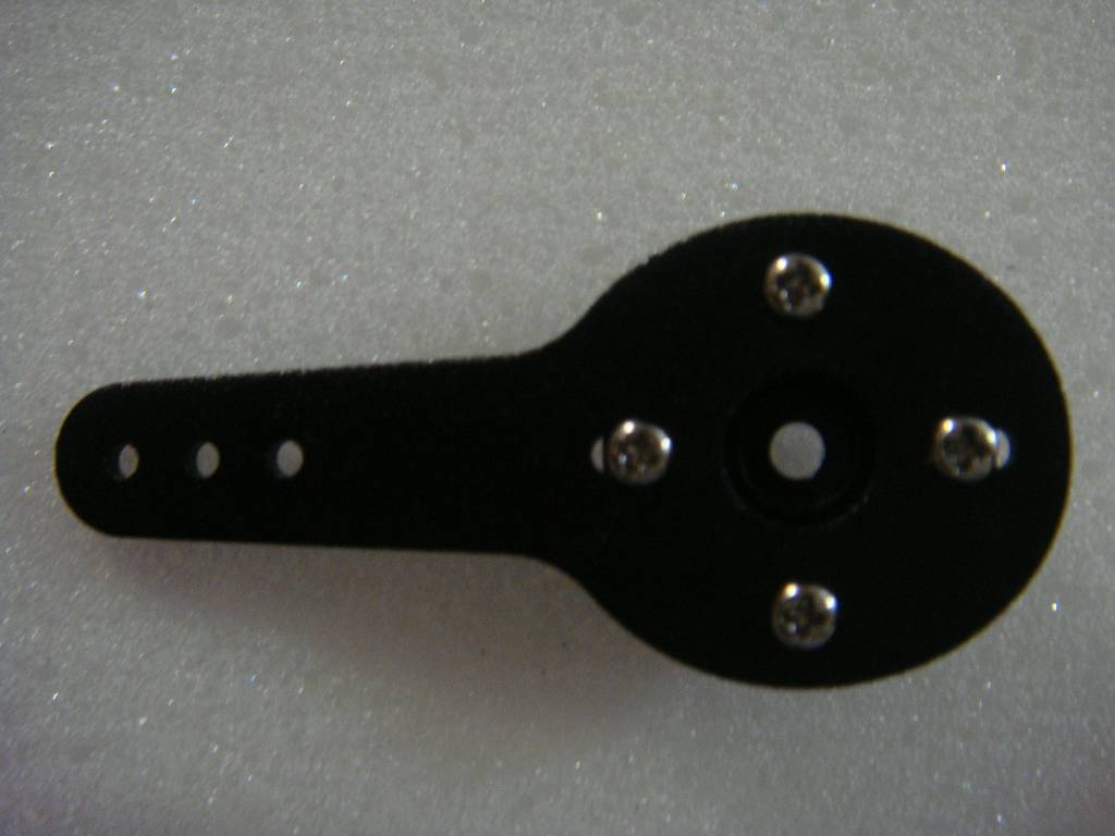

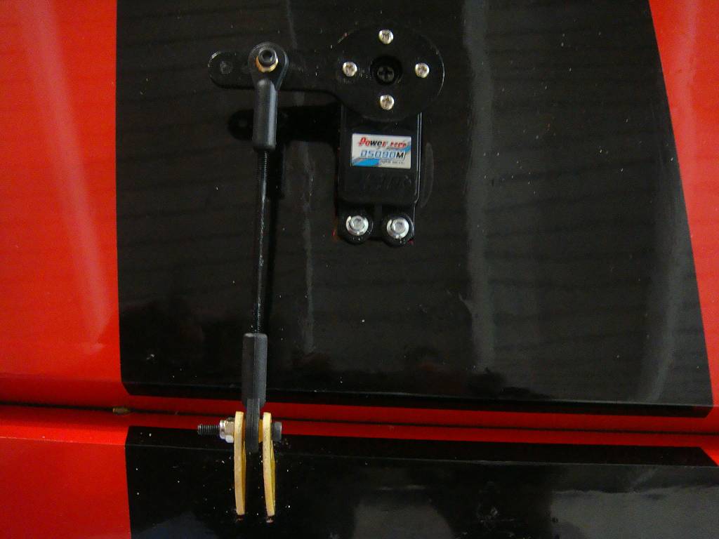

<span style="font-size: 9pt; line-height: 115%">Imanaged to do some additional work last night focussing primarily on the wing servo and aileron control hardware assembly. As Istated previously, Iam using Power HD servos which I installed using socket head screws which reduces the likely hood that I will have a screwdriver slip and puncture the covering.While installing the anodized aluminium control arm to the supplied servo circular control horn I realized only that two of the holes lined up. Itherefore had to bore two holes in the aluminium arms.
The pre-cut slots in the aileron for the control horns were easily identified and once the covering was cut away applying 5 minute epoxy and inserting the horns was as easy as 123. The supplied ball links and push rod was easy to assemble and install despite having to drill the control horns on the aileron and also the aluminium horn on the servo to receive the supplied socket head bolt.</span></p>

Forgot to upload pictures
