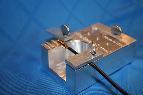

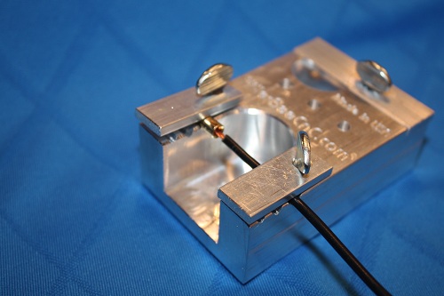

Here is a jig that I make at home on my Cnc. It is made from t6 so it pulls the heat out of the dean's keeping it from melting.

OOOh, I like that... ingenious. What size pins do you have it sized for???
