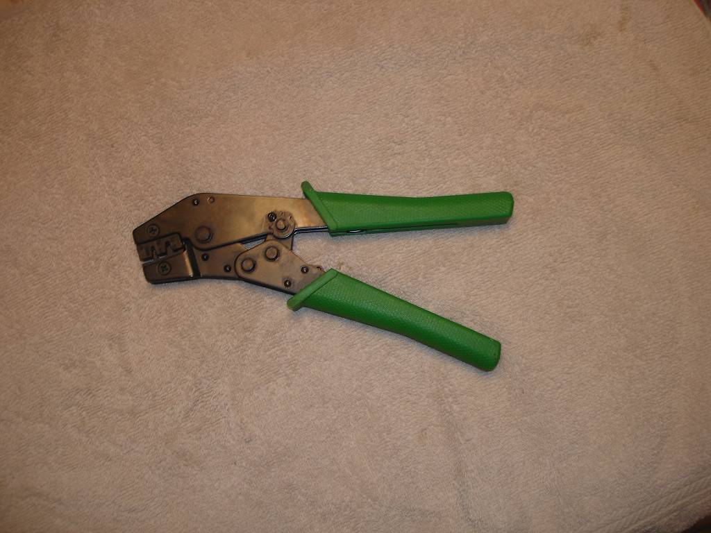

I have a crimper that is made for this application. I don't trust my soldering so I use the crimper. Make several for club members. Knock on woood, no problems so far.

Here is a picture of the crimper that I use.

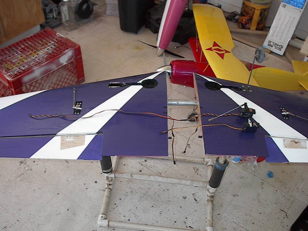

So John if you use that servo in another application and the new lead is now too long, what do you do? Maybe I am the only one that switches servos from one plane to another.
Old 09-27-2010 | 10:08 AM
JohnBuckner's Avatar
Posts: 10,441
Received 11 Likes on 11 Posts
From: Kingman, AZ
Default RE: making your own extensions
If the servo is reused Its easy to cut one with a long spliced addition agine at one of the splices and just shorten to the perfect length. Thats three solder joints to be made that can be done in quick time no problem. To splice in a length of wire it is six joints.
I usually get my servo wire from servo city but I think tower has it also.
I keep a full range of soldering irons since it is so handy from time to time in the hobby for example I never use wheel collors and always solder the axles never loosing wheels. I see that one happen every day at the field. But the point is for the simple jobs of splicing wire harness you need only an iron that can be had for ten bucks, just a 25w pencil type and keep on hand some shrink wrap and a little solder. A wire splice is the simplest soldering job of all and an ideal first type of soldering to start with. Exactly like monocoat it soon becomes fun after getting past the fear of just doing it.
John

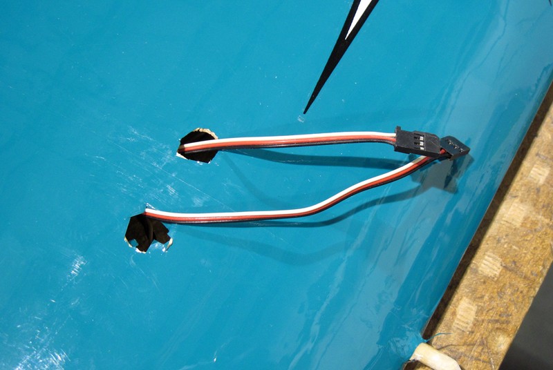

I hard wire and shrink tube mine also.

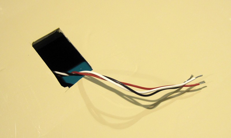

Here you go Gene, one stock servo wire and one I made up for a plane by soldering in a splice to get one the length I need. If I use this servo in a smaller plane {or bigger} I can just cut the shrink wrap off and unsolder the wires then do what needs doing. I solder on all three wires and shrink wrap then I use a piece of bigger shring wrap over the splice. These also slide through the lead tubes easier and I never have to pull and clean them. It takes me about 15 minutes to do a splice with 6 solder joints.
