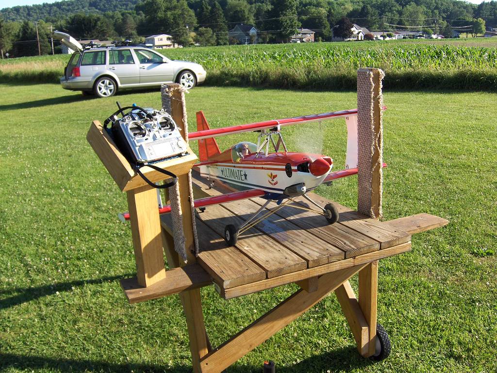

Ibelieve the last five glow models Ihave built/assembled had the muffler low and centered. Keeps the exhaust off the airframe and the weight of the muffler tucked on the centerline.
