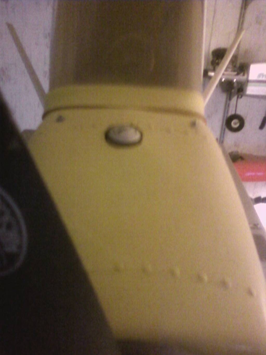

I have one of these in my KMP Husky mounted right where the fuel level indicator would be on a cub.
http://www3.towerhobbies.com/cgi-bin...?&I=LXEXX1&P=7
It works out really well, because if the tank is above the carb like mine is, it puts a "high" spot so you don't get the flooding that sometimes happens.
I made a bracket out of light ply so it would sit just inside the cowling, then glued the bracket too high.
Not too bad though.

I put a fuel dot on top in front of the windshield, right where the fuel cap/guage would be on the real one.

i used a fuel dot on top and one on the bottom. fueling from the top, air and excess out the bottom. works like a charm! you can see the one on the top but the one on the bottom is not visible.
i've used refuelers before but never got them to work well with 2-stroke engines. with 4 strokers the fuel is pulled easily into the engine but with 2-strokers the need for the exhaust to push the fuel to the engine may be an issue. the refuelers (including a few from dubro and some china-made copies) tended to let in air after a while. just my experience.
