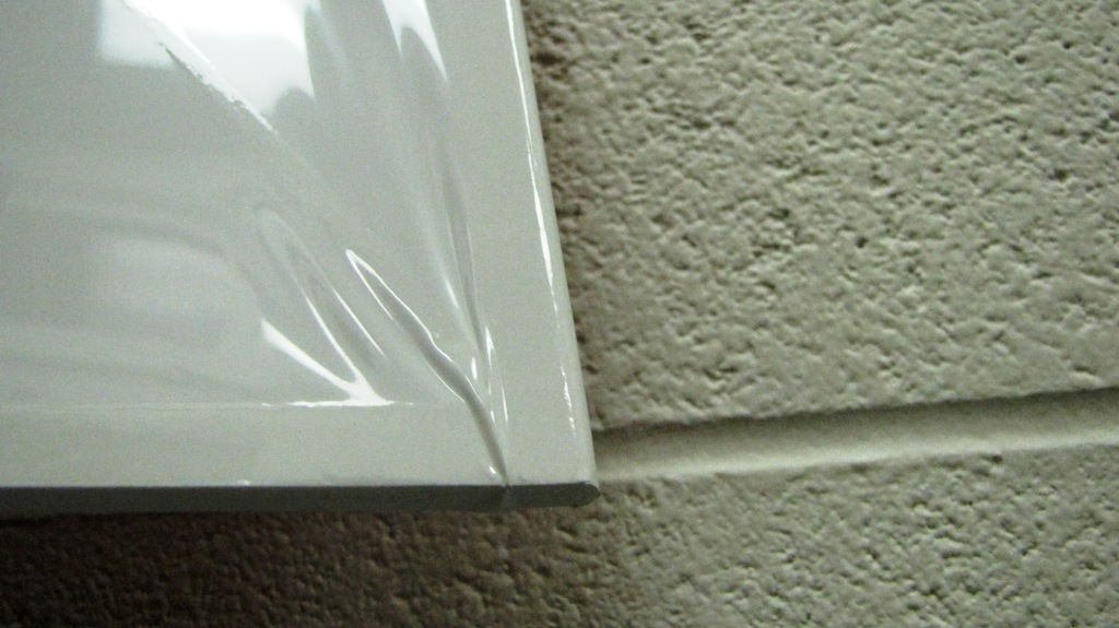

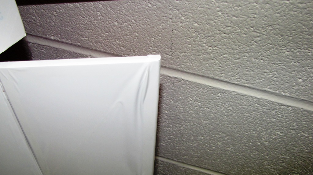

I have attached a couple of pics that show the engine mounted and the wrinkles/folds in the aileron covering.

I'm about 25% over powered. I have attached a couple of pics that show the engine mounted and the wrinkles/folds in the aileron covering.

My Twist's covering was also a bit wrinkled, but that was cured by 15 minutes with a heat gun and covering mitt.
