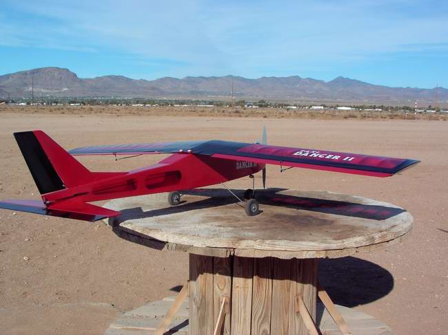

This is how you get a high wing trainer even with a flat bottomed wing to Emulate the neutral roll stability of well trimmed low wing pattern plane:
John

Jeez, John, what did you do, mount that wing upside-down?

It must have been my nightly tablespoon of Geritol when I glued the dihdral brace in upside down

John Buckner: Love the anhedral on your trainer. I've been pushing anhedral on high wing planes for years.
Indeed and it works so well, I cringe when the fellows go to all of the trouble of flattening the wing on shoulder wing or cabin type knowing they are only half way there. Your sticks are certainly a 'cut above' the ordinary and mundane. Pun intended
The only downside for the fellows who are not afraid to take a hack saw to wing is for the first flights you must keep the airplane in a tighter box simply because especialy with the high wing trainer the visual configuration cues are so different that it easy to get confused at first. Also its very easy to during inverted flight to forget you are in fact upside down.
John

Aren't these wings ANHEDRAL? Adverse of Dihedral
I've often thought of how a plane would fly with anhedral, but was never brave enough to try. But I guess it can't be much different than flying thin profile a fully symmetrical wing, which I fly all the time with my patten planes.

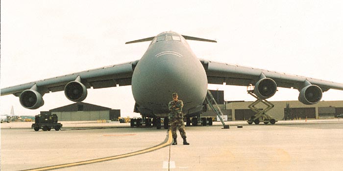

Well, I didn't build this one but...
Someone once told us that the fuel system on a C-5 would allow it to fly inverted. One of the guys asked "How long can it fly upside down?" The reply was, "All the way to the crash site"

I guess there are no really ugly airplanes (Warthog?) but that one comes close. (the one in MinnFlyer's post)
