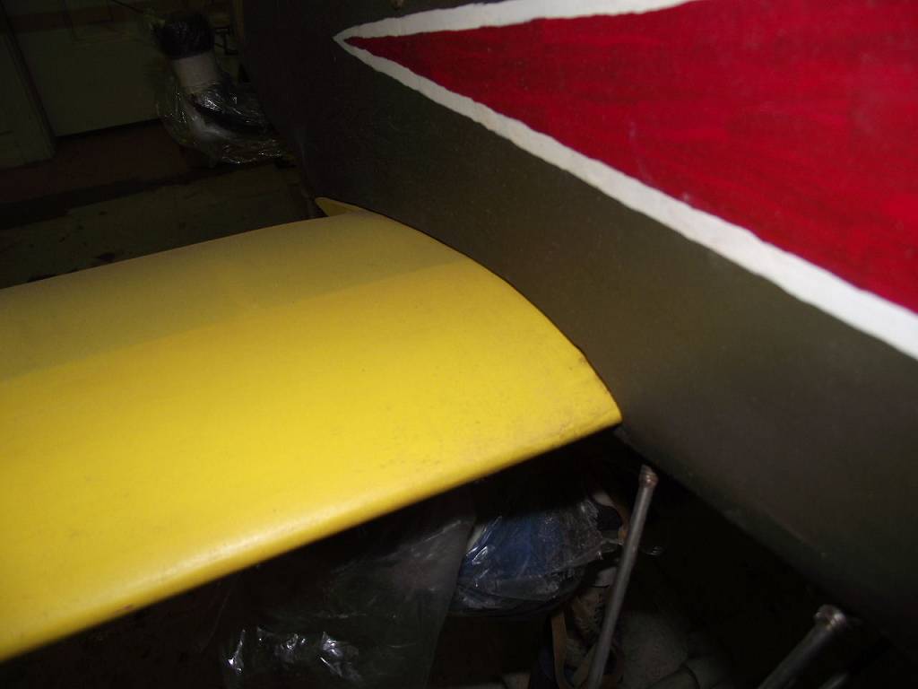

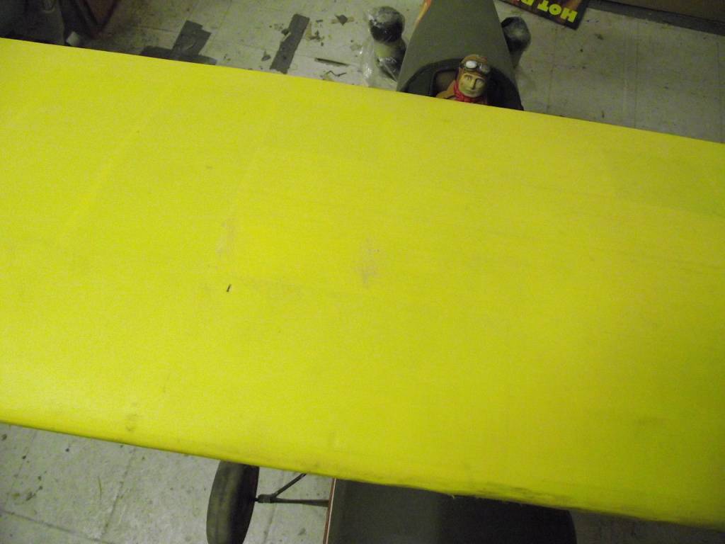

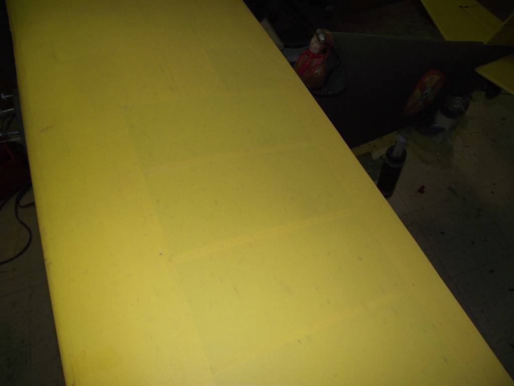

Don't know if it will show up in the photos but I was trying to show what happens without the clear coat. I flew this plane for a few years with a glow engine then a gasser. It really isn't all that bad but the clear coat makes clean up easier and doesn't allow staining.
