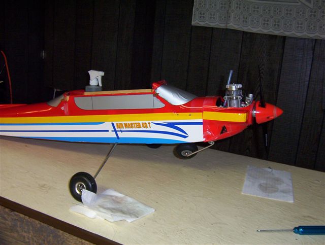

Well this seems to be the never ending saga of my now faithful(questionable ) airmaster 40t. I had 3 good flights then on the 4th the engine quit right on takeoff. before this the instuctor had to readjust the needle 7-8 clicks which he told me was odd. The plane landed in a nearby field. It looked like the nosewheel came off but instead it got squashed. Ill let the pics tell the rest.
I want to fix up the plane and then convert it into a tailgragger. I need some how to?

If you are still learning, I'd suggest fixing the nose wheel. It will save a lot of props when you are learning landings.
If you really want to convert, you need to do two things. 1) move the mains in front of the CG and 2) install a tailwheel bracket and wheel. You can get tailwheels and brackets made from many vendors. There are many different styles but something simple like this
http://www2.towerhobbies.com/cgi-bin...?&I=LXD850&P=0
would work. It would require cutting into the rudder to install the steering shaft.
As for the mains, I would move them in front of the CG as far as they are behind it now, probably about an inch or so.
If possible, I'd suggest finding some one locally who is experienced to help you with the mods, or at the very least, have them check your work.

I find it "odd" that he had to adjust the needle valve 7 or 8 clicks myself. If it quit right after take off, I'm guessing that he "adjusted" it until it was WAY too lean.
I tend to agree with monkeyboy. It would be easier to fix or replace the nose wheel. I would remove it from the plane and try to straighten it. If you can't, a replacement won't cost much.
To convert to a tail dragger, you'll need to buy some type of aluminum main landing gear, possibly axles, and a tail wheel assembly. If you get a 'dural' type gear, you'll also need blind nuts and bolts. Then you'll need to reinforce inside the fuse ahead of the wing with plywood and triangle (or square) stock, and probably the rear of the fuse with plywood.
It can be done, and isn't all that difficult, but re-doing the nose wheel is easier in the long run.

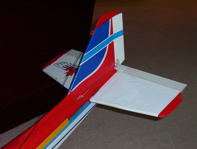

Can i not connect a pushrod to the tailwheel rather then cutting into the rudder. This pushrod would be fitted onto the rudder servo?

No, I learned on a tail dragger and I only broke one prop and that was because my instructor did a bad landing you have to stick the tail wheel stearing rod into the rudder if you go to hobby hobby www.hobbyhobby.com is their site with your plane and all they will help you out just tell them what you want to do and they will tell you how and what you need!

Learn how to fly thats what is important not whether the plane is a taildragger or trike. Your plane was damaged due to a flame out. replace the nose gear and continue learning. Make it into a taildragger after you have mastered it in its "stock" configuration.
