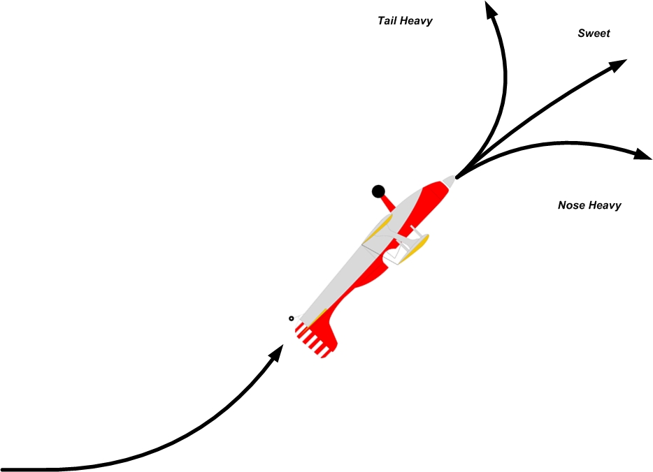

ORIGINAL: jetmech05
...CG on any airplane is best checked in flight doing the 45 deg upline full throttle thumb off the elevator trick...
~Noah

Apicture is worth 1000, em, uh, things? Noah - do ya need a detailed description?
I guess the good news is that I can recover the Hog Bipe. New scheme in the pic.

SeamusG,
The picture says a lot. Very similar to the dive test. Nice scheme, and yes Bill Cosby is a funny guy!! I thoroughly enjoy the act he did about the cake for breakfast. Cake has eggs, milk and wheat, all things that make a well balanced breakfast...
~Noah
