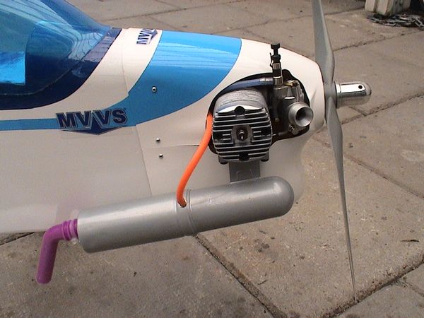

I have the 90 ARF You Can Do that I just built. This is the problem I’m having. I built the plane just as the instruction said. I am installing the O S 75 engine. Keep in mind that on this plane the engine must go upside down. When I put the engine on the stand it runs fine but in the plane it seems that it floods out and there is fuel dripping from the carburetor. What is my problem? Thanks everyone in advance.
Very common problem with inverted mounts if the fuel drips and syphons there is only one solution Lower the Tank as already has been noted. The same relative tank center/carb jet relationship must be maintained with an upright or an inverted mount or there will be runing problems.

This is a very very common problem and it is unique to UCD and like designs. For example my Phoenix Topstar which is just like the UCD. I too mounted a 75ax inverted on it. What followed was a full season of engine problems, frustration, deadstick landings etc. Keep in mind these are 3D airplanes and I wanted to hover while it wouldnt even run for 2 mins no matter what we did.
Finally, I got frustrated and swapped the 75 for a FS91SI- my first 4c much against the warnings of my fellow fliers. That however was not the clincher. When I installed the 91, I sealed off the stock firewall hole and made a new one lower so that the tank centreline was in line with the carb spray bar. I changed absolutely nothing else. That did the trick. Over the last season the Topstar was the only reliably running airplane I have and even after having several near crashes (trying to do spectacular things with the new found relaibility) it still is.
Drop the tank lower, you will enjoy this airplane
Ameyam
Fuel tank height... yeah right...
The U-Can-Do does not mount the tank high enough to cause problems once the engine is running.
However when the engine is sitting on the ground fuel CAN siphon into the cylinder head flooding the glow plug and making the plane hard to start or causing hydro-lock.
You want to do the following
- You can leave the tank as it comes... remember this plane was designed for an inverted setup...
- Keep your tubing as short as possible.
- Start the plane upside down, with a heavier APC prop on it. Lean the idle as much as you can while still maintaining a reliable idle.
- Now when you start the plane normally, DO NOT prime the engine, cut fuel flow to the carb when fueling.
- Use a longer plug if possible to keep the element out of any fuel that will pool.
- Akways keep the throttle at idle cut or block flow, when the plane is sitting on the ground, UNTIL you are going to start the engine.
- Double check the idle setting with the plane upright and engine running, you want only a slight drop in RPM's at idle after a .5 sec pinch.
Do this and you'll get reliable and consistent starts and runs.

Sorry oppose I must disagree.
Any airplane that you cannot fill the tank up sitting on its gear and supposedly designed for an inverted engine, and have the fuel come flowing out the venturi is indeed a design flaw and very poorly done.
I don,t care who's name is on the label, cheezy no name arfs or the majors, there are plenty of examples of both.
This is the beginners forum lets keep this in context the reccomendation to start the airplane upside down, is dangerous and only just looking for trouble especially with folks that are relitively inexperianced. They will not even be able to sit the thing down while running without a makeshift stand or have someone hold it while some one else starts..
Fix the Problem Lower the Tank!

Yes we do disagree....
As I've said so often, fuel tank height is only an issue with siphoning.
Typical difference in height when inverting an engine is less than 1/2" on a U-Can-Do, which has absolutely no meaning in terms of pressure differentials.
Fuel weight is not an issue either given the small offset.
I can and have demonstrated this to disbelievers by putting engines on test stands and moving the tank height around.
Not till the tank height difference is QUITE substantial ( typically well over 10+ inches or more ) are there any effects on the engine.
Or engines would not be capable of running upside down, or stay flying on uplines otherwise when the effective differential is often close to those levels.
As far as upside down starting in a beginners forum.
Many of the "more experienced" set have recommended this here in the beginners forum to newbies who report inability to start an inverted engine.
It may not be the best solution, but for a grossly out of tune engine that cannot be started inverted, it permits the user to get the plane running and start tuning the engine. Once started they can flip it upright.
Ideally the plane should be on some sort of safety support but that's another matter.
The solution to problems running inverted engines is not "tank height" issues, it's to fix the OTHER setup or starting errors.

You were working with an out of tune, not run in, AX 75 and some unknown problems.
You cured things by switching to the FS91 ( which I'll bet had been previously used ).
I've fixed dozens of such problems for people who claimed the same issue w/o ever moving the tank.
Typically, pressurization, leaks, tuning, etc. is to blame.
On close to 30 of my own planes, I've never ever resorted to moving the tank no matter the differential.
Tank height did not cure your problems, something else you fixed along the way did.
I run both of those engines inverted on different planes w/o any problems what-so-ever, even though the tank height difference is greater than your U-Can-Do.
Tank height affects pre-start SIPHONING. That - IS - a problem if you do not preflight properly as I indicated above.
The whole point is not after the engine is running, Its before its running, I suppose you are going to attempt fuel the airplane upside down too?
To have this problem and not fix it when its so simple is just nonsense. To be someone who is supposidly a designer and designs in this problem is anal in the extreme for the majority of sport airplanes.
You can post an repeat yourself all you want it does not make the practice of being required to start a typical sport airplane upside down any less dangerous or completely pointless when the problem is so easily fixed in most cases.
To the original poster if you are still there fix the problem, lower the tank and forget it.

The airplane is sitting there on its wheels and you dicide to go over and BS with the boys a bit. Well heck great conversation but it starting to get hot so ya,ll get on back to you own pit so ya can go flying.
You pull out the trusty starter, push the button and Bang! That prop is locked up solid and you may have even damged you engine (usually a bent connecting rod).
Whoa you say it was not leaking when You filled it! Yup but that cool fuel after heating up in the sun has expanded and started a syphon despite the band aid fix (fuel line loop). Now if the prop just happens to be in the right position this syphoning fuel can now flow right through one of the transfer ports and completely fill the combustion chamber with non compresable fluid (fuel). You come along and hit it with a starter, bang goes the weasel.
Operation of an inverted installation even one with the proper fuel tank center/carb jet relationship carries many additional. procedure that you will be required to learn and practice without fail to be successful.
Actually Jaka presented an excellent idea earlier in this thread with the suggestion for a sideways mounting which raises the carbs to eliminate most of these problems. However I understand that most are not going to be willing to do this especially with an ARF. So the most practical thing I highly reccommend for anyone with a tank mounted to high is to simply lower the tank. This even if it requires a little surgery.
If you are completely new get on of the old timers in your club to help you with this most are most willing to help for only just the asking.
John
