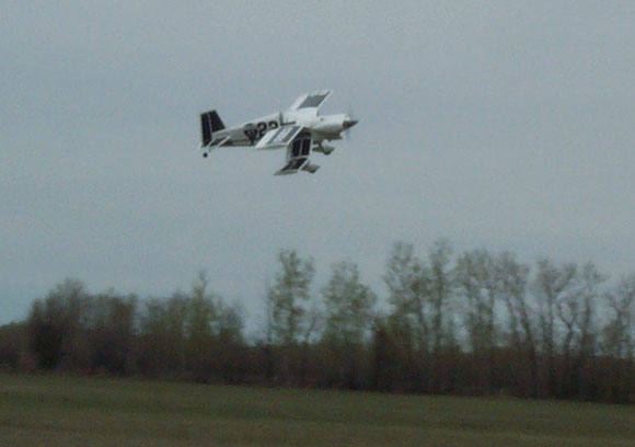

ORIGINAL: goirish
I like to fly SLOW[b][/b][X(][X(][X(]
We had a Cobra at our annual IMAAFly-In a few years ago with, as Irecall, a twin 300 Saito. It was the next fastest thing to a jet! This is a model of a full-scale racing biplane. Not the best choice for a leisurely fun biplane.
The pilot did give it rave reviews as a nice handling model, however. He was knife-edging and stunting it beautifully.
