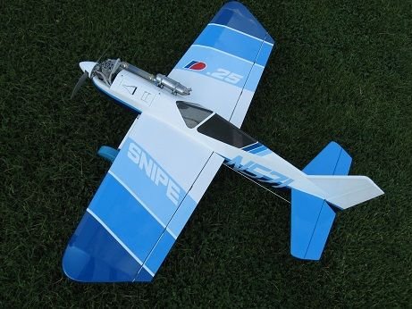

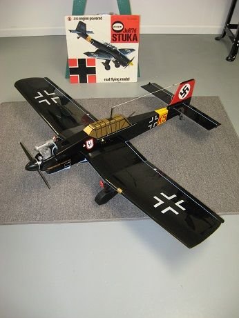

Having used Monokote and Ultracote/Oracover, I prefer Monokote. So far, the only color that's difficult to stretch is a 30 year old roll of Dove Gray - it has the black and white photo instruction sheet with a guy in shirt and tie.
Ultracote doesn't stick well to itself, doesn't trim as well as Monokote (the adhesive layer separates from the pigment during cuts), it has a smaller color selection, isn't as glossy, and creases can't be removed with heat. Also has no metallic or flats.
Covering, graphics, and trim are all Top Flite Monokote on these airplanes: >>>
Disappointed with Forest Green going away.
