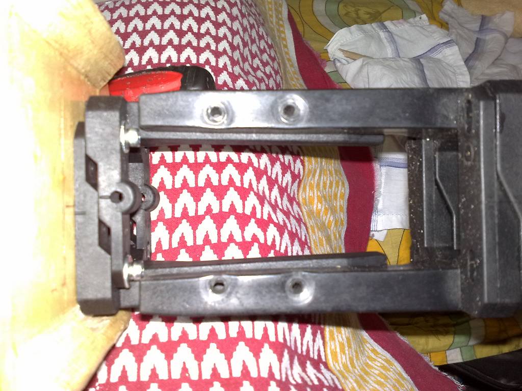

1) Trying to install a DLE20 on a GP 90-120 adjustable mount. Its about 2mm too narrow and a larger mount will require surgery on the firewall. Cant make it wider because that would require to drill out the interlocking tabs on the back of the mount, so it wouldnt be secure enough. Should I simply grind / sand 2mm each side off the beams? The mounting holes seem to be further inside the beam so that wouldnt be an issue. Will the mount retain sufficient strength after this?

What are the other options I have regarding the pushrods, Tim? Look at the picture, the horn just about projects out of the servo plate. I dont think the stock futaba 4-armed servo arm has the strength after the outermost hole has been drilled out to 4-40 size.
With the engine mount, its not that simple. The fuse has 4 hardwood blocks pasted on the inside of the firewall onto which the blind nuts hold. When I was setting up for gas, I fibreglassed over these. I can probably remove them with a dremel. Issue is the difference in mounting dimensions between the 180 mount and the 120 mount is so small, I will end up with an oval hole or slot rather than a new hole. Another point is once I fill the old hole and try to drill a new one, I will be drilling on the glue line which will cause the drill to meander either side of the glue line even with a steady hand as the glue will be harder than the wood
I am attaching a couple of pics with the stock mount temporarily installed at the widest and the DLE20 proven mount held over for comparison- its just 2mm each side. I may also not need to grind the entire beam, jut the interfering bit. In the second pic, I just made a couple of dents using the dle mount as a guide, dont know whether you can see them. I think they are well inside the beam

as for the mount, your better off making the mounting holes to the firewall larger, than shaving any material off the beams
if you can not move the mounting bolt locations,make sure if you open up the holes in the back of the mount you use a larger washer to spread the load since the bolt pattern will be more narrow
