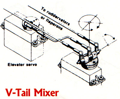

Ok so the wing I'm gonna build that I've seen has two servos one for each side if the wing..
My question is if it is running on two different servos for each side how would u move them both at one time u know to elevate?
Im guessing each servo runs on a separate channel. I'm kinda doin this from spare car and heli parts. So how do I have both servos move same time in the same direction if they are running on separate channels.

you will need a computer radio that will allow you to program an "elevon" mix. Once the mix is programmed properly, the computer in the Tx will move the ailerons in opposite directions when you move the stick left / right and will move them together when the stick is moved up and down. Good luck to you, you have chosen a difficult build for your first plane, but you are in the right place to ask questions!
In a flying wing that uses two control surfaces a separate servo is used for each and these are plugged to separate channels on your rx.
A radio system (transmitter) must be used that has 'Elevo function' and this mix must be enabled to have both elevator and ailerons functions.
Years ago the normal method was to mount one servo on a slider and it was in turn moved by the second servo. One of those was plugged to the elevator and the other to the ailerons.

If your radio does not have an ailevator/flying wingtype mix built in you could be up against some VERY difficult initial trim flights trying to get things set up properly. The ailerons have to be mixed to serve both as ailerons and elevator, and rudder if it is a true flying wing with no vertical stab.

You could use on of these (or similar) v-tail mixers on your "elevons". I think long ago they also use to sell a mechanical device to do the same thing, see pic below.
http://www3.towerhobbies.com/cgi-bin/wti0001p?&I=LXHHS3
