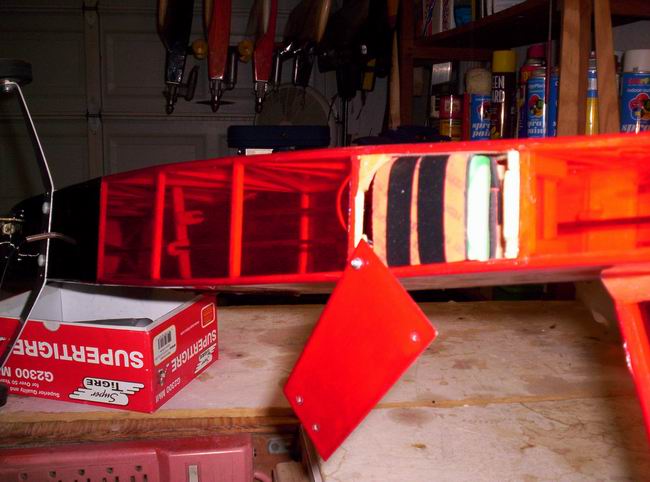

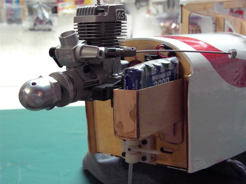

Here is photo today of an installation with one of my weightboxs Have used them on many different types, this one happens to be a larger airplane but the idea is the same. And I do use lead shot from a local gun shop. Which makes things reversable if you choose to just tape seal the box for the intial flights.
For a great many situations as yours with the trainer or any other ship of that size I have taken to using the same weight box idea on rather than lead I size the box to fit the flight battery and avoid the additional weight altogether, have done this on perhaps the last ten ships which have required forward weight. The battery being forward will greatly improve your forward need for weight over the typical position at the behind the #1 bulkhead (leading edge of the wing or even under the tank).
I have done some comparison tests using my Hitec telemetry sensors and the forward position if the cowling inlet and outlet design are properly laid out the battery actually runs cooler tuck up below or alongside the engine just behind the prop.
Some have expressed concerns about vibration isolation also but it seems the boxs provide all the isolation needed.
John
