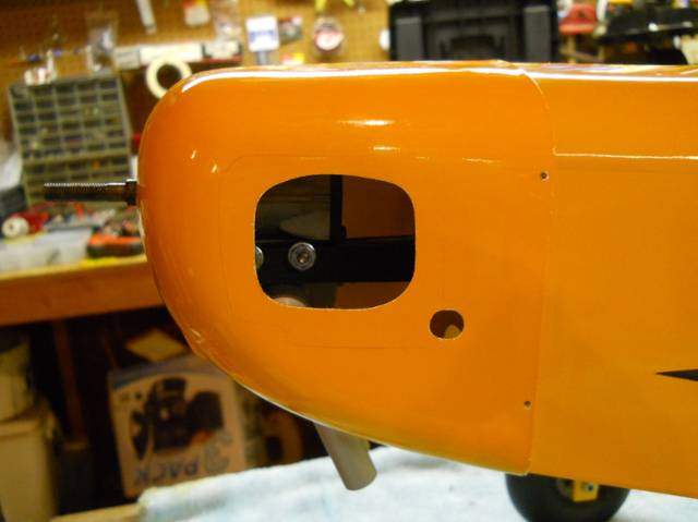

Excellent job on the engine and cowl installation!!! That gets my "seal of approval", for what ever that's worth
. Look at several J-3 Cub cowls from the head on view and you will see most have three openings just below the spinner. The top one is the widest and is a horizontal slot, below that is another horizontal slot less wide that the top one, and below that is a square or rectangular oil cooler opening that will be in that raised area near the bottom front of your cowl. Some don't have the oil cooler bump but yours does. After laying out how you want to do these, cut them open so air can enter the cowl for a little additional cooling. The unused muffler tunnel plus the area around the exhaust pipes will allow plenty of air exit from the cowl. General rule of thumb is to have twice as much exit area as intake area for air flow cooling. you have plenty. This will also give a more correct scale look to your cowl. You have a nice looking plane going there. As to the fuel tank fueling; has the tank been assembled yet? There is a 2 fuel line system and a 3 line fuel system. The 2 line would use a accessory fuel valve (Dubro or Great Planes) that would be mounted somewhere on the cowl like the side or the bottom and it consists of a spring loaded valve with hose fittings inside the cowl to the tank on one end and to the engine on the other end. A metal fueling nozzel for the end of your fuel pump hose is supplied with the valve assy. They work nice when they are new but will stick open when they have a couple of years on them and will require replacement. The 3 line system has an extra line going into the tank and will require a "fuel dot", also to be mounted on the cowl. The fuel dot is just a nice finished looking spot to mount an exit spot for the extra fuel line and will have a nice machined plug for the end of the fuel line plug. 3 line with a fuel dot will be cheaper @ $4-$6, and the fuel valve will be about $12-$13. Both available from your hobby store. Some just let the extra fuel line hang out the bottom of the engine bay and plug it with an old screw. YUCK, YUCK, looks non scale and sloppy, but that's just me again! The dangling line with the old screw plug works but come on you can do better, Go with a nice fuel dot or fueling valve.
. Look at several J-3 Cub cowls from the head on view and you will see most have three openings just below the spinner. The top one is the widest and is a horizontal slot, below that is another horizontal slot less wide that the top one, and below that is a square or rectangular oil cooler opening that will be in that raised area near the bottom front of your cowl. Some don't have the oil cooler bump but yours does. After laying out how you want to do these, cut them open so air can enter the cowl for a little additional cooling. The unused muffler tunnel plus the area around the exhaust pipes will allow plenty of air exit from the cowl. General rule of thumb is to have twice as much exit area as intake area for air flow cooling. you have plenty. This will also give a more correct scale look to your cowl. You have a nice looking plane going there. As to the fuel tank fueling; has the tank been assembled yet? There is a 2 fuel line system and a 3 line fuel system. The 2 line would use a accessory fuel valve (Dubro or Great Planes) that would be mounted somewhere on the cowl like the side or the bottom and it consists of a spring loaded valve with hose fittings inside the cowl to the tank on one end and to the engine on the other end. A metal fueling nozzel for the end of your fuel pump hose is supplied with the valve assy. They work nice when they are new but will stick open when they have a couple of years on them and will require replacement. The 3 line system has an extra line going into the tank and will require a "fuel dot", also to be mounted on the cowl. The fuel dot is just a nice finished looking spot to mount an exit spot for the extra fuel line and will have a nice machined plug for the end of the fuel line plug. 3 line with a fuel dot will be cheaper @ $4-$6, and the fuel valve will be about $12-$13. Both available from your hobby store. Some just let the extra fuel line hang out the bottom of the engine bay and plug it with an old screw. YUCK, YUCK, looks non scale and sloppy, but that's just me again! The dangling line with the old screw plug works but come on you can do better, Go with a nice fuel dot or fueling valve.I also just ordered some fuel dots for the parts bin. You never know when a guy might need a valve or a dot.

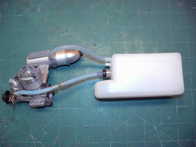

DR concerning the fueling valves, I tend to classify them with power panels. Just a complete waste of money and most certainly at least one lost flying day eventually fiddling with the engine when they start to leak and causing mystery running problems. I do on occasion acquire some on buy outs and such but immediately send them to the bin. I would not even give them away to friends simply because that's no way to treat a friend.
The three line systems with a fuel dot is probably the most popular way to fuel but I prefer the much simpler two line system (cowling or not makes no difference) with a simple split in the carb line where its convienent and a short piece tube to connect. fueling from here is the simplest and most convienent of all and least trouble prone.
I have pictures of many many different types of airplanes with and without cowls to illustrate this simple technique. Try searching on fuel valve or fueling you will most likely run across some of them.

The dots are sounding more like what I will use. The valve I have is well built from machined aluminum and kinda pricey as well but the dot is looking better to me. I'm not worried so much about fuel leaking because I can see that if it happens. What I worry most about is the valve sucking air and causing the engine to not be trust worthy. I assume where you push the valve in to fuel it there must be a ball check valve of some sorts. If the spring gets weak or a micro piece of trash gets in the valve then trouble could arise. Looks like to me if I use a dot and the dot is secured in the line and all the line connections are clamped good then I would have a secure positive sealed fuel system.? Tell me if this makes any sense as I'm in a learning curve on this. I need this plane to be as well prepared as possible because I don't handle dead sticks well.

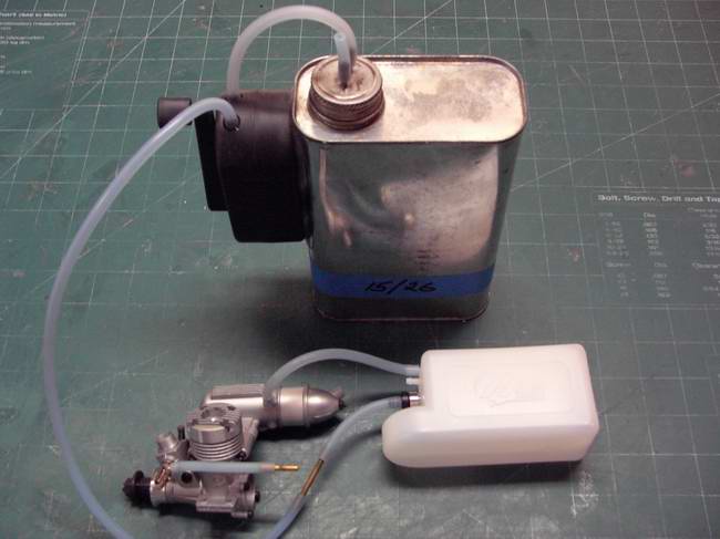

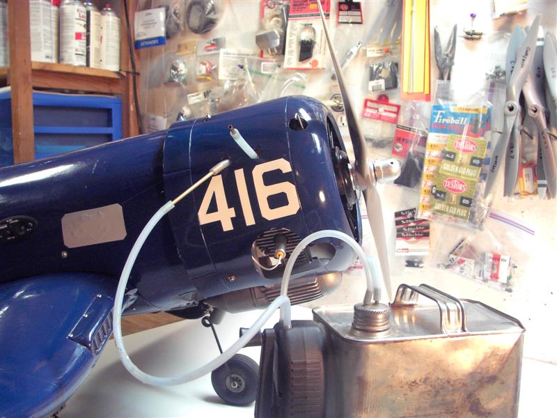

These two pictures illustrate The same two line system I use for virtually every airplane with some exceptions (there are always exceptions). It is physically impossible for fuel to be forced anywhere near the carb or to flood it.
I don,t buy expensive fuel valves or ever recommend them to the folks I mentor I also never lose flying time to leaky valves or special fitting on the fuel pump that just happens to be on the can at home.
I also never use fuel dots or lose flying time looking for lost fuel dots in the sand, something I often see the fellows doing on any busy weekend. I never have to punch that third hole in the fuel tanks of every new airplane.
And best of all the most reliable system of all (of course just my opinion), the two line system with a split absolutely never cost anything.
John

Yes, but isn't it still going to flood the engine while your pumping it? True the needle valve will restrict the amount past the N.V. but with out turning the needle valve in all the way to shut it off during fueling some fuel must still enter the carb barrel. Is it so small an amount that it doesn't matter? Have you tried this and it works without flooding, cause if it does work it sounds like a good idea. I may bench test this on my engine test stand where I can easily see whats happening with everything. Next time I run an engine I'll give it a go.
#60
OK John, I was typing as you were posting the 2 photos. I thought you were using a tee fitting with one line going outside the cowl for external fueling access. All you show there is the same simple system that every open cowl upright engine trainer uses. Just unplug the carb line at the carb and pump fuel till it comes out the vent line. If the engine is in an enclosed cowl you don't have access to the fuel line unless you loop it outside the cowl somewhere. How do you do this with an enclosed engine??
#61
Larry look at the pictures I just posted above Its impossible to flood the carb and its just like every other two line glow powered trainer that has ever taken to the skys.
The only difference is you just not pulling the line off at the carb instead you just inserting the fuel pump line a little further up the carb line in the split 'fueling toward the tank not the carb'.
Its so simple, so reliable, so easy and so cheap that folks have trouble understanding. Its always a lot of verbal struggle especially for some who are not new flyers but no one who I have introduced this to has ever gone back to either the valves or the dots.
John

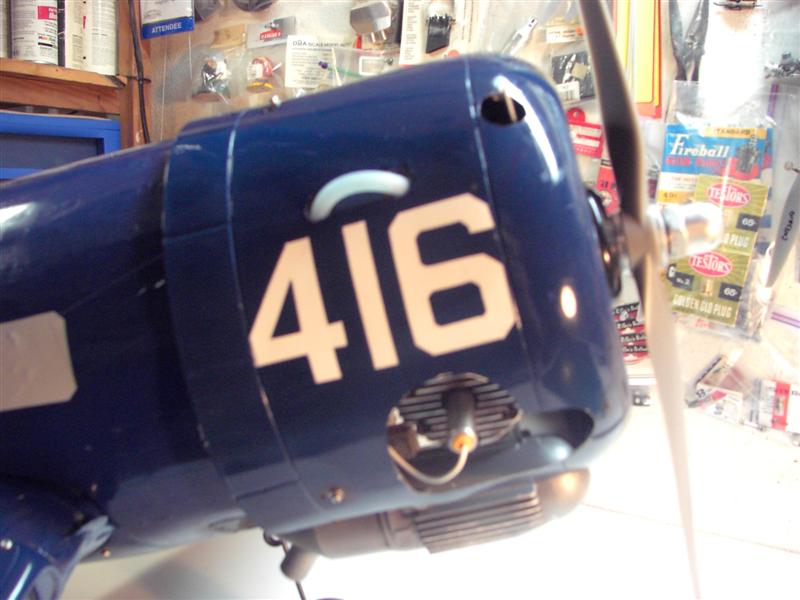

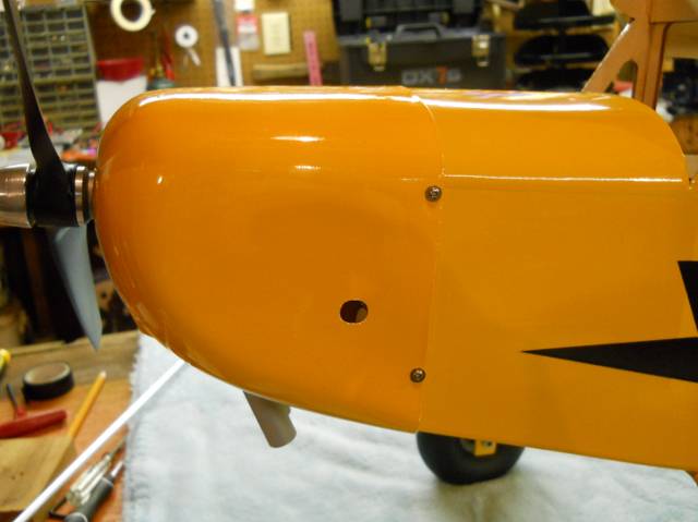

OK had photos of four wildly different types of cowl all using the same system posted but the system here disallows all but two at a time anyway I am done with that no point for me to waste any further time.

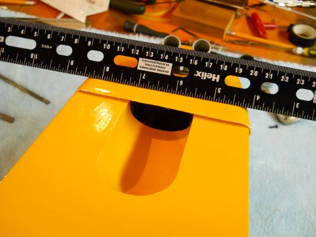

daddyrabbit I would like to approach something else concerning your airplane that has bothered me since you posted the last photos of the J-3.
Only the cylinder head is exposed outside the cowl in the high engery air. But since you have no inlet air and very little outlet air in the covered over tunnel and the very tightly cut outlet around the exhaust at the bottom.
I beleve this will cause relitively stanant air within the cowl and even around the lower cylinder cooling fins. I think there is a good chance that you may have running problems from cronic overheating. Unless you open up that bottom cowl outlet and allow some air inlet Otherwise it just becomes an oven inside.
I think an awfull lot of the running problems some fellows go through is just simply the refusal to let those cowls breath a little more.
John

I suggested additional front cooling openings back on post #49. I thought the combination of the open muffler tunnel (it is open unless the O.P. has covered it) and the exhaust exit hole would be enough but it wouldn't hurt to open up the exhaust cut out in the bottom of the cowl. It won't be seen even in the air and in addition to helping the hot air exit the cowl it will make it easier to take the cowl on and off. I often make that a "U" shaped cut out with the back of the open area all the way to the back edge of the cowl (no connecting "bridge " across the back of the opening"). It doesn't seem to weaken the cowl as the mounting points are on the sides. As John points out, cooling air flow is important to the proper operation and longevity of the engine. So after looking a several example Cub cowls, make the intake slots and oil cooler hole as big as you can and still look "right", then do open up the bottom air exit area some just to make sure. P.S. I told you John and I disagree on fueling valves!

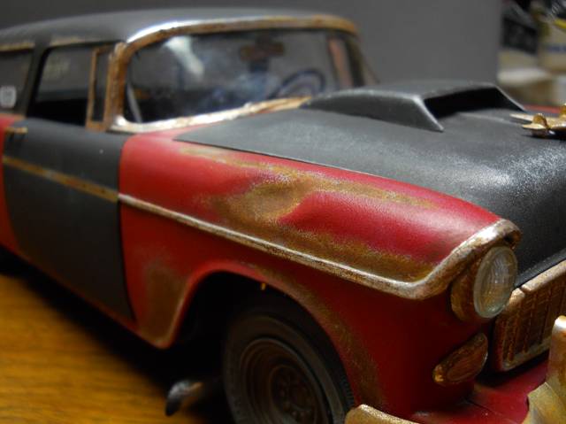

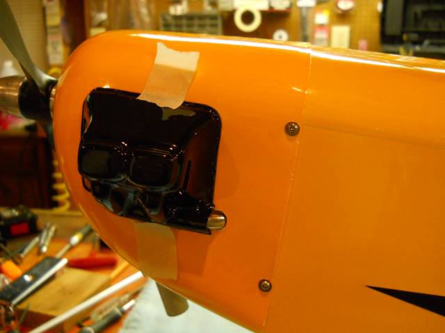

John, I'm going to open up some air vents on the front of the cowl as Larry suggested before. I'm waiting on another OS 40 LA to arrive before I proceed with the vents. I'm into scale and detail big time on everything I do so with that said I plan on somehow taking the head from the incoming 40 and mounting it on the other side of the cowl to make a true looking twin cylinder.
I've built models and dioramas for years and I think that's why I'm so detailed about anything I build. Here's a 1/25 model I built recently. Its mostly scratch built except the tub and wheels. Grannies rocking chair on the back of the truck is only 1 1/2 inches tall and it took almost a day to scratch build that rocker.
1/16 Nomad drag beater

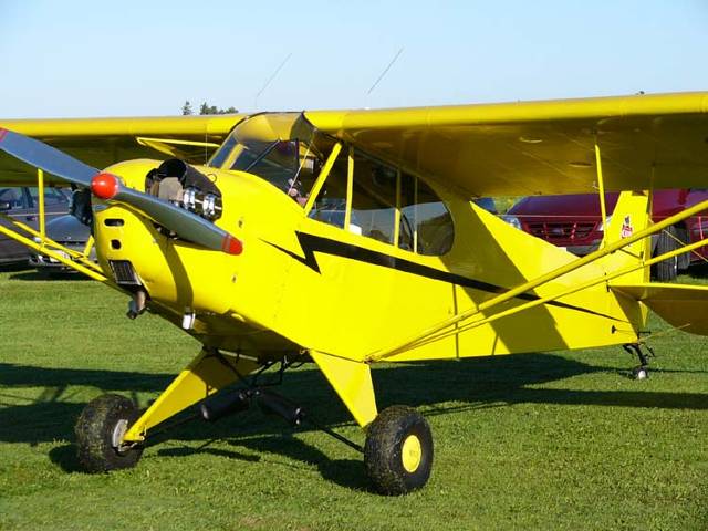

DR I love your Jed Clampit diorama beautiful work. And yup Larry we are both in total agreement about the cooling arraignment of DR's Cub.
DR its going to be just about impossible to configure your airplane like the pic of the full scale airplane and here is why and I am quite familiar with J-3's having owned two of them at different times in the past. One a J-3c65 and the other a J-3c-75: If you look at your photo you can see both the upper and lower cowl halves taper from the firewall to a rather narrow wedge at the propeller to just wide enough for the crank case. Above the cylinders are eyebrow baffles which are intended to deflect high energy air down between the cylinders. The were also intercylinder baffles but for our purposes those are out of sight and mind.
Now take a close look the cowl of your cub. Almost no taper and in fact its as if the designer was actually trying to make the cowl like a PA-11, PA-18 Super cub and of course these full scale cubs did have conventional fully enclosed pressure cowl. DR you will have a bake oven there unless you open some high energy air from the front I now cheek openings will not be scale. Well I have seen far to many beautiful scale airplane live very short lives simply because their builder/owners would not cut their pretty cowls for anything even cooling. Yes of course the tunnel will let out some air but no where enough.. In most cases were the tunnel were being used the cowl would be cut away a considerable amount for the muffler. However no matter how much outlet you provide it all comes to naught if there is no high energy inlet(s) .
My recommendation for that airplane and that cowl would be cut away a lot more outlet at the bottom and provide reasonable sized cheek inlelts up front scale fidelity can go be hanged cooling is far, far more important if the airplane is actually intended to be flown.
John

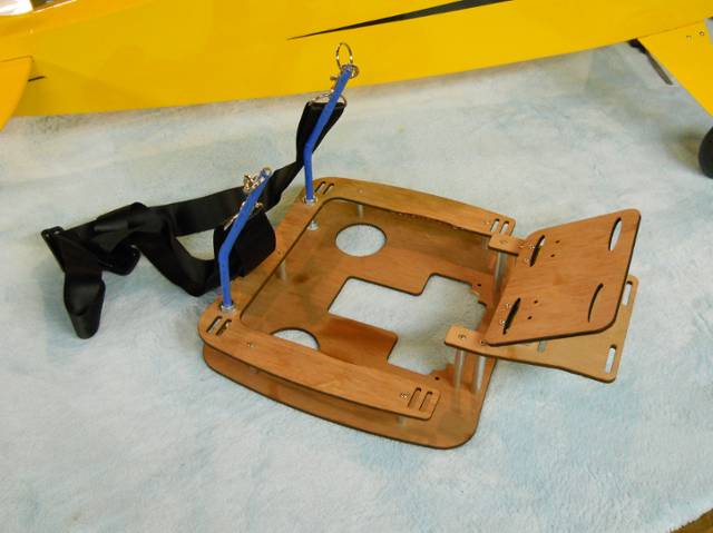

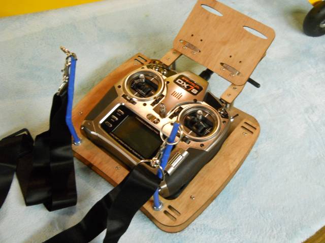

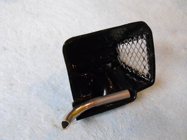

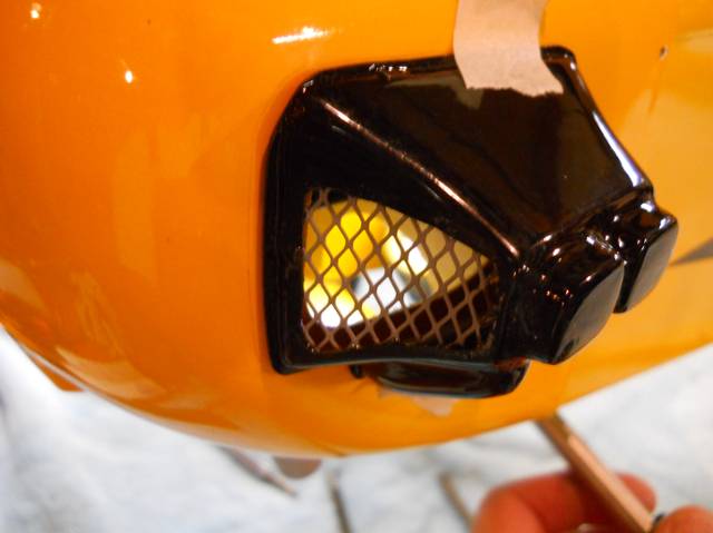

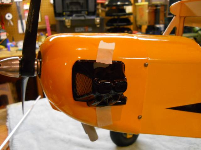

I got a little done on the cub today. Since scale is out the window I'm just going more for function and try to keep it as clean as possible. I decided on how I would get air flow to the engine. I used the fake engine and added a vent to the front of it as well as an exhaust tube to make it look a little better. After I get this installed I'm going to anchor the plane and get some numbers on the engine heat before I cut anymore. I think the exhaust tunnel will be enough outlet. If not the laser thermometer will tell me.
I threw together a sweet little custom transmitter tray today while glue was drying on the cowl vent. It balances perfect with the DX7.
