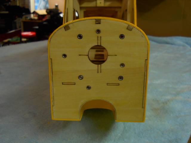

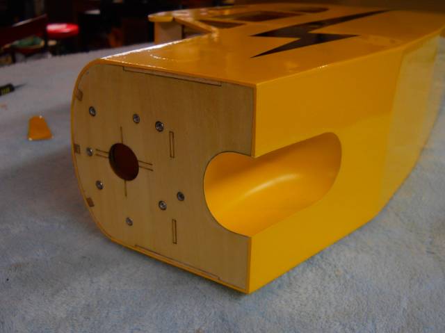

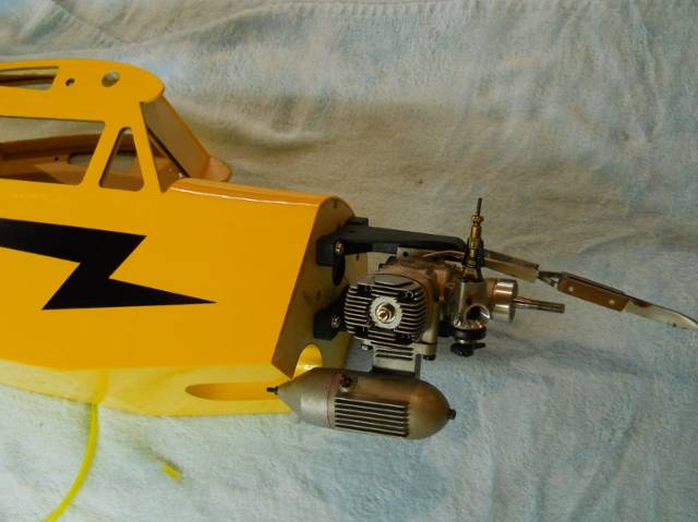

Larry, Is this what you meant when you were talking about an exhaust tunnel? If so then mine looks like it has one already built in.
ID:	1947759   Click image for larger version

Yes, yes that is an exhaust tunnel. I hope larry won,t mind me answering Something not often provided these days Using a two stroke glow engine the cylinder is rotated down slightly from the 90 degree sideways mount until the stock muffler fits in that tunnel. This usually results in a cylinder position of 135 degrees.
I think I have just one airplane with a pitts muffler and all the rest I use in most cases the stock mufflers. As most do not have a tunnel these days its very simple to do you own and where you want it. Just dremel away a notch in the firewall as you see there a little I/16th balsa sheet water soaked and rolled then fitted in the slot a little thin ca. Your done. Most times I just paint with some thinned epoxie or if I am real lazy I just spread out some thin ca on the bare balsa for fuel proofing.
John

John covered it correctly. BTW, with that factory muffler tunnel that airplane is not a World Models Cub. It looks identical to one currently being sold on Ebay as a "no name" Cub ARF from a seller named "Lagola" out of Chicago, Illinois. He offers them at a buy it now price of $100.00 plus $23.70 shipping. Looks nice for the price, less than $125 to your door. Enjoy !!!

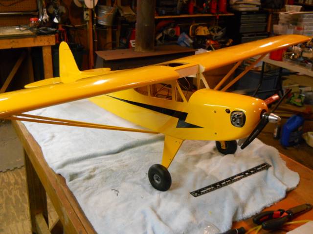

I bought this one from a friend who said he thought it was a world models but wasn't 100% sure. The manual doesn't say and there isn't a name on anything. I can say it's a very well built ARF with very nice bracing and glue work. I paid $85.00 for this one.
ID:	1947833   Click image for larger version

@$85 I would say "well bought"! The one in the E-bay photos looks like it has wheels that will be too small for flying off grass, so if you fly off grass go for larger diameter wheels (tires). Some 1/5 th scale cub wheels from Dubro would look and work good. Your plane @ 72" w.s. is a 1/6 th scale so the 1/5 th wheels will give it that "tundra tire" look that is nice on a Cub. Also IMHO, now that you have the Super Tiger 40 broken in and running well it should be the one to go into this Cub. The 40 LA is too wimpy to fly this plane . There is a big difference between a 40 LA and a 46 LA in power. The 46 is 20% stronger and would be fine but not the 40. Use that 40 LA somewhere else. The 40 Super Tiger will perform at least as strong as the 46 LA maybe better, so in a S.T. a 40 is ok. Looks like you did well in learning to tune a Super Tiger. One thing I do when flying one of my S.T. powered planes is to make sure the engine is well warmed up and the needle valve has a final readjustment just a little on the rich side before take off. This has helped to cut down on dead sticks. They will tend to lean out a little in the air and if you take off with a cold engine set a peak lean you will be making a dead stick landing. Warm it up and set it 1/2 turn rich just before take off. Retop the fuel if you think you burned a lot off.

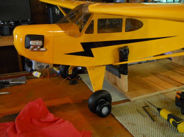

Larry, I'm going with the ST for sure. The ST is about as ready as It'll ever be. I wont have to put a landing gear together as I'm going to use the landing gear from the previous cub. I changed the factory wheels for some 3.75 Dubros as you can see in the pic. It still doesn't look like I want it to so I will most likely go even bigger with the wheels as well a going with a tail wheel that's just a hair bigger.

.....1234, What you have there looks good to me. If they are 3 3/4" dia. they are a touch larger than the 1/5 th scale ones I suggested. Dubro 1/5 th are about 3 1/2" and their 1/4 scale are 4 1/4" dia. Go with what you got, at least for starters.

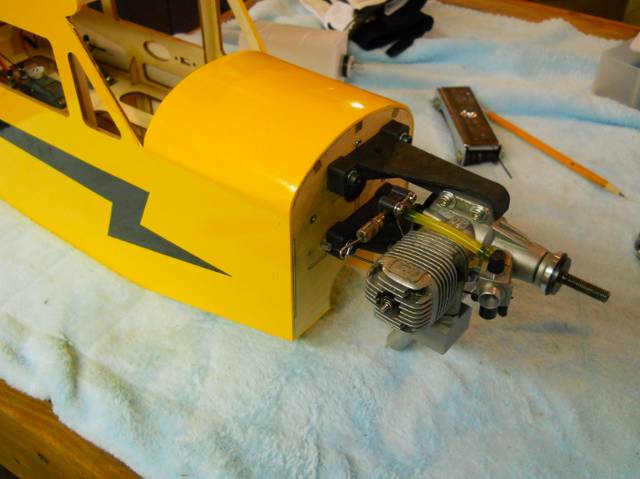

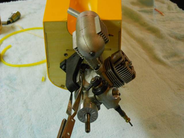

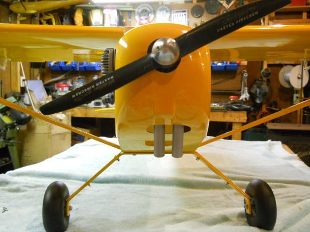

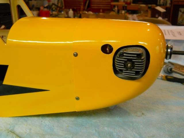

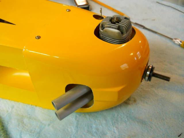

Larry, Is this how the engine needs to be mounted in order to use the stock exhaust?
ID:	1948547   Click image for larger version

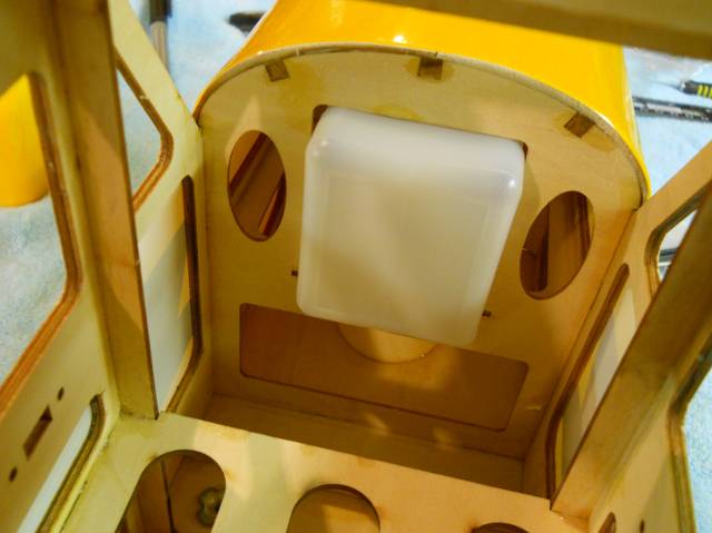

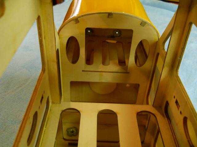

I've heard a lot of people say when you mount the fuel tank that it needs to be as close to the engine as possible. My tank will fit clean up against the fire wall with the fuel line level with the carb. Will this be adding to much weight to the nose of the plane? I've got plenty of room to slide it back if need be
ID:	1948551   Click image for larger version

Yes that is a 135 degree orientation and is pretty common method of running the muffler through a tunnel works great and will not cause syphons as the carb is sufficiently high.
Yes use the tank exactly as it is in your photos. Right up aginst the firewall sounds like you have a perfect tank to carb relationship. And no you will not be adding to much weight to the nose. Remember when you check and adjust the CG do so with the fuel tank empty.
John

Don't ever move a tank back to adjust CG unless it's a pumped setup.

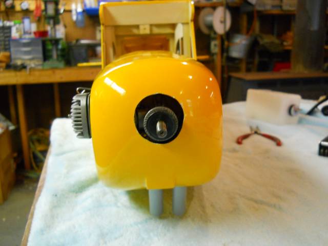

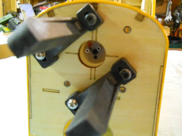

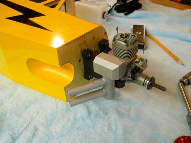

I got the OS .40 on the stand today and give her a run. After a few minutes I had it dialed in and it ran super all the way around. Since I had the new pitts muffler I just decided to put it in the cub. I know its not one of the stronger .40's but all I do is fly scale with long take off's and slow pattern flying so I think It'll do the job with a 10 x 6 prop. All I lack is the receiver switch and plumbing the fuel lines. The cowl turned out pretty good to be the first cowl I ever cut for a nitro. Heres a few pics.
Next question: I have no idea how to plumb the fuel tank so I wont have to take the cowl off to fuel. I could search what others have done but I don't trust everything on the web. I do trust Jester, John and Larry so you guys let me know how to plumb this system and I can finish this puppy up.
ID:	1949082   Click image for larger version
ID:	1949083   Click image for larger version
ID:	1949084   Click image for larger version
ID:	1949086   Click image for larger version
ID:	1949087   Click image for larger version
ID:	1949088   Click image for larger version

Excellent job on the engine and cowl installation!!! That gets my "seal of approval", for what ever that's worth. Look at several J-3 Cub cowls from the head on view and you will see most have three openings just below the spinner. The top one is the widest and is a horizontal slot, below that is another horizontal slot less wide that the top one, and below that is a square or rectangular oil cooler opening that will be in that raised area near the bottom front of your cowl. Some don't have the oil cooler bump but yours does. After laying out how you want to do these, cut them open so air can enter the cowl for a little additional cooling. The unused muffler tunnel plus the area around the exhaust pipes will allow plenty of air exit from the cowl. General rule of thumb is to have twice as much exit area as intake area for air flow cooling. you have plenty. This will also give a more correct scale look to your cowl. You have a nice looking plane going there. As to the fuel tank fueling; has the tank been assembled yet? There is a 2 fuel line system and a 3 line fuel system. The 2 line would use a accessory fuel valve (Dubro or Great Planes) that would be mounted somewhere on the cowl like the side or the bottom and it consists of a spring loaded valve with hose fittings inside the cowl to the tank on one end and to the engine on the other end. A metal fueling nozzel for the end of your fuel pump hose is supplied with the valve assy. They work nice when they are new but will stick open when they have a couple of years on them and will require replacement. The 3 line system has an extra line going into the tank and will require a "fuel dot", also to be mounted on the cowl. The fuel dot is just a nice finished looking spot to mount an exit spot for the extra fuel line and will have a nice machined plug for the end of the fuel line plug. 3 line with a fuel dot will be cheaper @ $4-$6, and the fuel valve will be about $12-$13. Both available from your hobby store. Some just let the extra fuel line hang out the bottom of the engine bay and plug it with an old screw. YUCK, YUCK, looks non scale and sloppy, but that's just me again! The dangling line with the old screw plug works but come on you can do better, Go with a nice fuel dot or fueling valve.
