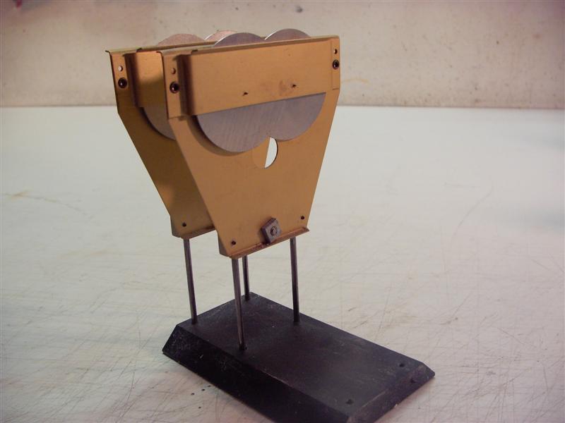

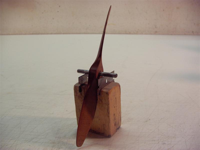

Aw Heck-----I am beginning to feel a little insecure bout my balancer

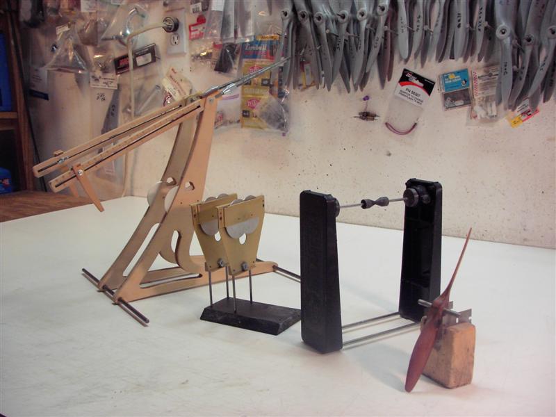

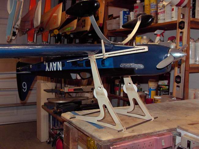

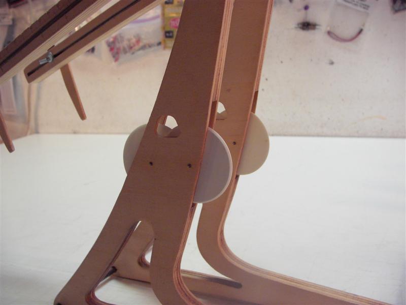

Me Too, I do not normally balance propellors on the majority of my aircraft unless it is called for by excessive vibration. I do however for some of my higher performance or competition airplanes and a few of the bigger ones.
My first post was somewhat 'tougue in cheek' but I Have somehow hung on to the little razor blade in a balsa block balance widget well a long time.
I do have others including the magnetic, The Sig CG, prop balance kit was interesting that I put together when I was recuperating from some medical problems and it was a pleasant diversion that I could do in bed and a building board. it does use the wheel type and works well but with some difficulty due to the clutter of the airplane balance device portion.
In the Picture second from the left is a wheel type that I have no clue as to its origin since it came with a 'buy out' and the one that I use the most when I choose to balance a prop since its quick and easy on a shelf. Anyone know what it is?
John

Your balancer in question is the same one I have. Mine is 20 years old, I thought it was the original Top Flight balancer but I could be wrong. I use mine on every propellor I buy. You can turn the legs over on one side to make a tall and short side and hang large props off the end. The spindle goes through the hole and rides on the bottom of the wheels on the tall side.

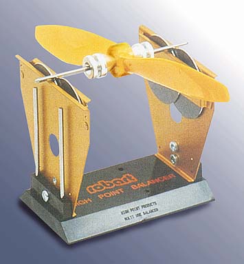

That second from the left is the Robart. You're talking about the gold anodized one, right? It should say Robart on the base but looks like it's been sanded off. The wheels are on I think 1/32" wire axles.
CafeenMan has it exactly right! I had forgotten about that balancer...
Name:	Robart high point balancer.jpg

Hmm went out and double checked Yes it is exactly like the picture AMA, There was a sticker on the top of the base but gone long ago, but there is tiny embossed lettering I can see in your picture that says " High Poinrt Products" second line "Multi use balancer"..
Thanks AMA amd Cafeen, Hey Pylon never thought about using on a slant now ain.t that interesting.

I never thought of it either. The instructions that came with mine showed how to do it. If you look at your photo they are both tall, and the photo AMA posted they are both short. If you go 1 of each, the top wheels line up with the bottom of the other wheels. Then you hang large props over the edge of your bench. Works great.

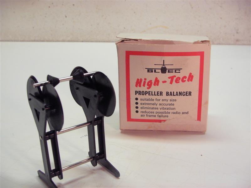

I attended a nearby clubs swap meet event a week ago and picked up this little guy for a buck and one I have not seen before, makes a nice addition to my little museum
John
Name:	prop balancer vintage.JPG
