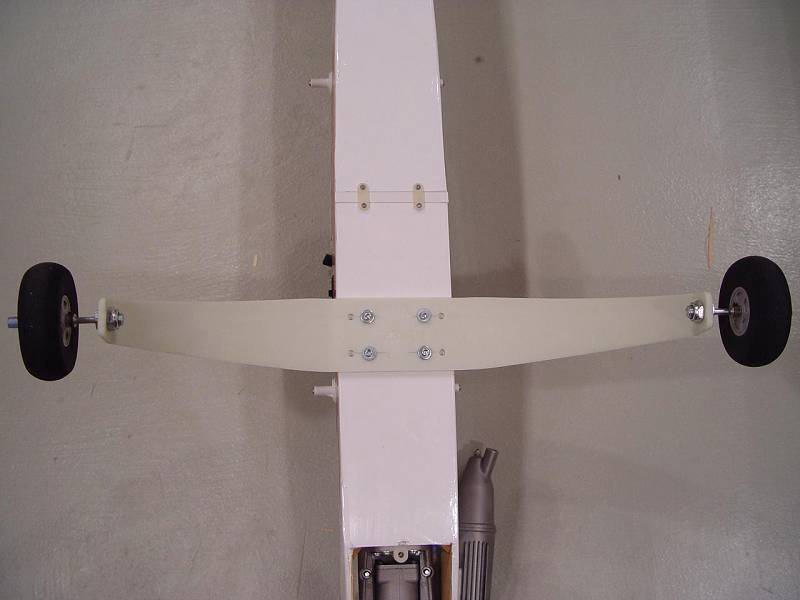

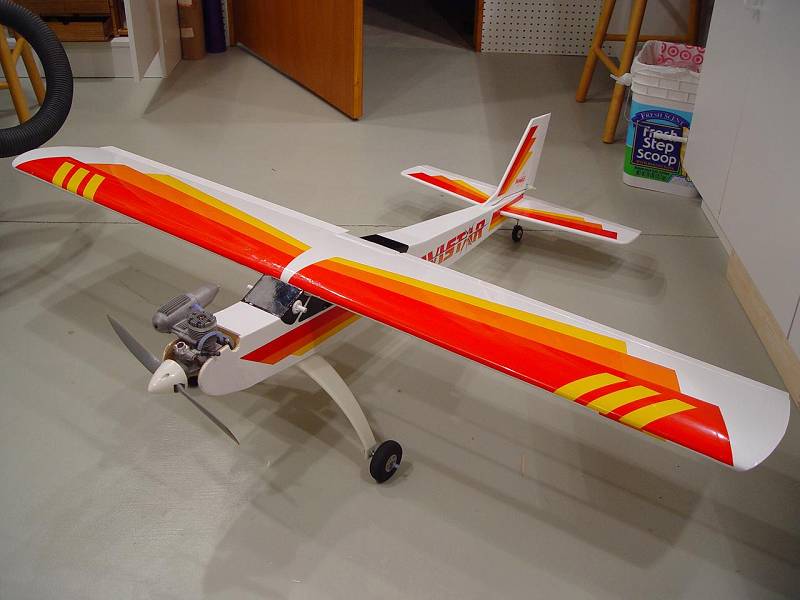

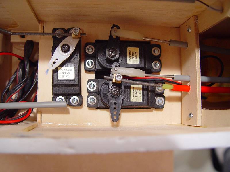

Yep - it's very do-able and IMO makes it more enjoyable to fly. The only real challenge is getting linkage run for a steerable tail wheel. There's a solid former just ahead of the vertical stab that obstructs a straight control rod. But sharpening a piece of brass tubing and drilling from the rear gets around that. Before removing the tubing, insert a control rod through the tube. Then pull the tube and slide an outer ny-rod housing over the control rod and back through the holes. Then you can connect tail wheel linkage to the rudder servo. The main gear just requires a plywood doubler on the floor of the fuse.

Maybe pics will help...
I epoxied the main gear support plate to the floor, sides, and former. The tail wheel is operated by a control rod directly from the rudder servo. That way I didn't have to mess with trying to connect it to the rudder through the elevator.
I also removed the dihedral from the wing, but that's a whole different story...
