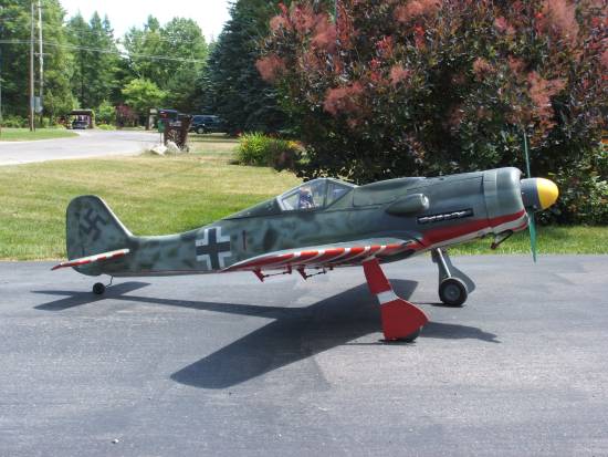

I spilled raw gas on Krylon Satin and had to repaint. I wiped the airframe immediately. I was very disappointed in the product.
On the other hand, my Focke Wulf was clear coated in Krylon Satin. I was careful not to let raw gas get on the finish. No problems were encountered.
There are better products though, like the clear from Nelson's. http://www.nelsonhobby.com/hobby_paint.php
