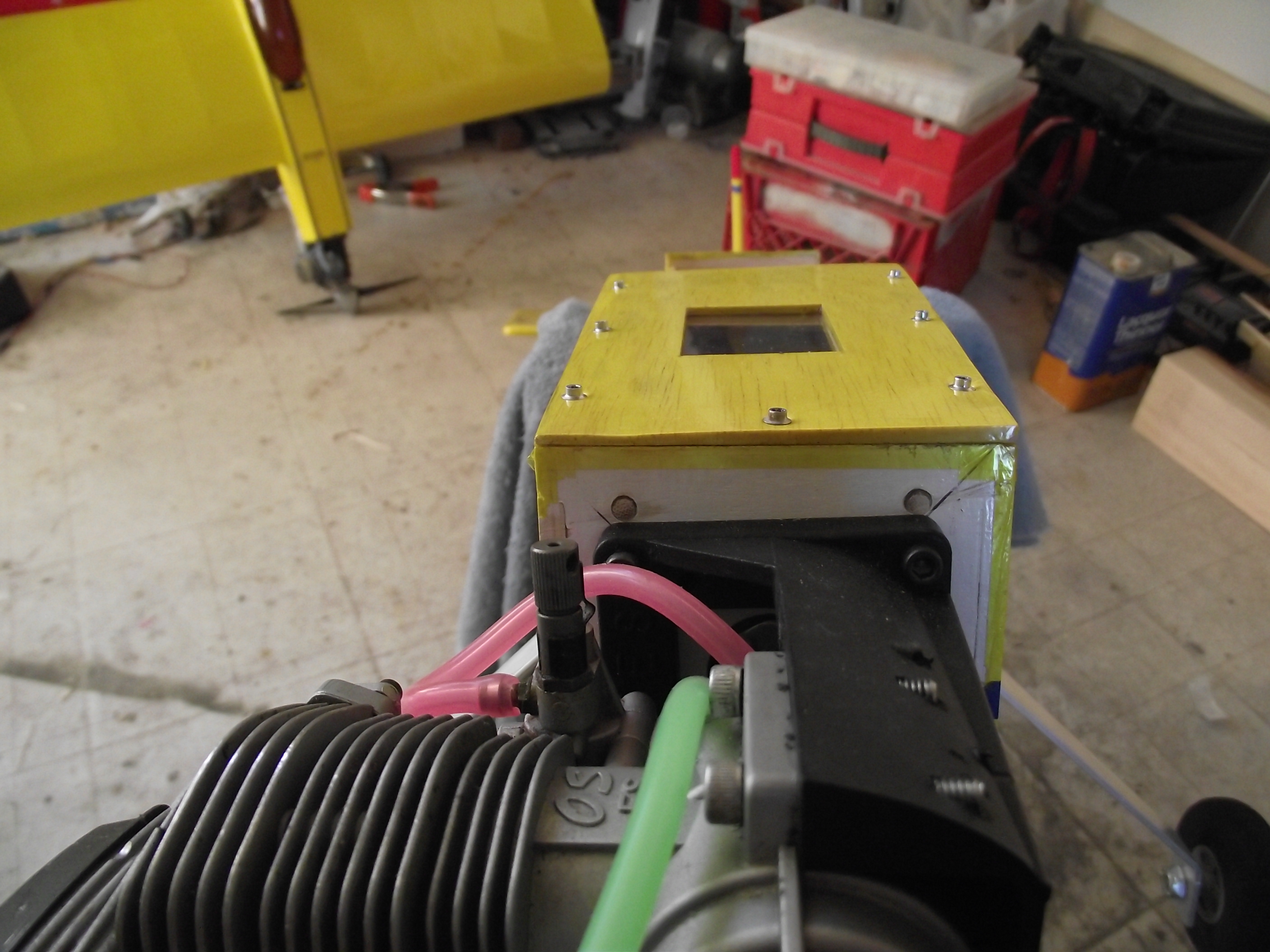

Originally Posted by AllModesR/C
Actual engine mount. There was a different engine mounted and now I need to put a different engine in and the holes don't align.
Then you move the engine to a new spot to miss the old holes. I have never filled a hole in a mount. If it's that bad a new mount cost about 5 bucks.

Right, that is what I was thinking. But AllModes is just referring to the mount. Best to just replace a mount if the holes are wrong.

I'm afraid the engine mount rails can't be replaced as they are an integral part of the fuselage.
I could move the engine far forward but I'm afraid it would make the plane too nose heavy? Any ideas? This by the way is an old 40 trainer I picked up for next to nothing since I wanted to put my Thunder Tiger GP42 engine into something. So far it's coming along well just need to get the engine installed.

Ah yes, "a picture is worth a thousand words"! What you have there is an intergeral wooden beam type engine mount. I am sure most, including me, thought you had a more common fiberglass reinforced nylon type mount. Follow Gray Beards advice given in post #248. The wooden dowel trick will work for these beam mounts too. Redrill the holes as needed so the dowels inserts have a nice fit and epoxy them in. Make the tops of the repair inserts flush with the top of the beams. Locate and drill new holes for the new engine and install it.

AM, you really need to start doing a bit of thinking if you plan on staying in the hobby. Did you even notice the lead weight in the nose of your plane?? Put your thinking cap on, what does that tell you to do?? Just from the photo I can see the rails are wood, doesn't that give you any food for thought.
Look at the first photo of the fire wall, it's made of wood like your rails. Think about it. I took a bunch of photos of a set up I'm doing right now. I first read up on this plane, it comes out nose heavy so I installed the elevator servo and control rod in the back as far as I could. Then I installed the rudder servo right in front of the stab and installed a pull/pull control system. The only servo located where the ARF manufacture had a tray is the throttle servo. I studied then assembled and thought ahead.
The nose of your plane is just wood, something done all the time is cutting the cheeks off the nose so the fire wall is flush and using a normal motor mount like a GP adjustable.
No, if the mount has been used before you don't toss it, you can relocate the holes for another engine. The mount I'm using has been drilled three times. Do a bit of thinking and the answers to your problems will come to you. Think out of the box a little, it's your plane, you can do anything to it you like. That's what I was told.

Two other tips: don't make the repair dowel O.D. any larger than needed, use the smallest O.D. that will fill the holes, and don't forget to fuel proof any exposed wood in the repair area.

Yes I realize the plane is naturally tail heavy. I also think if I position the engine far forward it might actually be too much nose weight. Now explain the wood rails part as that does not give me much "food for thought" other than perhaps that's the reason the front end is lighter. But I'm not sure. You have to forgive me for being a clueless newbie and asking questions.

Yeah, I would just fill the holes with a dowel and epoxy, let it cure, sand smooth, mark new holes, drill new holes, fuel proof with CA. I really like the TT GP .42, good honest engine.

Thanks everyone. I'll go to Ace today to pick up a couple of dowels. Now as far as drilling the new holes I think I a small Dremel drill works best?

Whatever you can get in there, just enough to clean up the hole but same size as the dowel. I'm guessing 5/32". It might be easier from the bottom. If there are blind nuts, you should try to remove them.

AM, I would use a "normal" twist drill to size the holes for the dowel. I think it will give you a more accurate hole size. Also, what is the airplane you are now asking questions about? It seems you have brought a fourth different model into the mix without telling us. That's how the confusion over what type of engine mount it was that needed to be redone occurred. I'am going to guess that this one is a Goldberg Eagle 63 trainer. No matter, for general background information, this type of wooden beam engine mount was a very common "old school" method of engine installation going back to when all models were kit built, ARFs didn't exist yet. Some kits and even some ARFs still use this type mount, but the separate fiberglass/nylon type is much more common today. Both work well. IMHO, in this case it will be less work to dowel repair this mount than to cut off the cheeks and beam mounts and then install the newer type. A fiberglass/nylon mount will require removing the fuel tank (you probably should anyway) and installing blind nuts on the backside of the firewall for the mounting machine screws. Not a big deal as you have a removable fuel tank access hatch. You also loose the look of the side cowl cheeks if that matters to you. Pick your "poison"!

Why would you think that??? If you want to buy a moto tool then by all means, they are really handy but a drill is usually your best choice for drilling holes. The moto tool is limited to the bit size. I stock dowels in as many sizes as the hardware stocks plus I have a bag of Kabob sticks in different sizes. These sticks have often come in handy for making push rods and used for taking engines apart for a rebuild.

Because I never mounted an engine before and imagine in order to get the holes drilled accurately you need to at least start the holes whole holding the engine in place. Therefore a small drill would work best.

Oh boy, no, that's not how to do it. Hold the engine in place and use either a Great Planes Dead Center Engine Mount Hole Locator or a drill bit or or a piece of sharpened piano wire to mark where the holes should be drilled. I've even used masking tape on the engine rails so that I could see the mark that I make while pushing some kind of marker through the engine mount holes. Then come back with a drill and drill those holes as straight as you can get it.

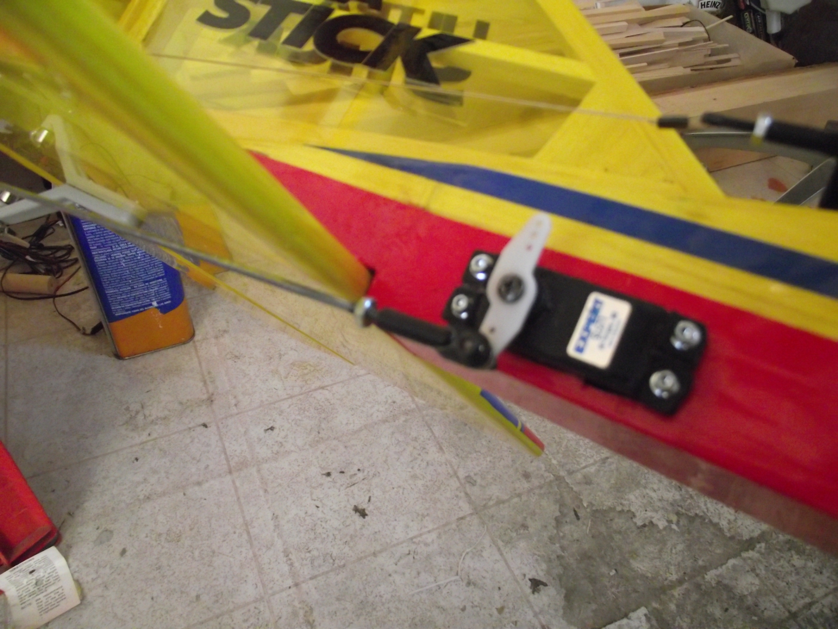

Does anyone knew what size screw Hitec servos use to hold the arm/horn in place? I went to Home Depot to buy some but they don't sell screws that small.
Old 06-07-2015 | 06:27 PM
  #269
JohnBuckner's Avatar
Posts: 10,441
Received 11 Likes on 11 Posts
From: Kingman, AZ
Depends on which servo. Those with plastic output shafts use small metric sheet metal screws. Not very likely you find an exact replacement at the hardware store. The good news is you likely can find a suitable replacement but not exact and the plasrtic will accommodate. take a sample screw to the depot with you.
Now the more expensive and all the Hitec metal gear servos have a metal shaft and it is threaded internally for a very fine metric threated screw These you must use pretty much OEM screws as there is no way Home Depot is going to have them.
Now here agine is a good example of the advantages belonging to your local club as these are likely no problem to find among your clubmates;

You can buy the servo screws from places like Servo City but like John said, most of us that have been in the hobby for any length of time have boxes of them. Seems to me that the digitals have a machined screw and they don't except anything else. My LHS also has servo screws on there shelf direct from Hitec and JR.

There is more than one type of screw depending on what type of servos you have . plastic geared servos have a coarse thread screw almost like a tiny wood screw , while metal gear servos have a screw with machiene threads . You should be able to get replacement screws from a place like Micro Fastners . They have screws down to 0 size and thats small . I remember seeing sombody pointing out the number for the screws that fit the MG servos but I can't remember what it was

I got the engine mounted after filling the old holes with dowels. The holes were 1/8 inch and Ace Hardware had the perfect dowel stick. This is the plane: Hopefully somebody can identify it:
