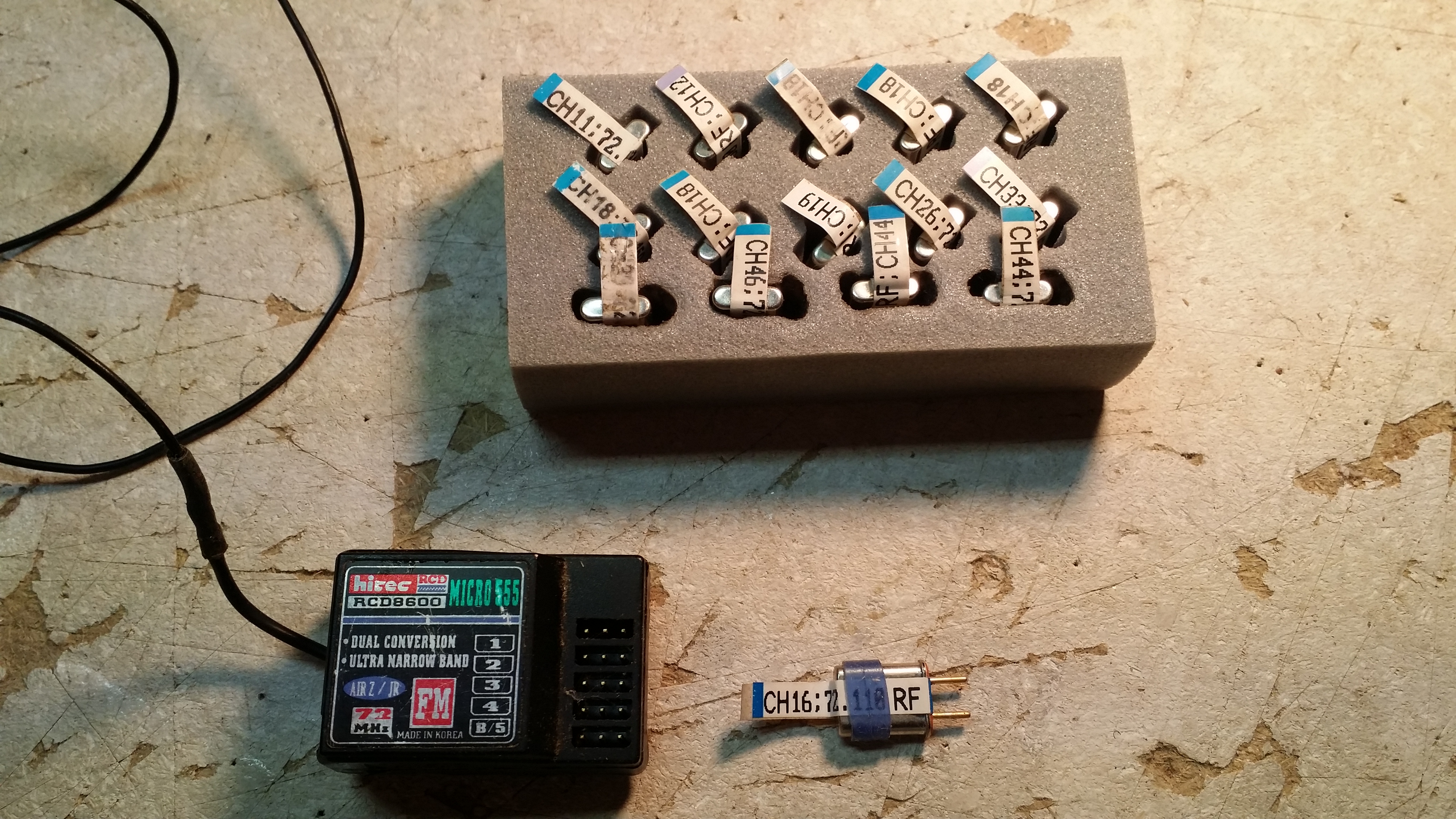

Will this dual conversion receiver work with the Max6 JR single conversion transmitter?

It definitely is a positive shift receiver so yes indeed it will work with your positive shift transmitter.
Now understand that you must use a Hitec dual conversion crystal in the receiver that is the same frequency as your transmitter.

Conversion type used in the receiver has nothing to do with the transmitter. Dude look closely at that Receiver in the add and in very small print you will see like magic on a hitec receiver label it says "for JR or Airtronics" Agine you must use a Hitec dual conversion receiver crystal in that receiver that is the same frequency as your transmitter.
I have used for years in the past that same receiver with several models of the JR transmitter including my ancient JR 10SX And I have used and still have numerous examples of that exact Hitec Electron 6 for JR & Airtronics. A very good receiver by the way.
So the answer is still Yes

Thanks for the vote of confidence JP. shd here is a photo of the Hitec dual conversion receiver crystals and what they look like. If they are dual conversion they all will have that pull tab with the blue stripe across them and a channel number right on that tab. If they have a green stripe that means they are Hitec single conversion crystals and will not work in the dual conversion electron six.
As to where to get them is a different matter as the older stuff is disappearing rapidly and I checked at Tower and Servo city with no joy. All tower had was single conversion green stripe crystals. So finding a Blue stripe Hitec crystal with your channel number will be the challenge.
John
